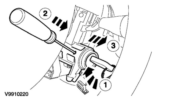

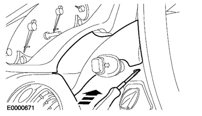

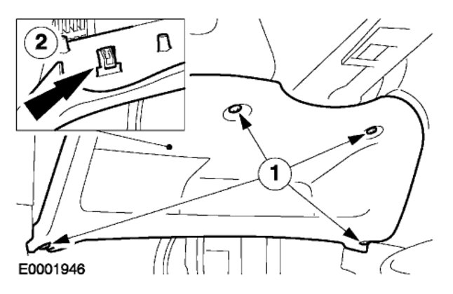

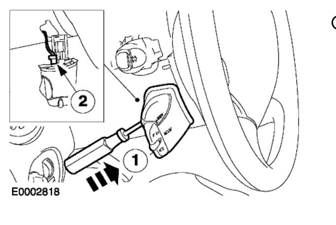

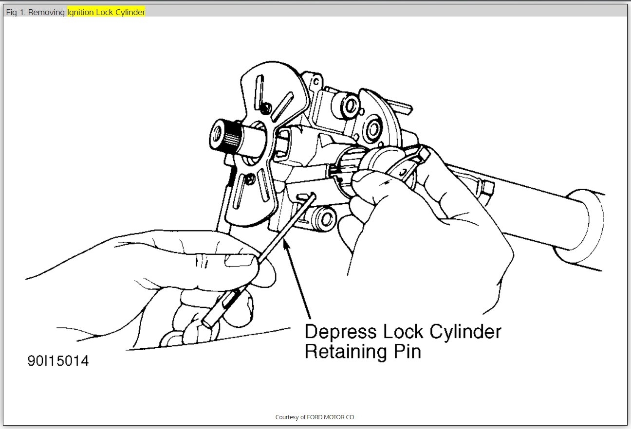

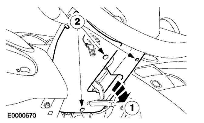

I removed the key switch to change it. now the switch goes in but will not lock in place and steering wheel will not lock.
Jun 25, 2017 at 11:15 AM
It sounds like you got something in misalignment. Remove the tumbler and see if you can tell what it is, here are some diagrams to help you get the problem fixed
