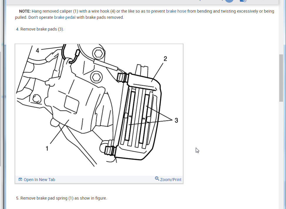

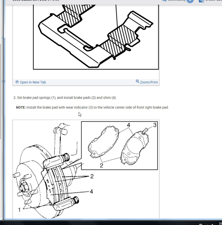

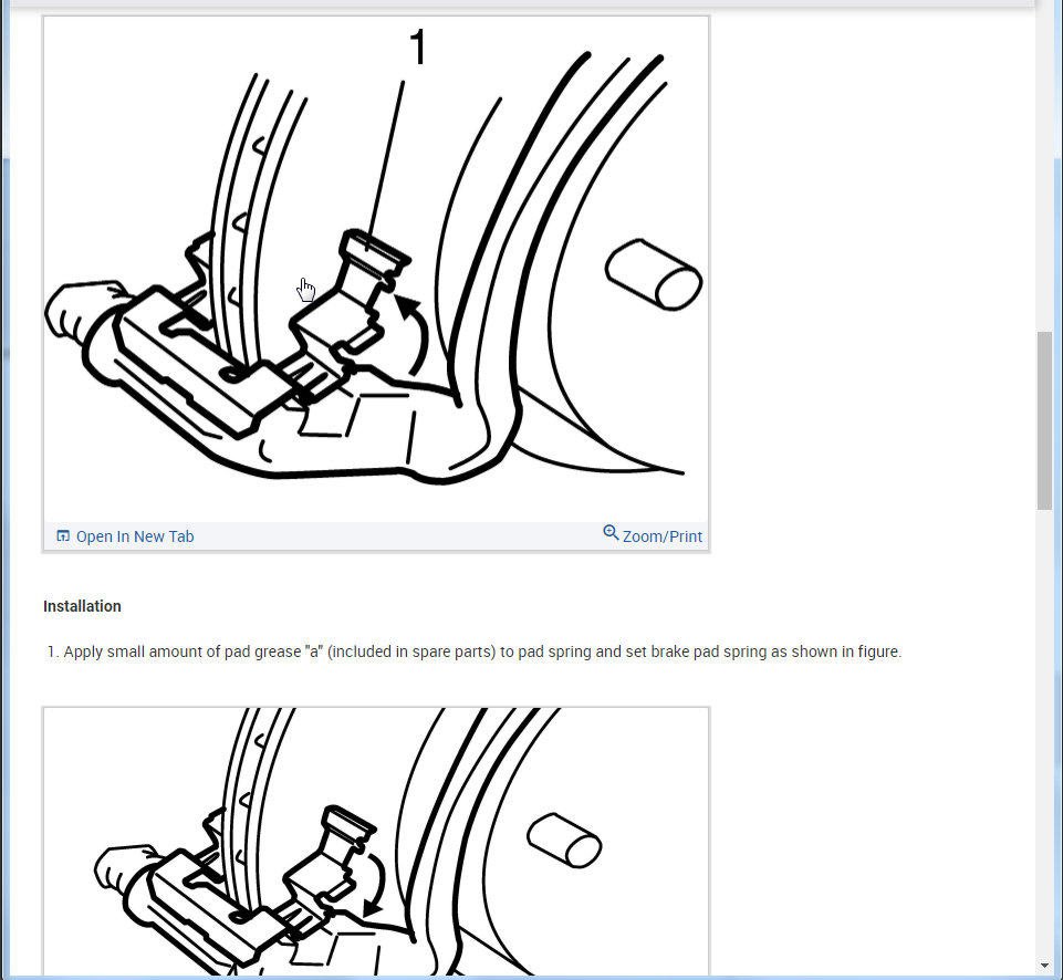

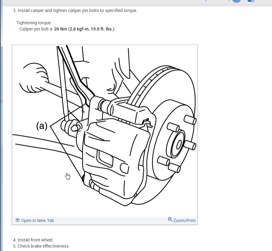

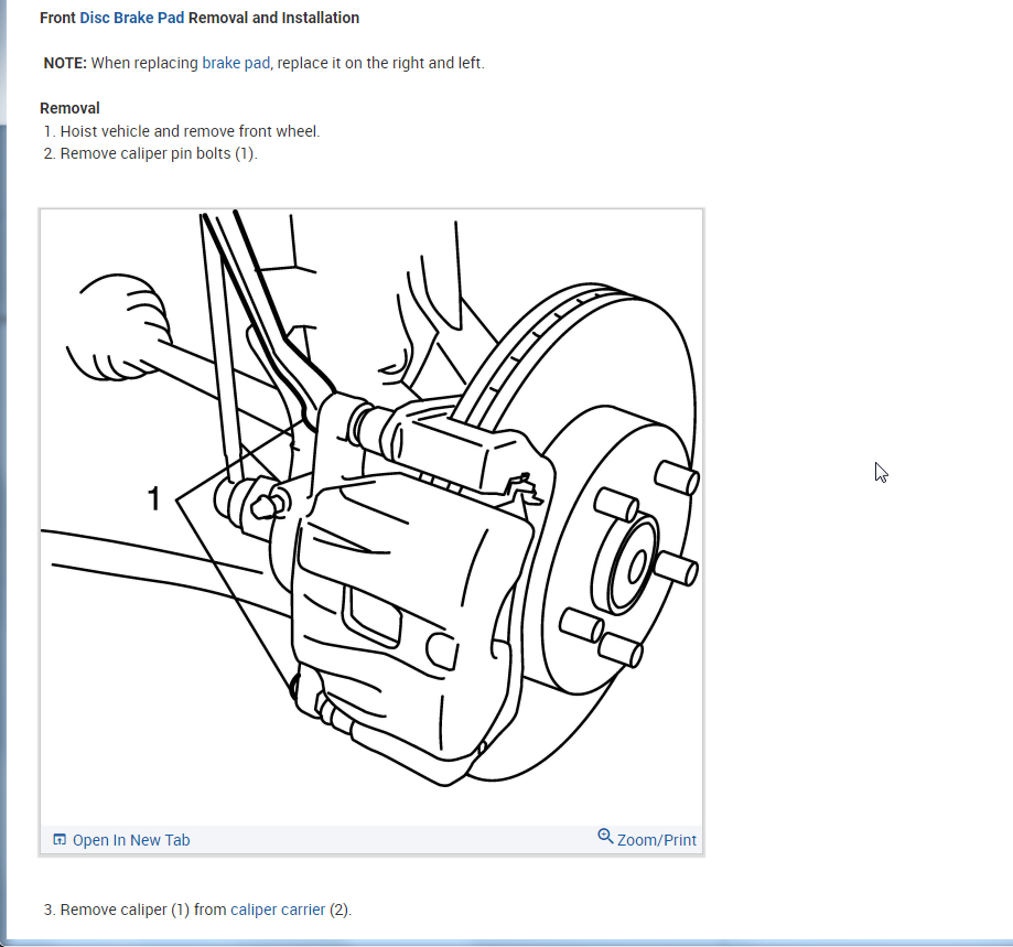

Here is a guide that will help with replacing the front brakes:
Below is the process from the manual on how to replace the brakes. Let us know if you have other questions. Thanks
