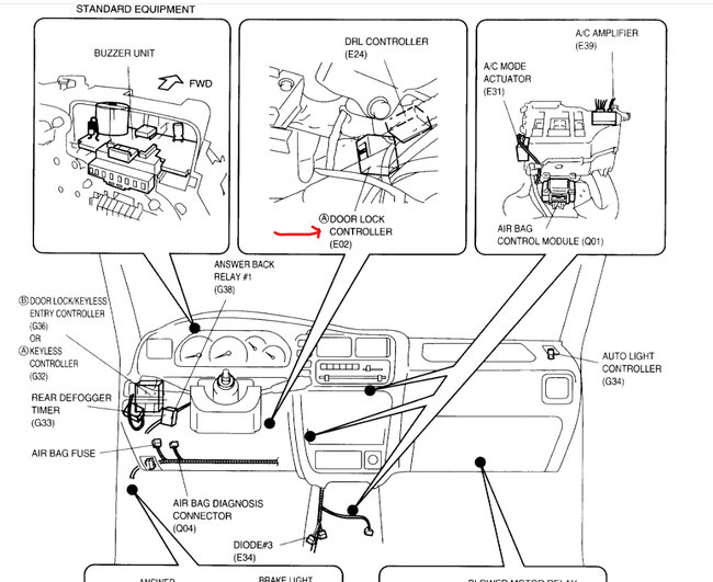

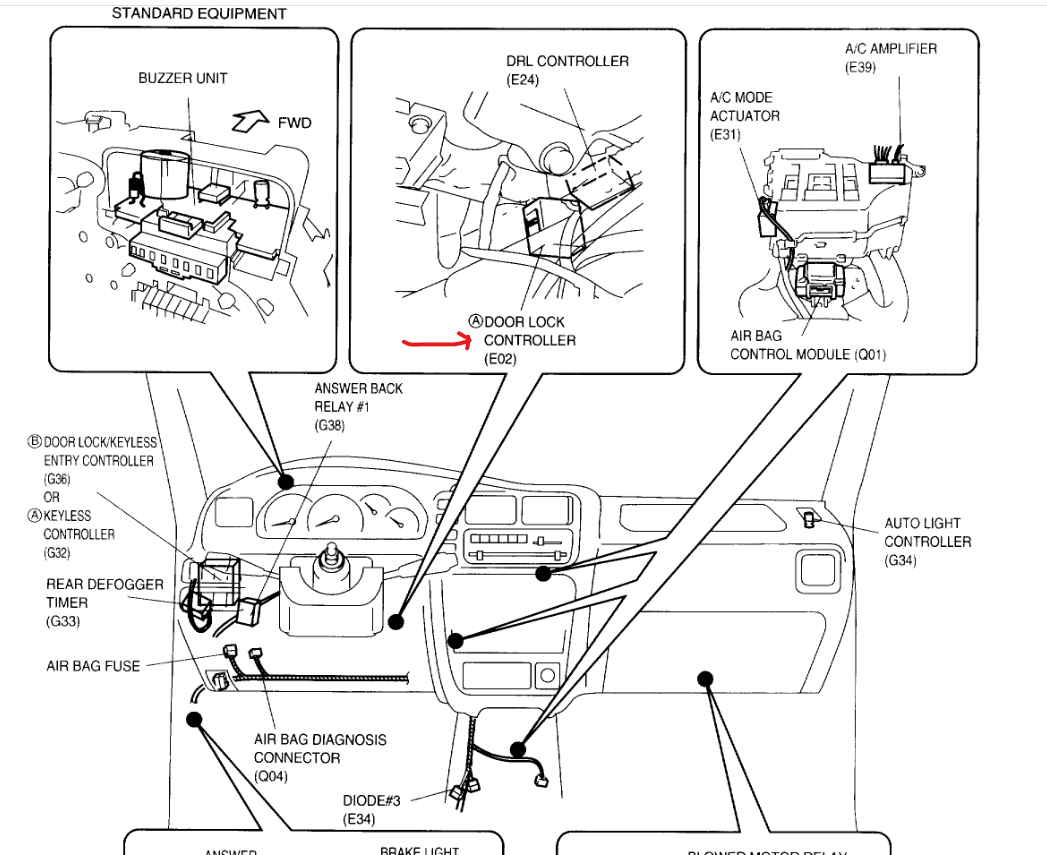

This happens when the door lock controller goes out, here is the location so you can change it out to help fix the problem. Check out the images (below). Let us know how it goes.
