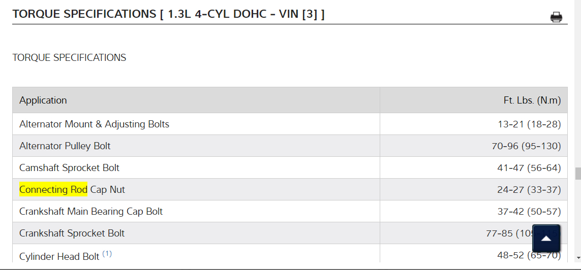

What the torque specs for a g16a cylinder head bolts, main bearings and connecting rod?

Both of my reference materials do not show a 1994 Suzuki Swift with a 1.6L engine just a 1.3L engine with either a single overhead camshaft or dual overhead camshafts. Can you please verify your vehicle's engine size for us?

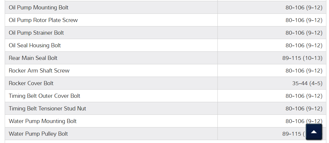

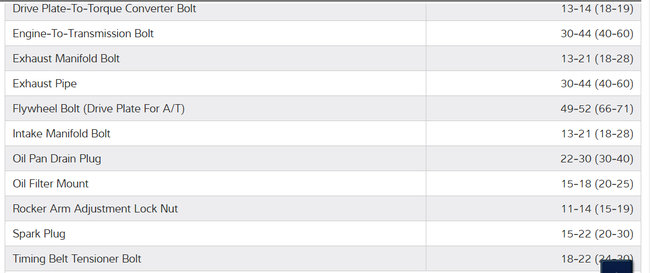

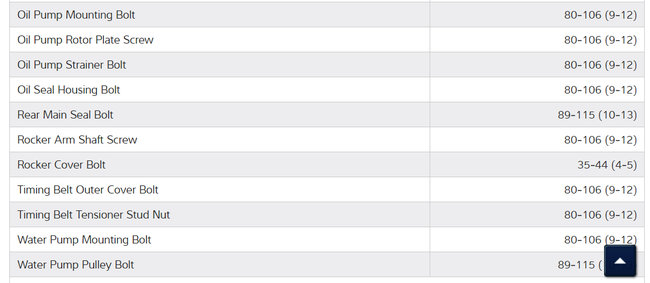

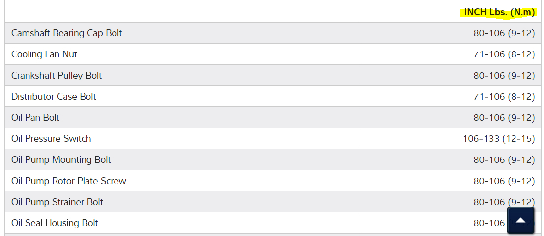

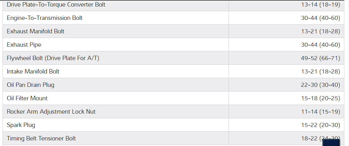

Hello again,
I have included the information that you requested in the diagrams down below. I have included the torque specs for your entire vehicle and I hope this helps. Please, feel free to ask, should you have an additional questions.

Thanks very much.. I will ask for any additional information I may need.
