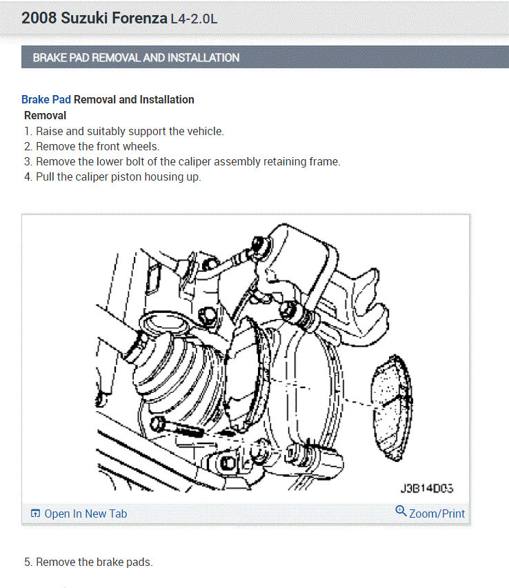

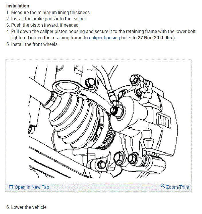

To get you started, here is a link that shows in general how it is done. You can use this to help guide you in the process.

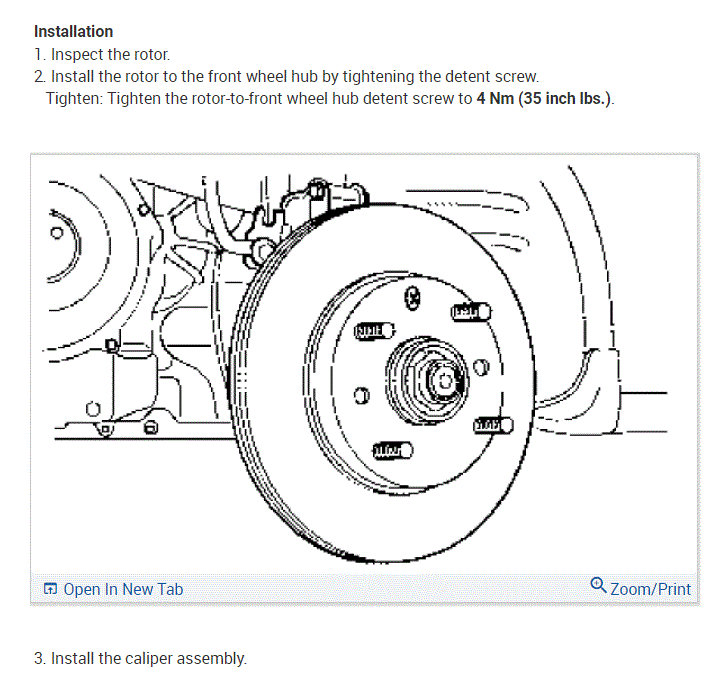

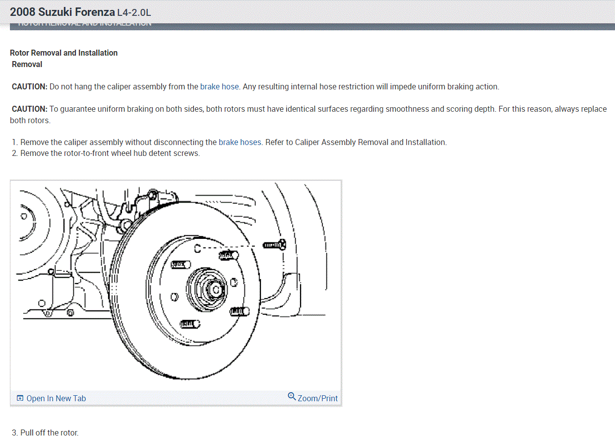

If you look at the attachments below, they include the directions and pics specific to your vehicle for replacement.
Note: The manual's description of rotor removal is vague. What to do is this. While the brake caliper is removed for pad replacement, you will need to remove the caliper mount. The mount is bolted on the rear of the spindle assembly with two bolts. Remove the bolts, remove the bracket, and then you will be able to remove the rotor.

See pics below.
