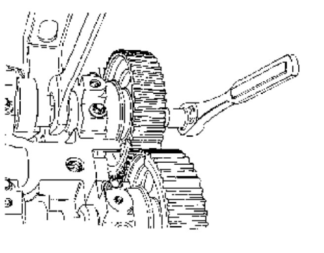

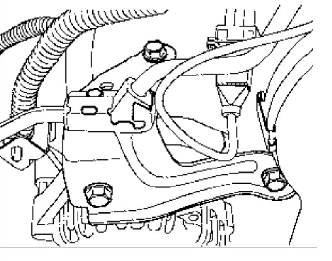

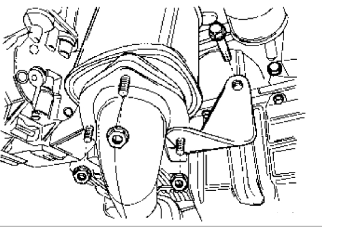

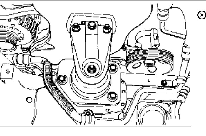

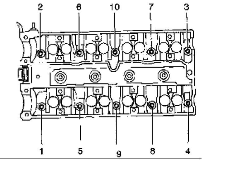

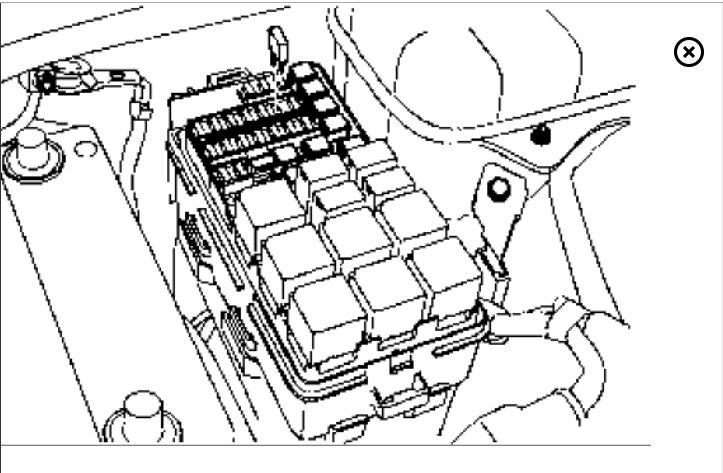

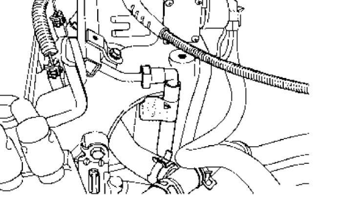

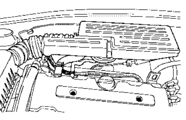

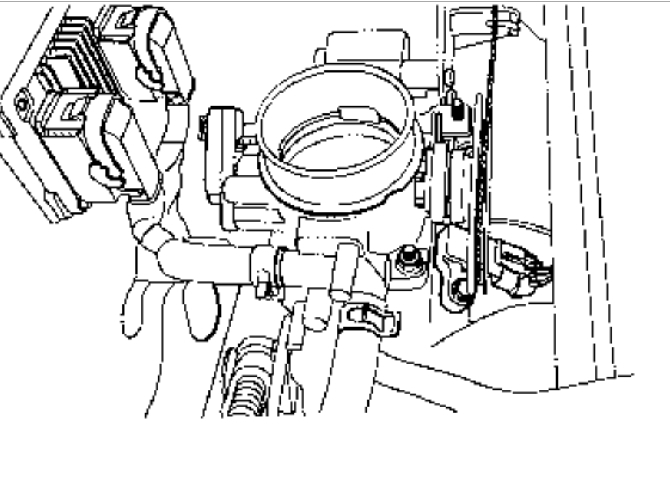

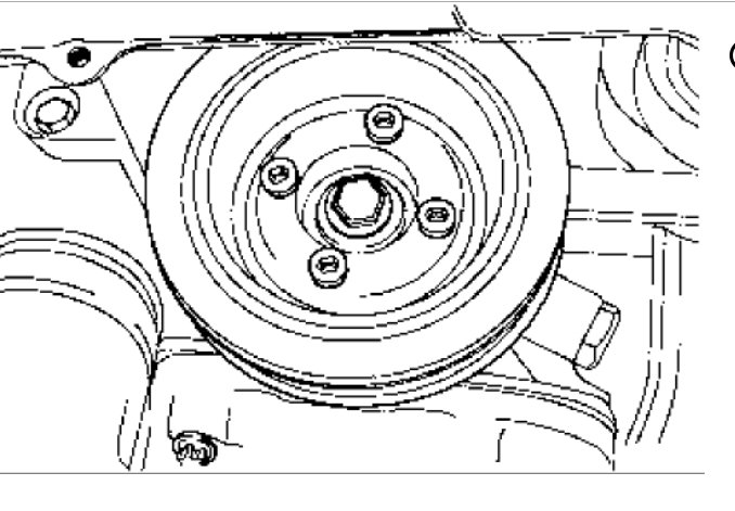

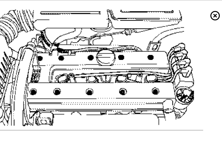

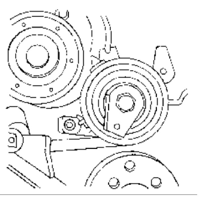

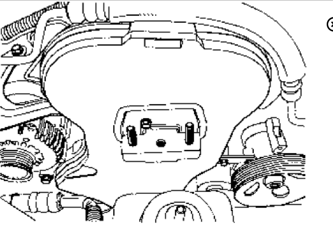

Here are the head bolt tightening instructions and some diagrams of the job being done (below). Start by disconnecting the battery.
Tighten the cylinder head bolts gradually and in the sequence shown. Tighten: Tighten the cylinder head bolts to 25 Nm (18 ft. lbs.) and turn the bolts another 3 turns of 90° using the angular torque gauge KM-470-B.
Camshaft bearing cap bolts tighten to 71 INCH Lbs. (8 N.M)
