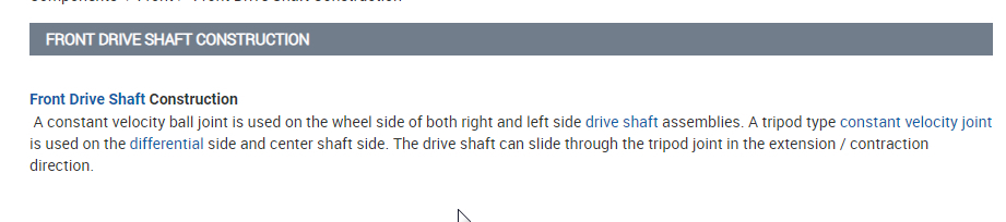

Are you having issues with a joint? If so, can you explain to me what is happening? The most common indication of a bad joint is a clicking sound when turning sharp. Here is a link that explains how the joint works:
https://www.2carpros.com/articles/how-a-cv-joint-works
