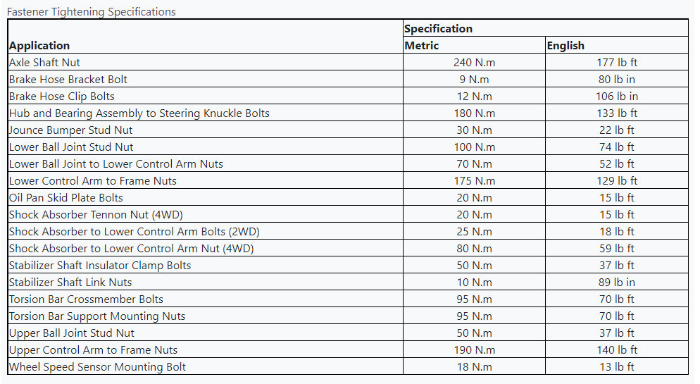

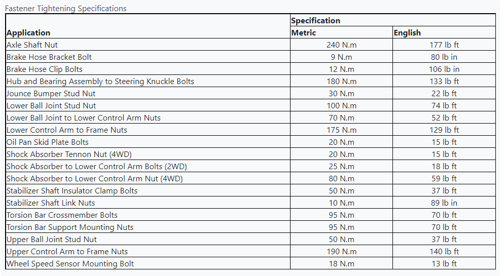

I just picked up the truck listed above 1500 RWD and I am replacing the front upper and lower control arm bushings, ball joints, tie rod ends, shocks, and springs. I am hoping that you can provide the torque specs for the front-end suspension. I did a search for the specs on the site here but did not find any information for the 2005 RWD model. Though that is not saying much, I'm not the greatest on computers. Anyways, thank you for your time on this. Your help is always much appreciated.
