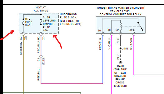

Yep, I have been around and around with this before and it always ends with the OEM shocks to fix it. But lets try doing a scan to see if that shows us anything, here is a video to help.
CAN SCAN - https://youtu.be/u-4syLc-ifQ
There are three fuses you need to check as well, here is a video to help with that as well. I posted the fuses and there locations in the images below.
https://www.youtube.com/watch?v=G-xNK79Wa-w
