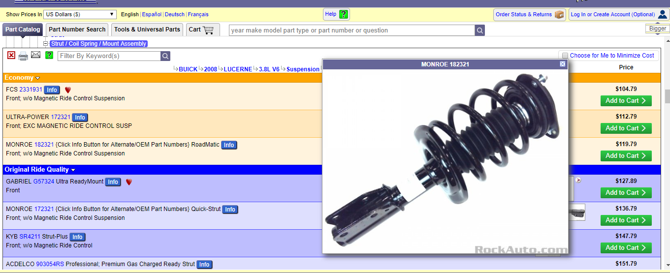

It would make better sense to replace the entire unit. They call it a quick strut that contains everything.
The tire should never rub the tire unless something is broken.
I attached pictures and the parts from rock auto for you to view

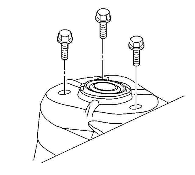

Strut Assembly Replacement
Removal Procedure
Notice: Use care when handling the coil springs in order to avoid chipping or scratching the coating. Damage to the coating will result in premature failure of the coil springs.
1. Remove the strut mount retaining bolts.

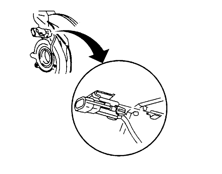

4. Disconnect the ABS front wheel speed sensor harness connector.
5. If applicable, remove the speed sensor bracket from the strut.

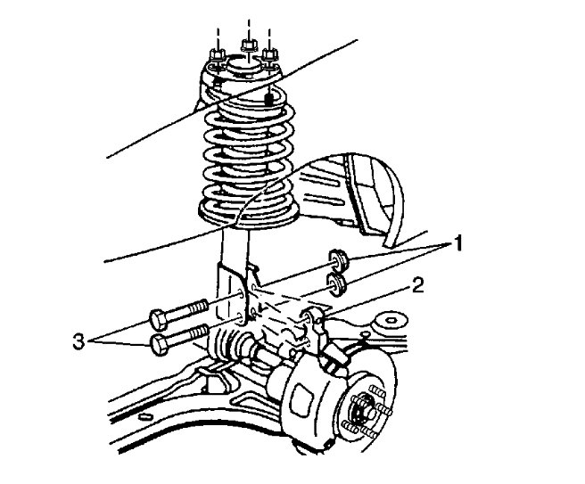

7. Remove the strut to knuckle bolts (3) and the nuts (1).
8. Remove the strut from the vehicle.

Okay, so will the quick strut have mount coil attached as well? because I believe that it was the main reason due to rust that it started to collapse. What other parts would you suggest that I will need in order to have it installed?
May 3, 2019 at 4:22 AM
Yes, it is a complete assembly. You just remove one and install one.
