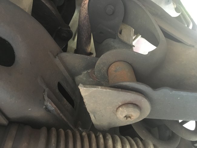

Okay, so I am trying to find where to buy the lower control arm mounts for my Durango because the snapped on one side. Anyone knows if they are available at stores or do I have to take it to a metal shop for them to make new ones? Answers will be greatly appreciated.

You would probably be better off just taking it to a welding shop or a mobile welder to fix. Since it is a clean break it looks that they can just weld back the original. No replacements are made, you would have to go to a wrecking yard to cut out that section to be welded to yours. Hope this helps and thanks for using 2CarPros.
