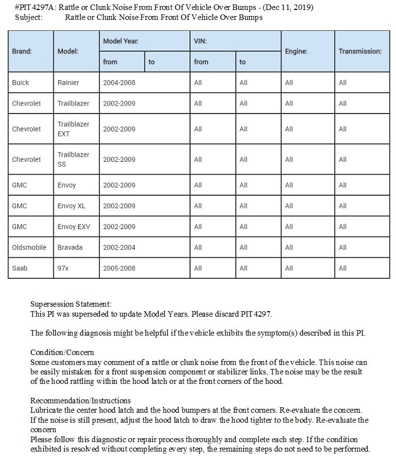

I have two thing to get you started. The first is covered in this service bulletin. It involves rattles caused by the hood. If you can't read it, you can copy and paste it into an MS Word typing program, or I can reformat it into pieces that I can expand for you.
