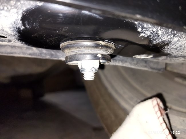

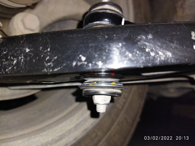

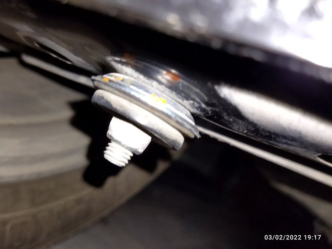

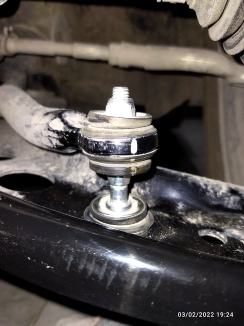

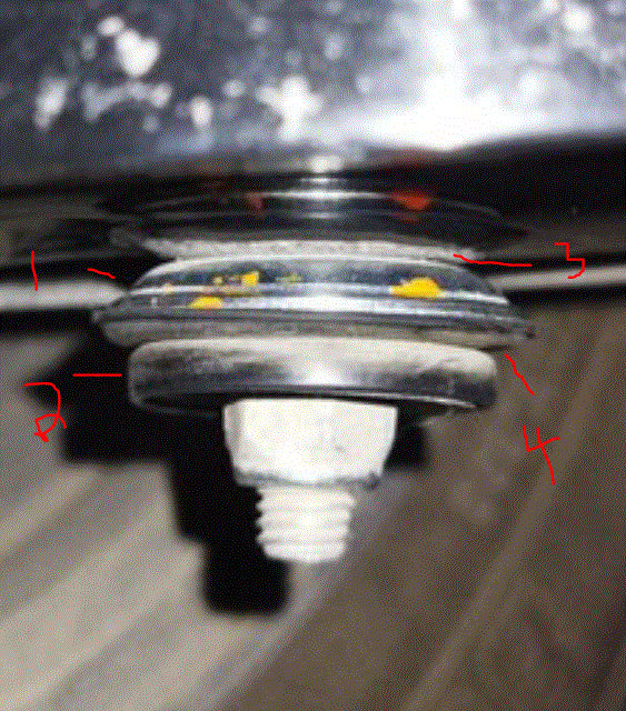

I recently bought the car listed above ATIV 1.5L having CVT transmission. Current ODO reading is 3800 km.
A rubber like squeaking noise is coming from front passenger side when car passed over speed bumps. Short duration sound comes when car rise or lowered from speed bump.
One thing strange for me is that no squeak sound observed on speed bump/rough road for initial 20-30 km drive after that squeak sound starts and become clearer and a bit louder. After 50 km drive squeak sound is observed on every speed bump, un-even roads with large potholes but every time sound comes from front passenger side.
Actually, this sound started after my car's accident. A stray dog hit to front passenger side of my car. Bumper, splash guard sheets and lower control arm were replaced. Toyota mechanic diagnosed that dog hit side wheel also pushed 2 cm backward and lower control arm got bent that's why he replaced it with new OEM Lower control arm.
After replacement of control arm this squeaking sound was observed.
Please help me! what to do further.
