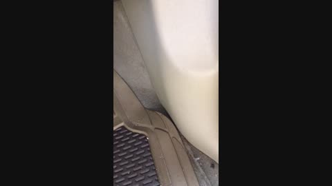

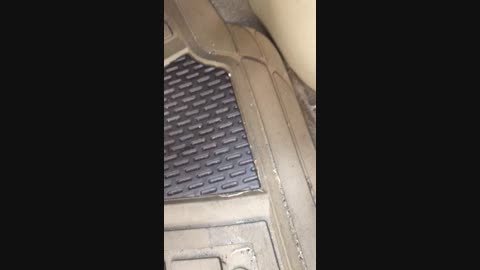

Thanks so much you all for trying to help me with this! Yes, it is a Monroe Quick Strut. I took some video but still do not think it truly captures the sound. Please excuse my dirty car.

Quick Strut is a brand name but it also is sort of generic for a complete strut assembly, mount, strut and spring all in one bolt in unit. The noise is a bit hard to hear, it sort of sounds like a strut bearing but hard to say for 100%. Can you get a helper for a few minutes, preferably someone large who can push down on the car so it can rebound like you hit a big bump? If so put your hand on the top of the strut mount and have them give it a good bounce. If it is the bearing you will feel the strut stud sort of snap up and down as the bearing moves in the mount.

Let us know what they say seems strange they can figure it out. Thanks for the video pretty pronounced. It kind of sounds like the "oil can" effect which is metal flexing back and forth. It sure sounds like a strut to me. Please get back to us.
