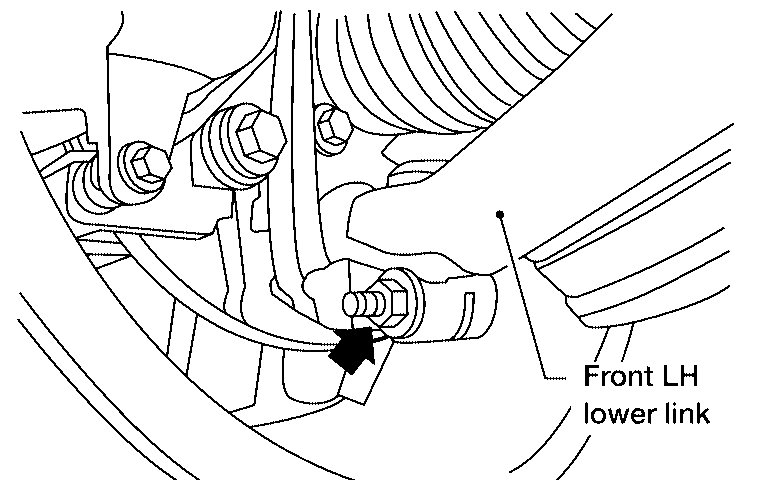

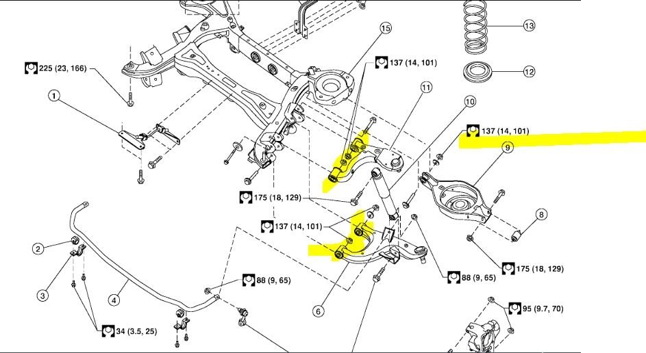

I attached a picture below and highlighted the bushings I am referring to. Check their condition and check for play.

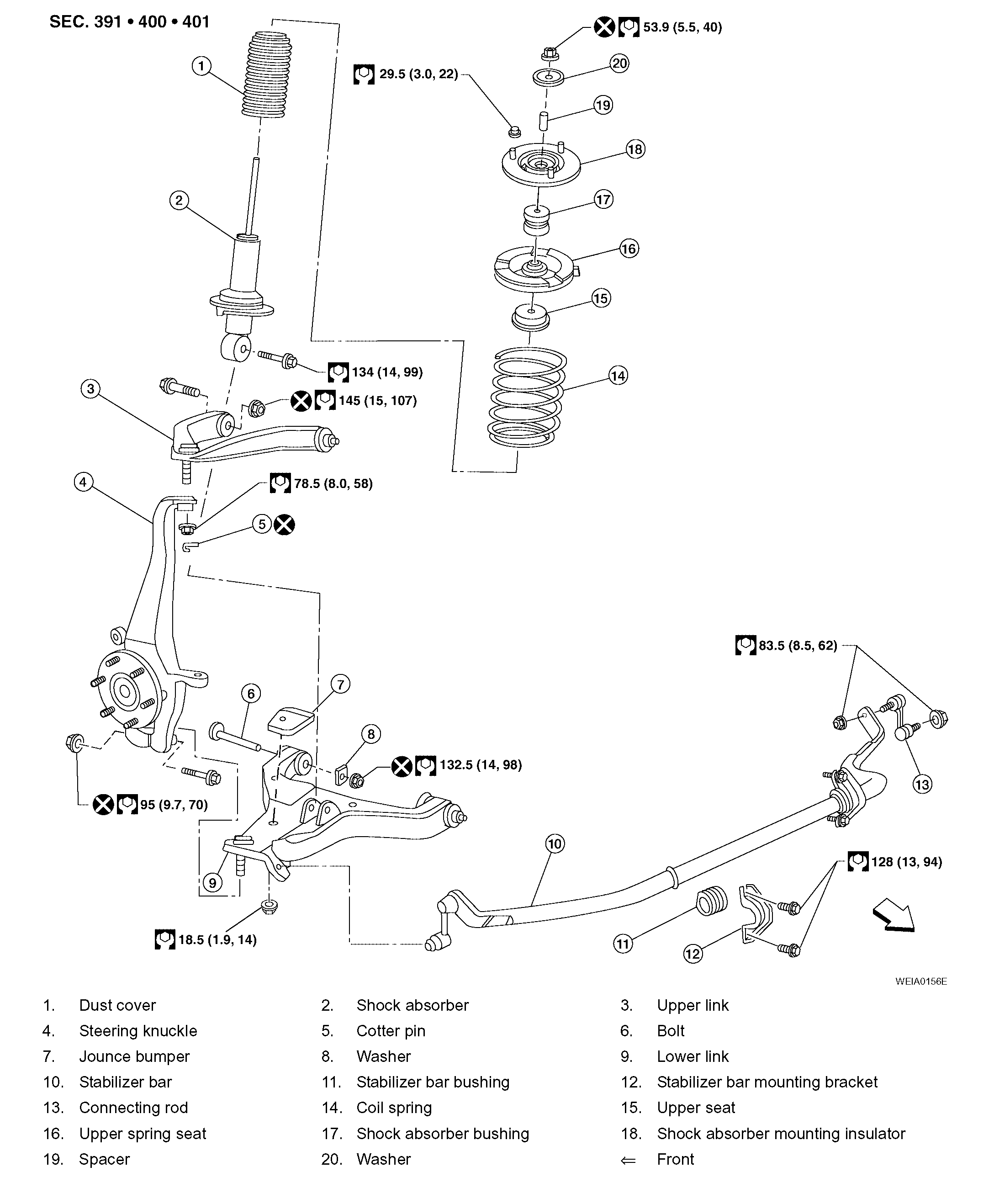

Here are the directions for replacing the upper. The attached pics correlate with the directions.
Upper Link
Vehicle Steering and Suspension Suspension Control Arm Service and Repair Procedures Front Suspension Upper Link
UPPER LINK
Components
Pic 1

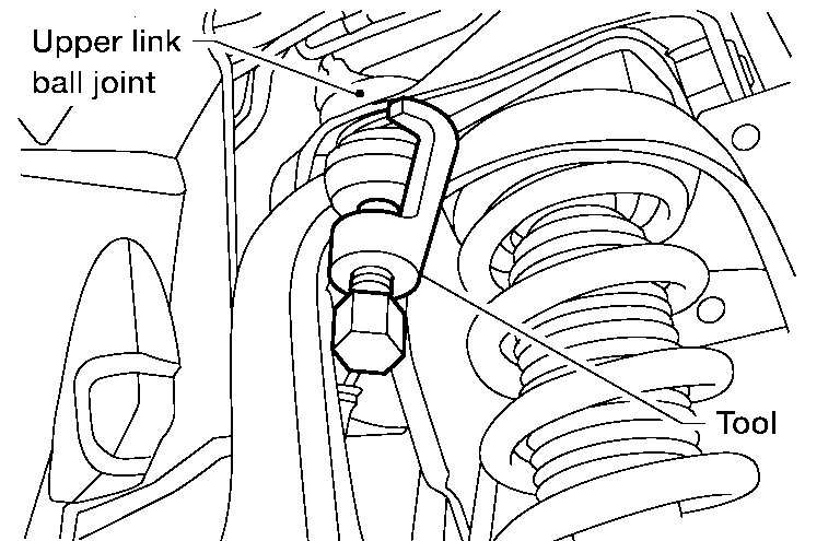

3. Remove cotter pin and nut from upper link ball joint and discard the cotter pin.
pic 2
4. Separate upper link ball joint stud from steering knuckle using Tool.

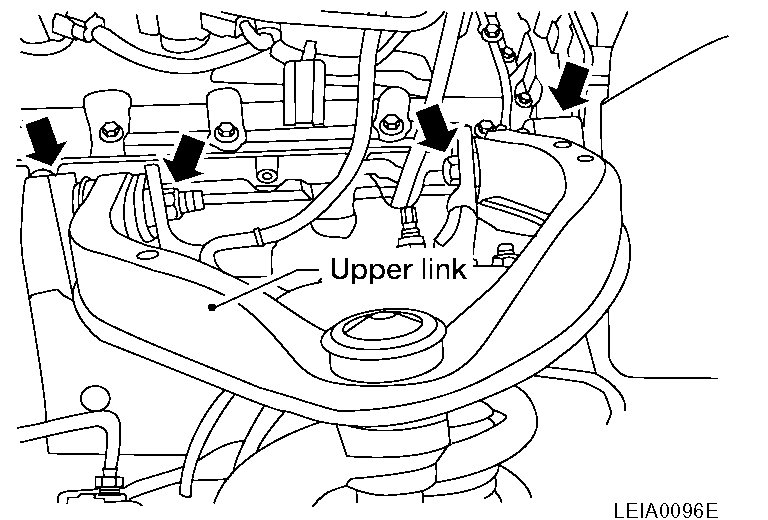

5. Remove upper link bolts and nuts, then remove upper link.

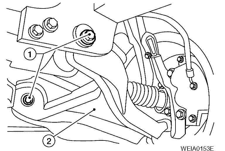

5. Remove pinch bolt from steering knuckle using power tool, then separate lower link ball joint from steering knuckle.

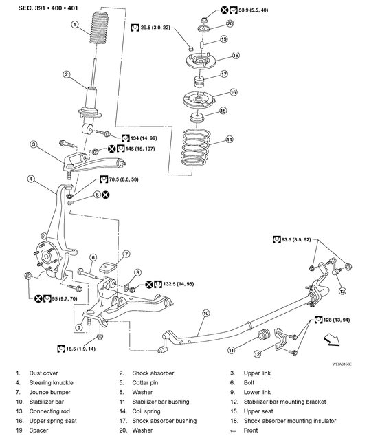

6. Remove lower link cam bolts (1) and nuts, then the lower link (2).
NOTE: Some vehicles may be equipped with straight (non-adjustable) lover link bolts and washers. In order to adjust camber and caster on these vehicles, first replace the lower link bolts and washers with adjustable (cam) bolts and washers.

Let me know if this helps. Also, the vehicle will need an alignment when this is done. There are eccentric bolts on the lower arm. You can mark them to get it close when you put it back together, but it really should be aligned.
