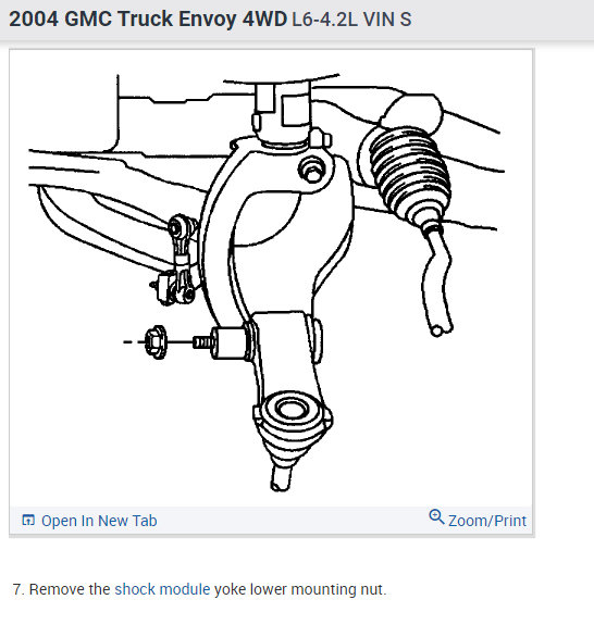

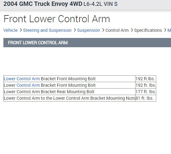

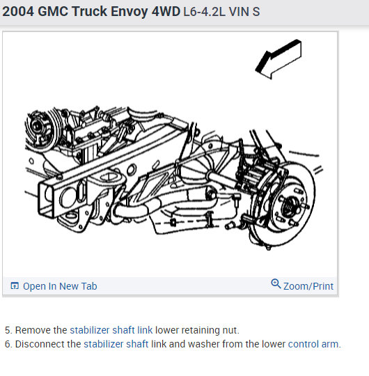

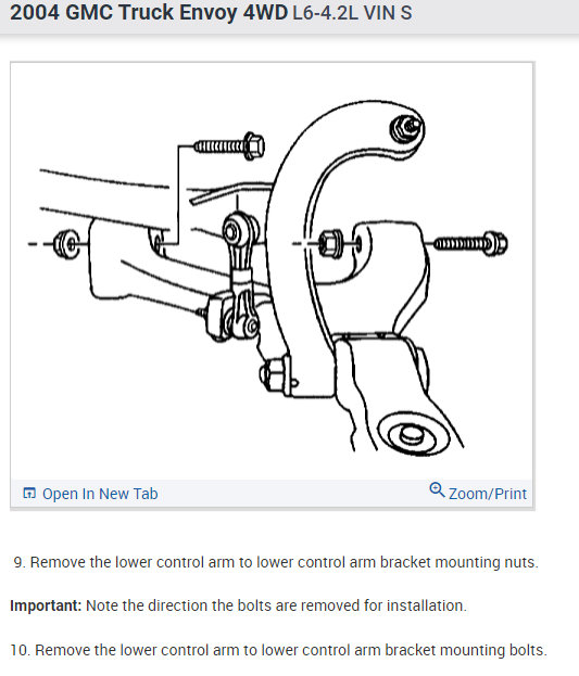

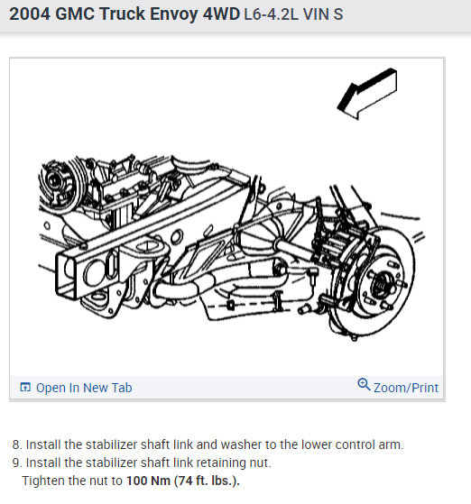

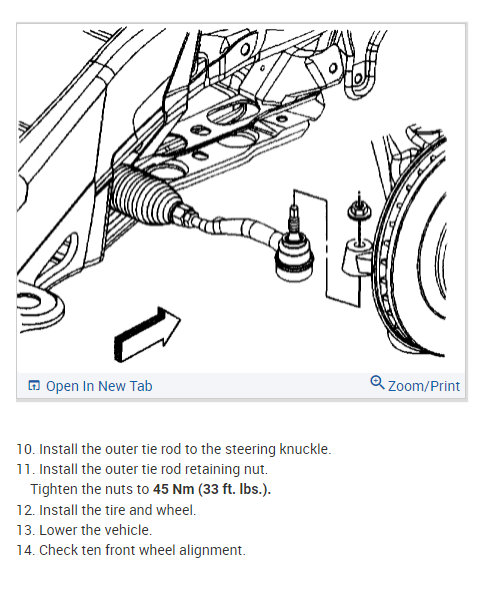

I probably need to change my lower control arm or if the lower ball joint is still in good condition, I will change just the bushings. Would you have the torque specs for this task? I want to make sure I do everything to specs. Thanks ahead of time.
