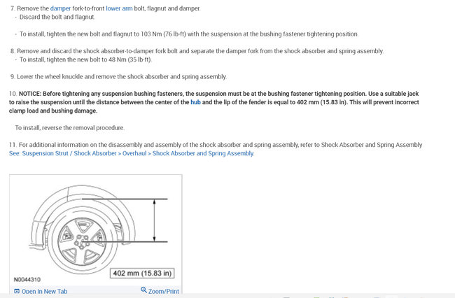

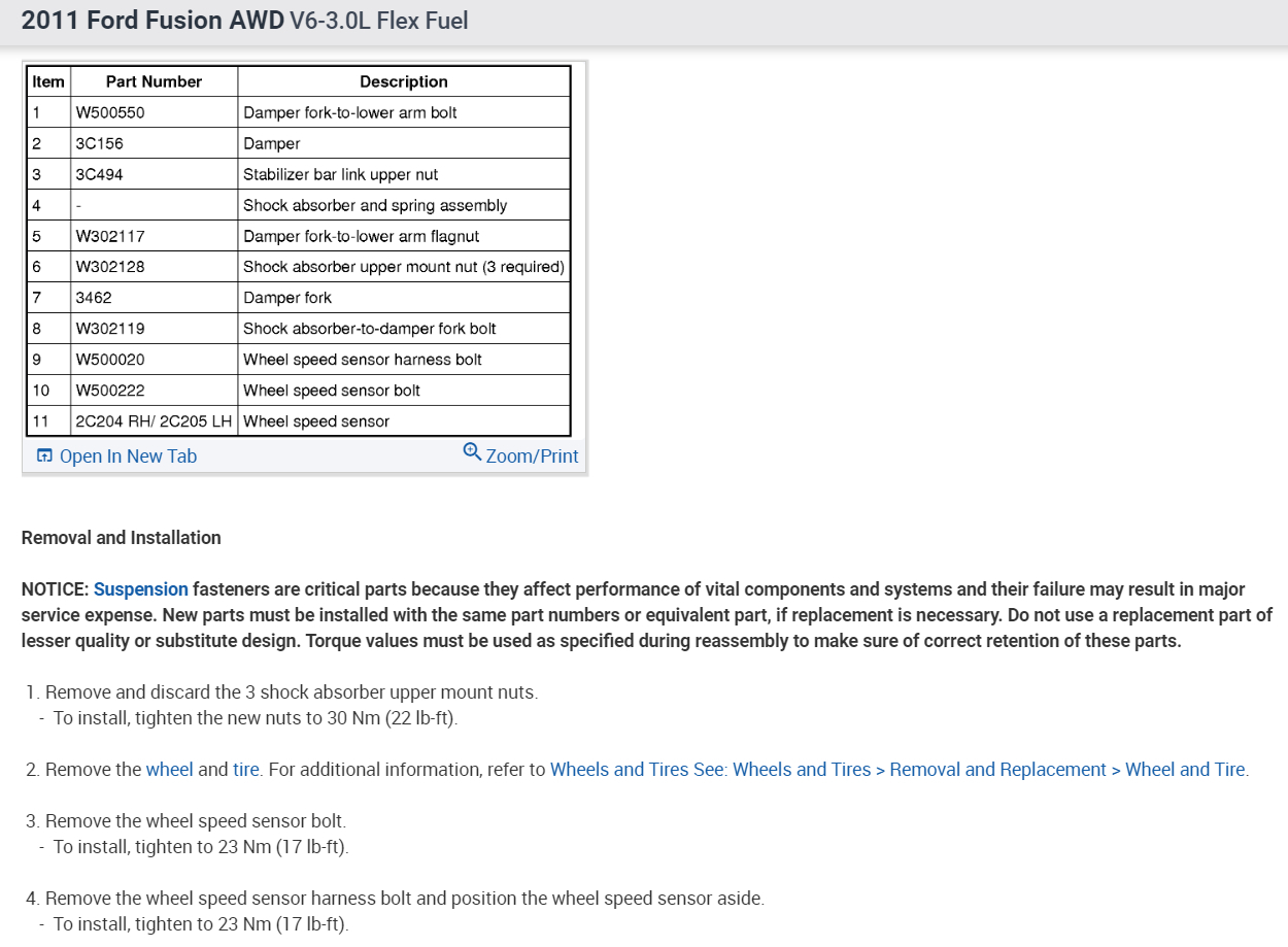

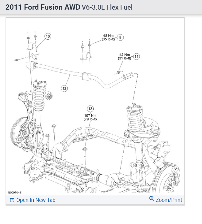

Have a suspension noise going on, front end crunching/creaking kind of noise. Started last summer, went away during winter, but back again. At first only kind of did it while turning at parking lot speeds, now does it nonstop turning or not at parking lot speeds, also at 40-50 I can kind of hear it now too. weird because it only seems to do it when hot out. Also seems only when the car is driving, kind of why it's been hard for me to figure it out. I don't have much knowledge on suspension and I don't trust shops around my area as they've lied multiple times previously. I can't afford that again. Any help figuring this out would be much appreciated.
