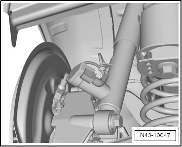

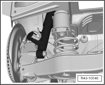

- Disconnect the connector and remove the wire from the shock absorber
pic 1

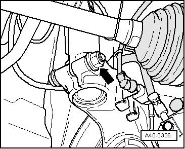

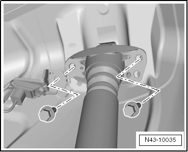

- Remove the shock absorber bolts.
pic 2

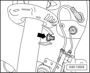

- Remove bolt - arrow -.
pic 3

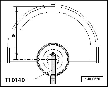

The bolted connections of the shock absorber to the wheel bearing housing must only be fastened when the dimension "a" is achieved! Refer to => [ Tightening of the respective bolts/nuts must then only occur after dimension between the wheel hub center and the lower edge of wheel housing has been attained. ] See: Suspension > Components > Rear Axle, Lifting to Curb Weight Position.

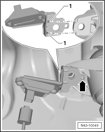

- Mount the rear body acceleration sensor on the shock absorber mount
pic 5
- Mount the retainer on the shock absorber mount from the rear, so that the retainer tabs - 1 - fit into the depressions on the shock absorber mount.
- Turn the retainer forward so that it contact the shock absorber mount.
The tab - arrow - is used for adjusting the rear body acceleration sensor retainer.

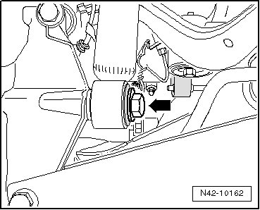

- Tighten the bolt - arrow -.

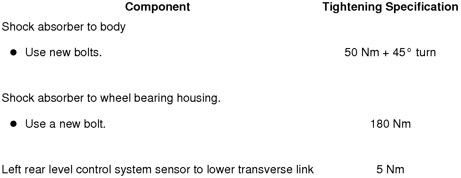

Tightening Specifications
pic 7

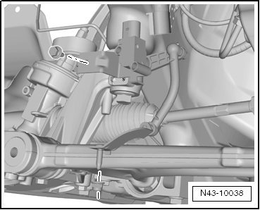

- Remove the level control system sensor from the control arm.

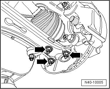

- Remove the nuts - arrows -.
pic 10
- Remove both the wheel bearing housing and ball joint from the control arm.

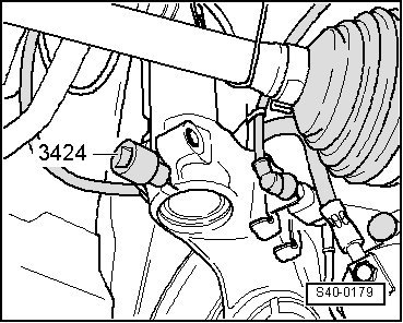

- Insert Spreader Tool Tool (3424) into slot of wheel bearing housing.
pic 13
- Using a ratchet and the Spreader Tool Tool (3424) , open the wheel bearing housing slot.

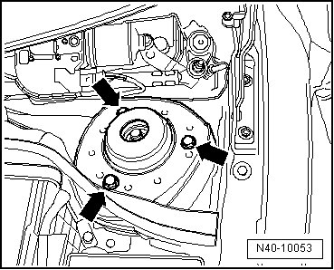

- Remove the bolts - arrows - for upper strut mount and remove suspension strut.
pic 14

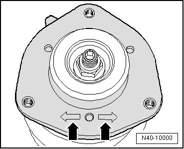

One of two markings - arrows - on spring plate must point in direction of travel.

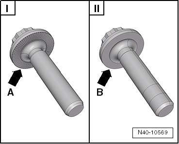

Differences Between a Twelve-Point Bolt with Ribs and a Twelve-Point Bolt without Ribs
pic 20
The contact surfaces - arrow A - and - arrow B - are different on the two-point bolts.
I Twelve-point bolt with ribs - arrow A -
II Twelve-point bolt without ribs - arrow B -

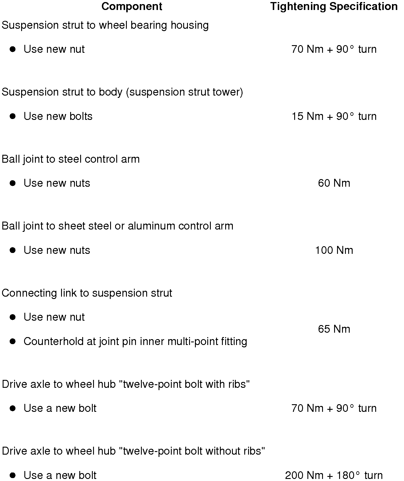

pic 21
