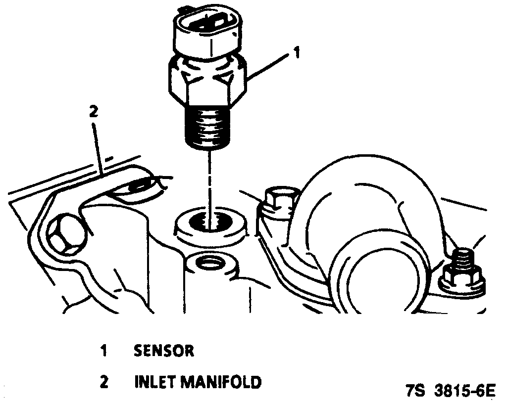

Hello and welcome to 2CarPros. Being a 1995 you cannot easily scan it for codes, however I would suspect a faulty coolant temperature sensor or the wiring to it being it isn't a constant problem. Your vehicle uses two sensors, one goes to the ECM and the other to the gauge in the dash.
GM # 15326386 is the ECM sensor. It screws into the intake manifold next to the thermostat housing. A trick to changing it out without draining the coolant is to have a cold engine. Start removing the sensor until it is almost fully out. Now squeeze the top radiator hose hard. Release it and as soon as you do remove the sensor and screw the new one in, if needed a helper on the hose can make it much easier. Squeezing then releasing the hose will create a small vacuum inside the engine for a couple seconds, that is usually enough time to swap the sensor and only get a tiny amount of coolant out of the system.

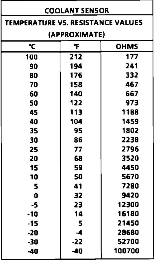

You can test the sensor first if you have a multi-meter. Simply check it's resistance using the table I posted. However, you would need it to be acting up while this happens to be sure it's the part that's failing.

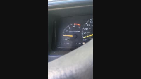

Here is the video of it doing it. I am pressing slightly on the gas.

What other modifications are on the truck? It would have only had one O2 sensor. plus a MAP, throttle position and coolant temperature. Does it idle okay?

Nope just the dual straight pipes. Yes it idles perfectly, good oil pressure, runs good when driving. It’s just does it when I go from a stop to take off.

It looks like the TPS sensor is not working right but to be sure lets run the codes. this guide will help us:
