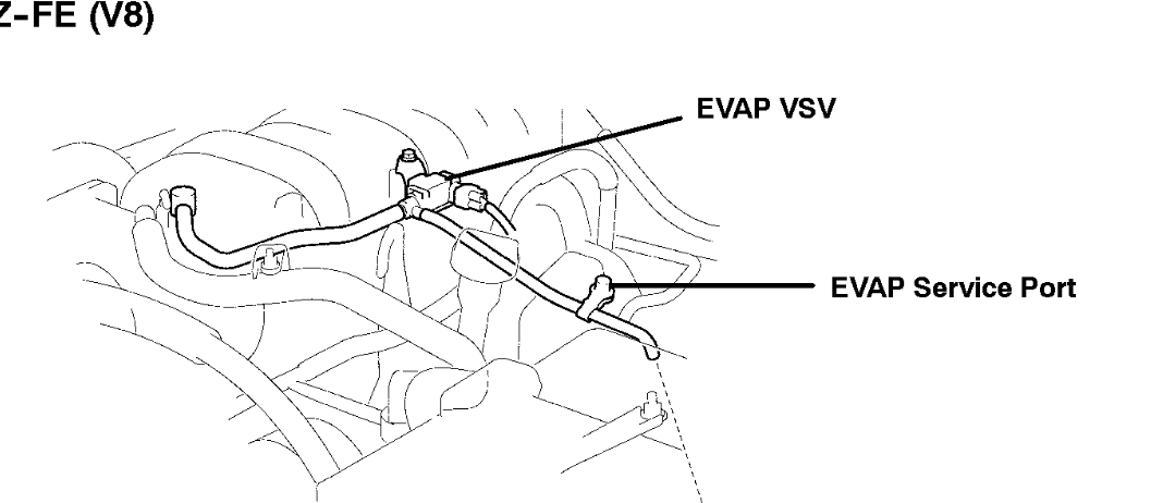

First, I would run the codes, but it sounds like the EVAP purge solenoid is stuck open. Here is the location and if you can blow through it, it is bad and needs to be replaced.
And this guide may help as well:
