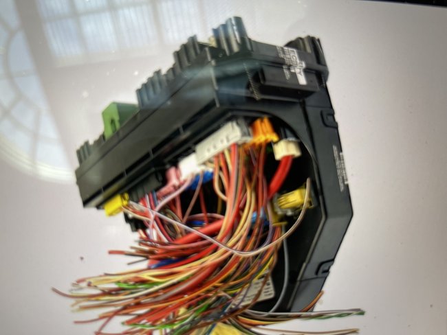

putting back the SAM module but the plastic clip has broken off
2013 MERCEDES BENZ C250
64,000 MILES • 4 CYL • TURBO • 2WD • AUTOMATIC
DIVIDES
  • 903 POSTS

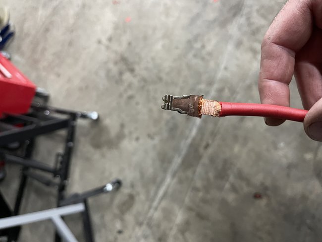

I am putting back the SAM module but the plastic clip that holds the thick red wire, white in the corner, has broken off as it was difficult to remove. now, i can connect the red wire to the flat connector piece that goes deep into the bottom of the SAM module, but i don't want it to come off loose. Can i use super glue on it and then insert it and hold it util it's in space and not moving? Second pic shows the wire which goes in.
May 27, 2022 at 4:26 PM
You can get a replacement connector and use a splice to fix it. I don't think glue will work because engine and road vibrations will make it come loose. You will need to get the pigtail from the dealer. Let me know how it goes.
