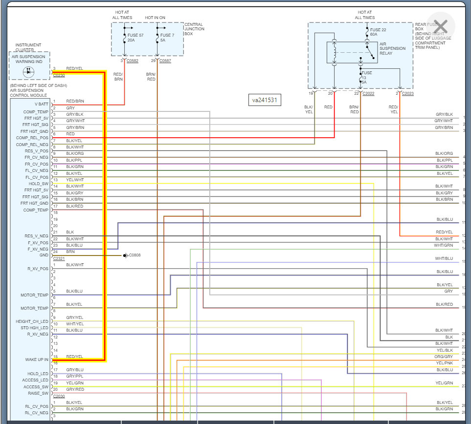

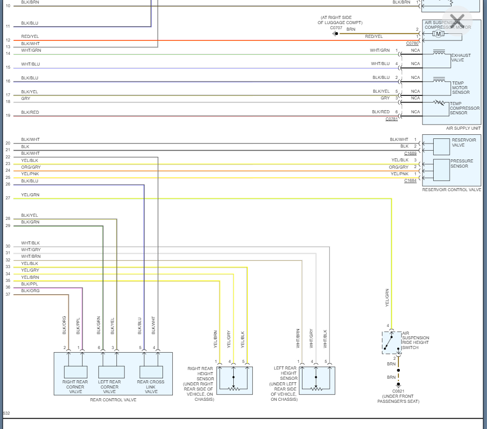

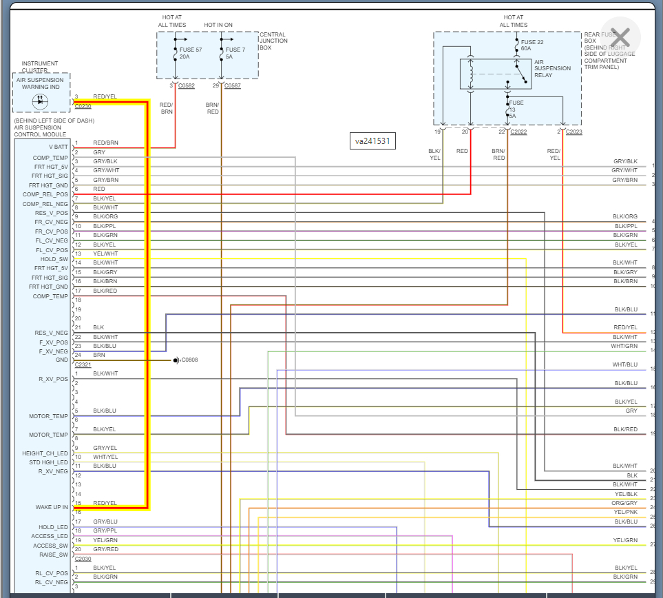

I had to convert to spring suspension. repair shop couldn't fix air. Now I have a dinging and suspension fault waring on dash. How do I disable the warning and or the dinging? 2006 is the only year that they don't require a separate module for this. There's a way to do it without a module but I can't find it anywhere. Can the ECU for the suspension be removed or disconnected? I've pulled the fuse in front and rear fuse boxes, and it doesn't change anything?
