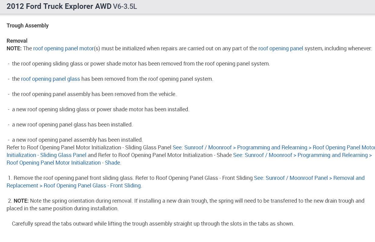

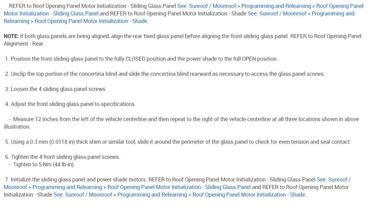

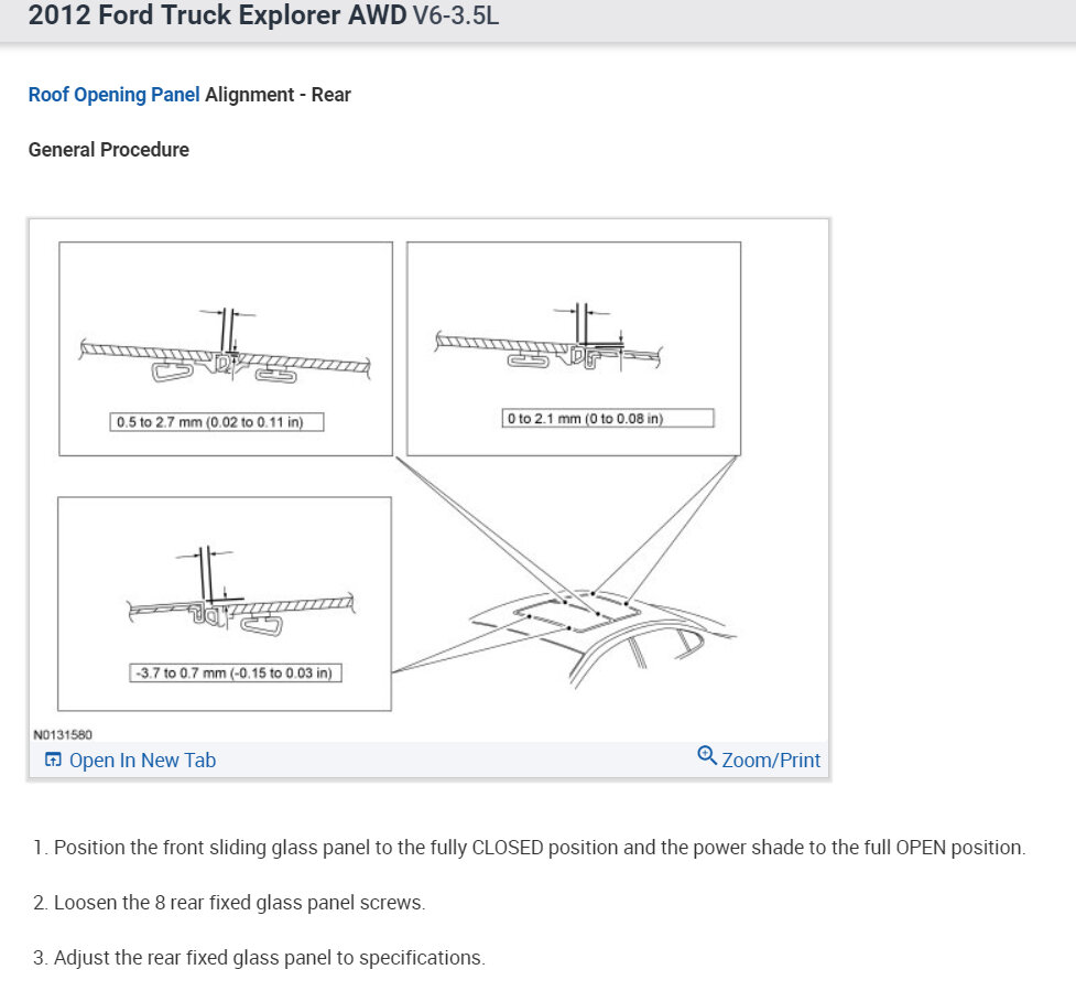

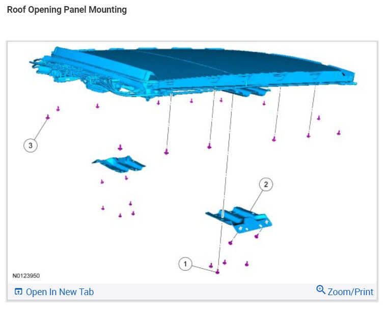

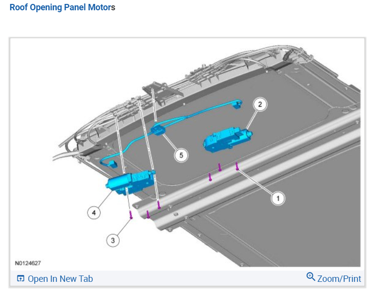

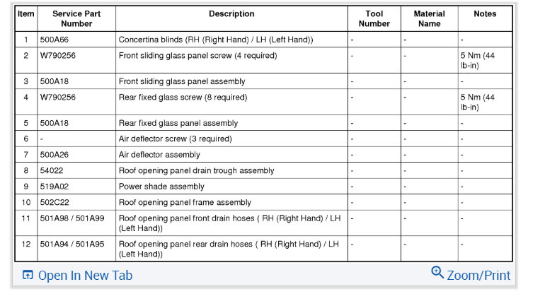

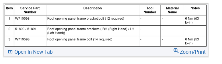

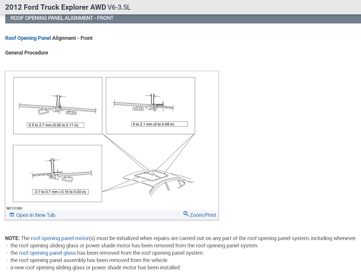

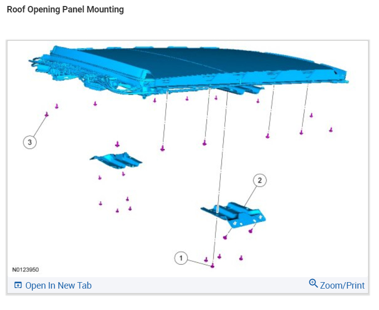

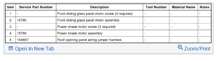

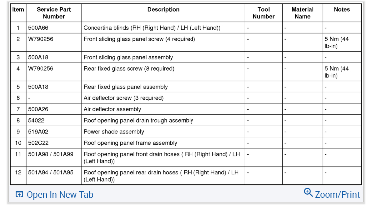

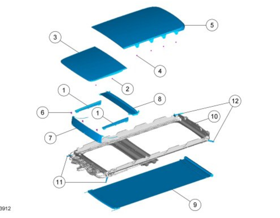

Yep, it sounds like the initialization failed or the new motor is defective. Can I ask if the replacement was an OEM unit? Here are the instructions they give when doing the job so you can make sure the installation and programming was done correctly. Check out the images (below). Let us know what happens and please upload pictures or videos of the problem so we can see what's going on.
