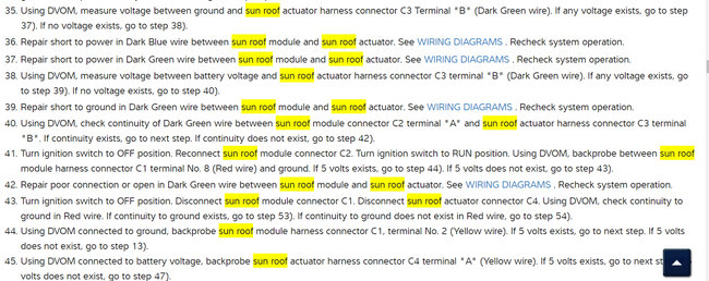

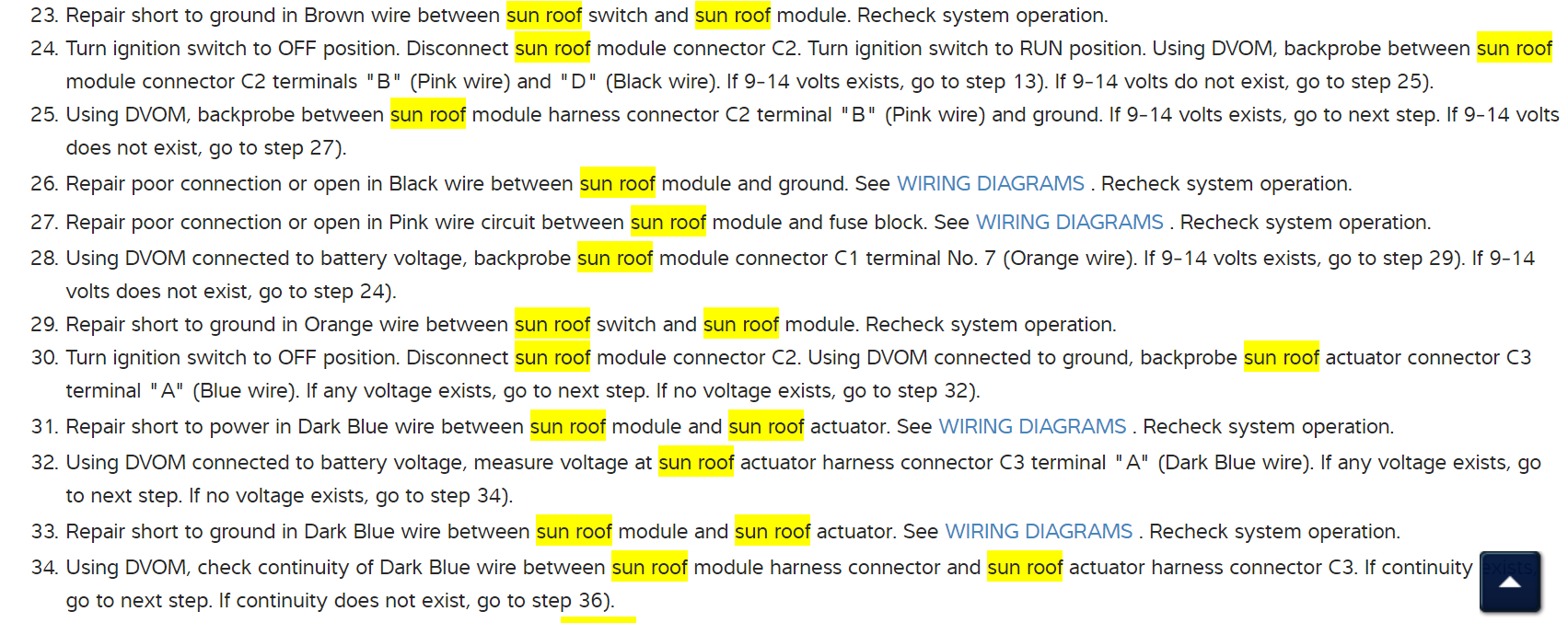

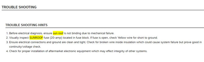

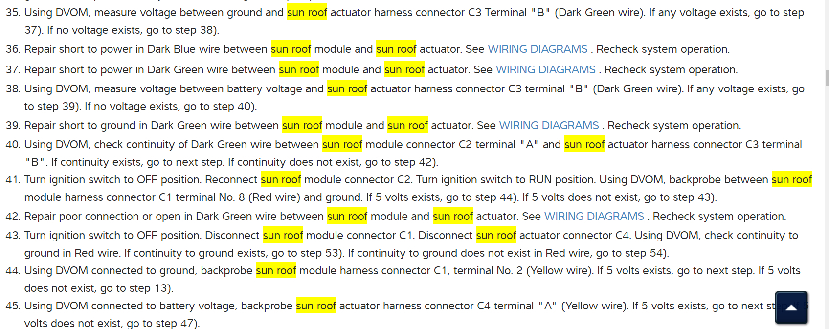

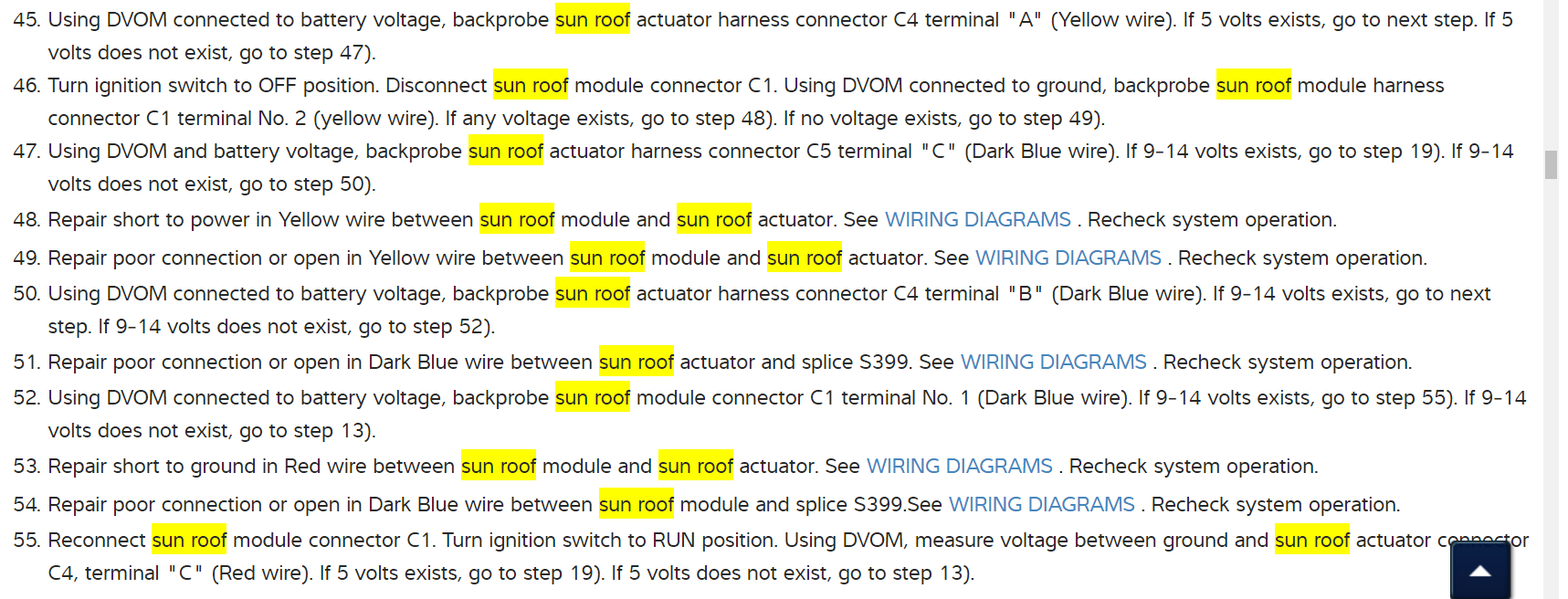

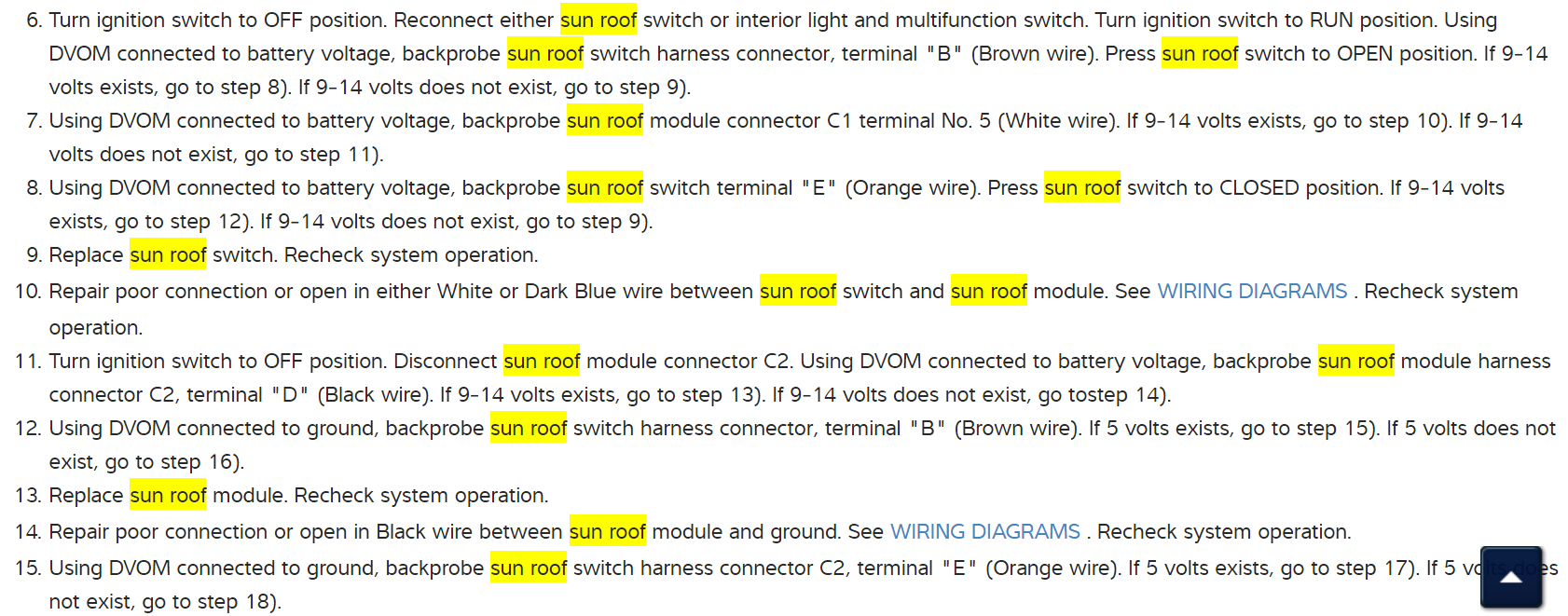

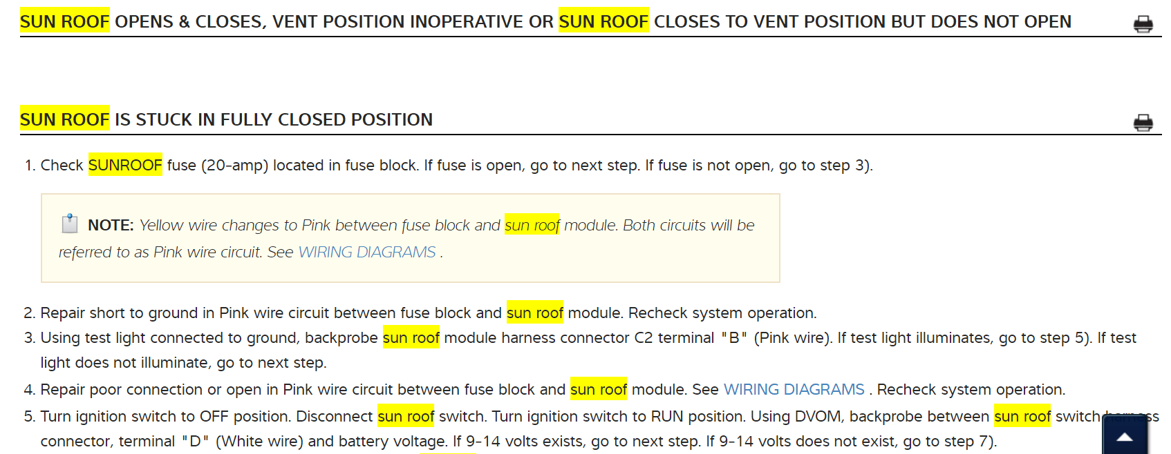

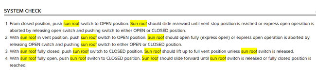

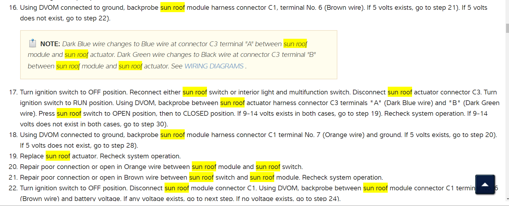

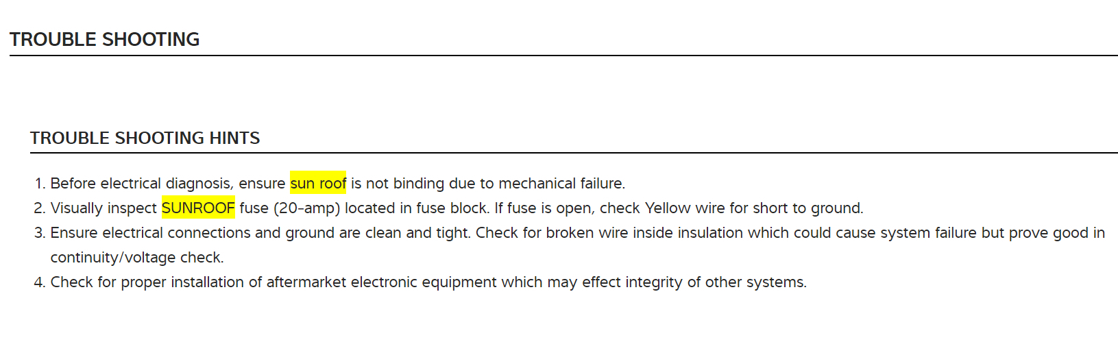

I have included in the diagrams down below the factory diagnostic troubleshooting guide for the sunroof's symptom for your vehicle. It is quite extensive, but please follow the directions, they are in a flow chart style, but you will be led to the problem so you can get it fixed. Please go through this guide and get back to us with what you are able to find out.
Thanks,
Alex
