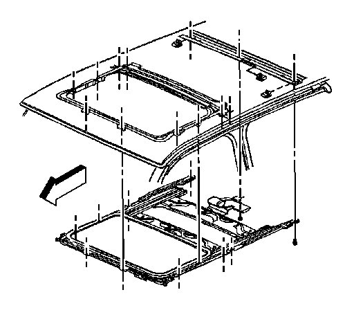

1. Lower the headliner. Refer to Headliner Replacement (Trailblazer EXT, Envoy XL) Headliner Replacement (Trailblazer, Envoy, Bravada) in Interior Trim.
pic 1

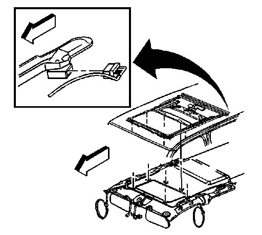

2. Disconnect the sunroof harness electrical connector.
Important: Do not remove the drain hoses.
3. Disconnect the drain hoses from the sunroof assembly. Refer to the following procedures:
* Sunroof Drain Hose Replacement - Front
* Sunroof Drain Hose Replacement - Rear
pic 2
