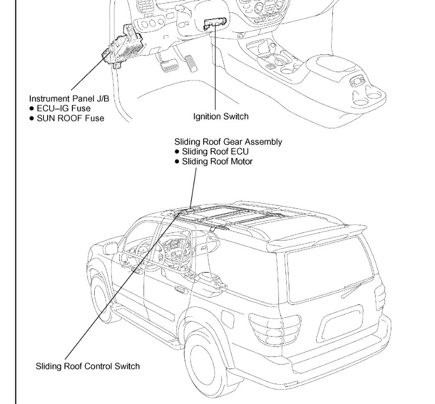

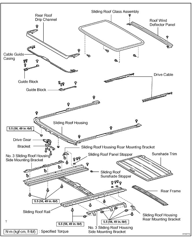

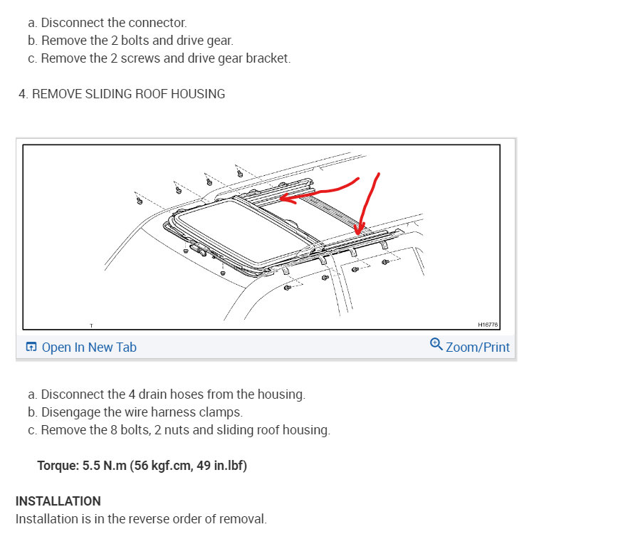

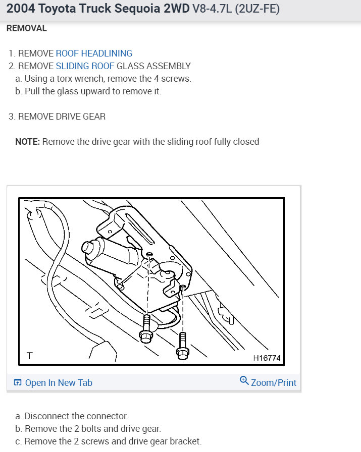

So, the problem is the motor is weak or the slides needs to be serviced (WD40). Check out the images (below). Please let us know how it goes.
