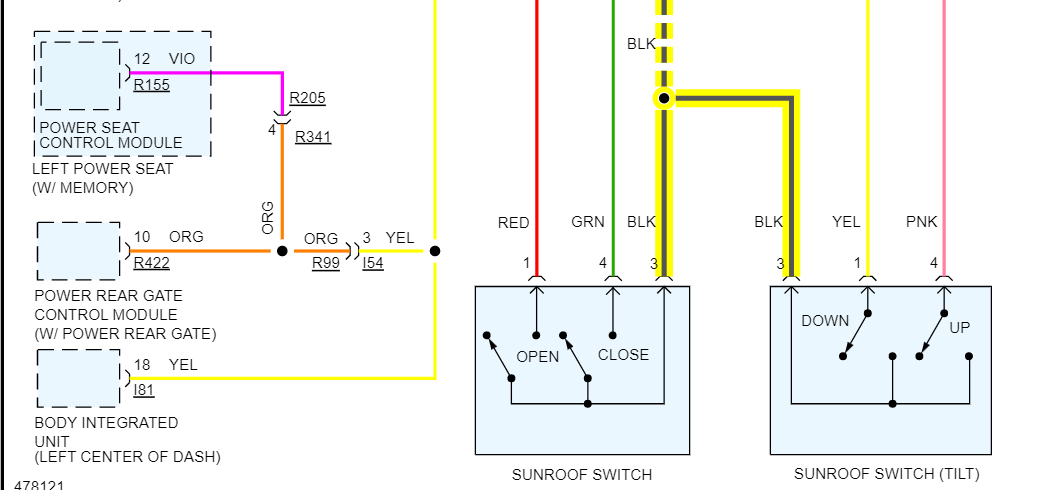

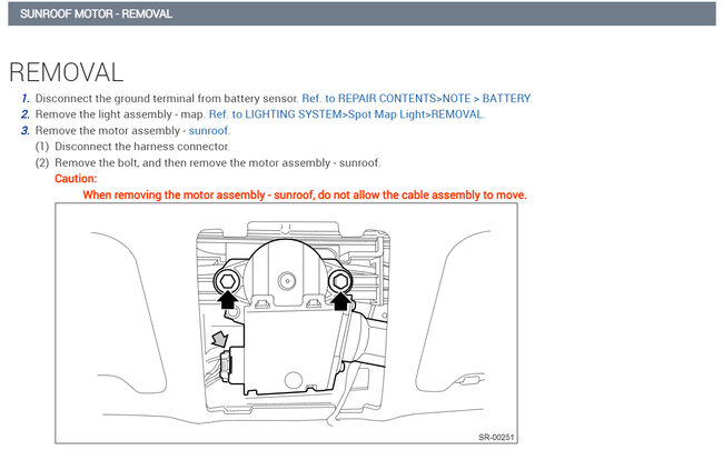

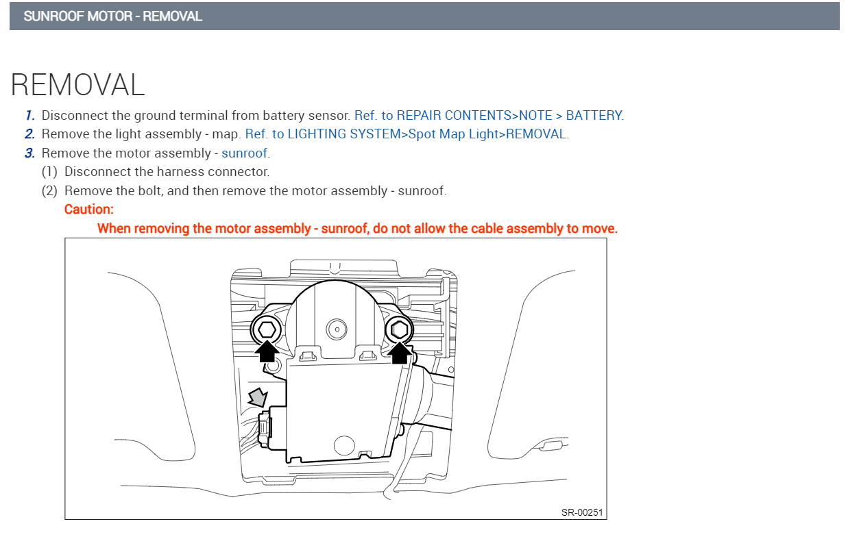

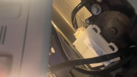

If you're not hearing any noises anymore, then inspect the window itself, I know it only moves about an inch, but see if the window is binding at an angle when it reaches its stopping point. it's possible that the window might be getting pushed unevenly. On the top of the motor there is just one gear, hopefully it hasn't been damaged from the previous owner trying to force it open. But look from the top when it's at its farthest open position and check the end of window to see if there is equal spacing along that edge.

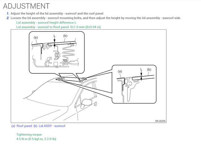

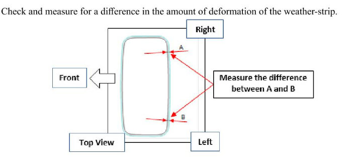

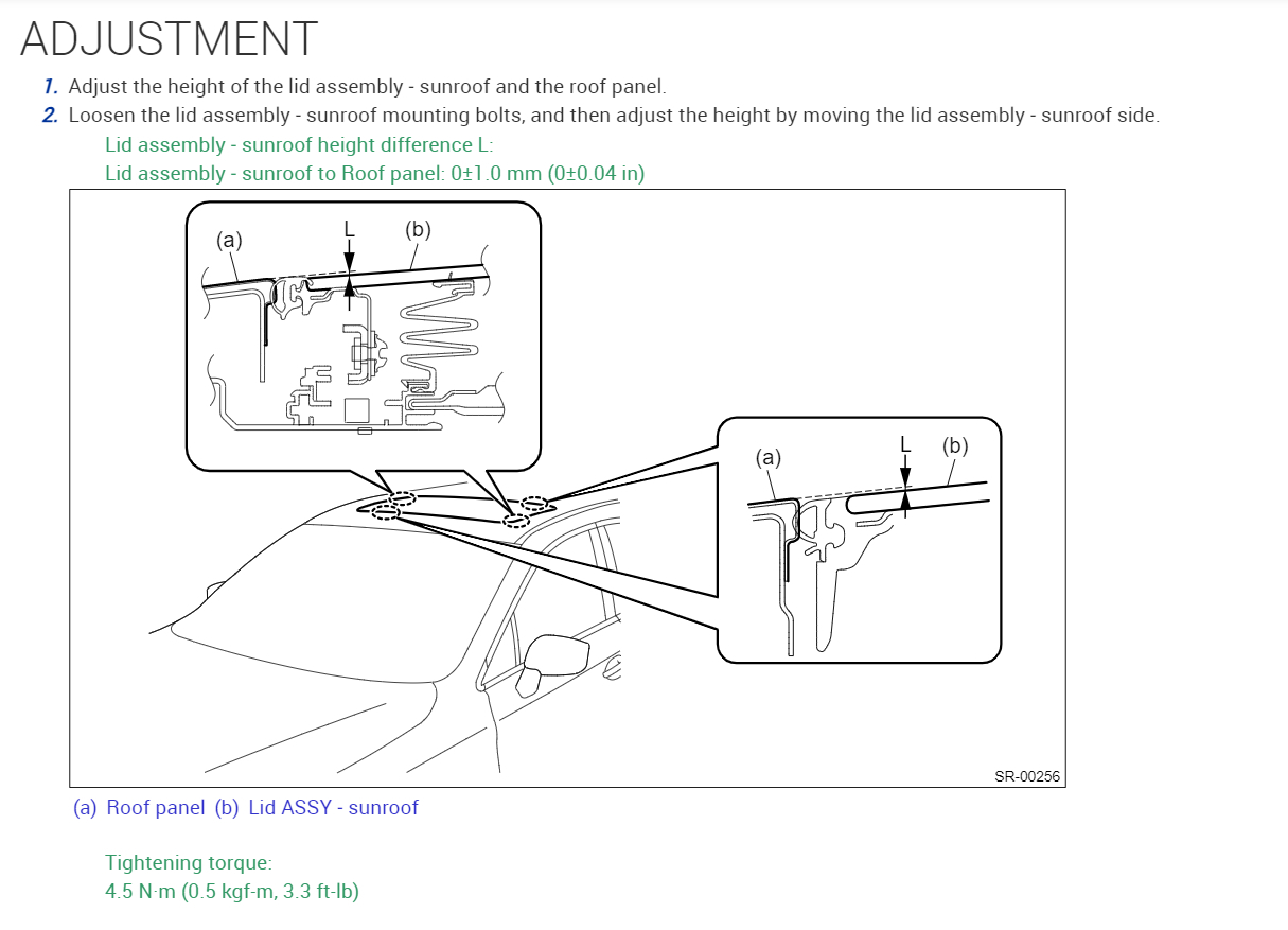

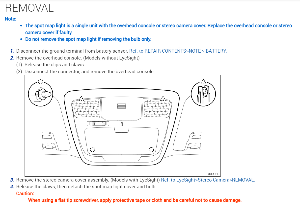

The glass adjustment is very vague, the sunroof height to roof panel is 1mm, so barely anything. And it does not say if the entire interior ceiling has to come out or not. On most to access the entire track and unit they do. To remove the entire sunroof assembly, it would have to come down, but it doesn't say for any adjustments. It's just that one page (2nd diagram).

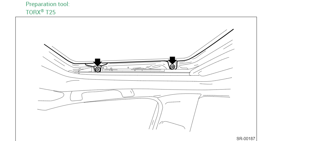

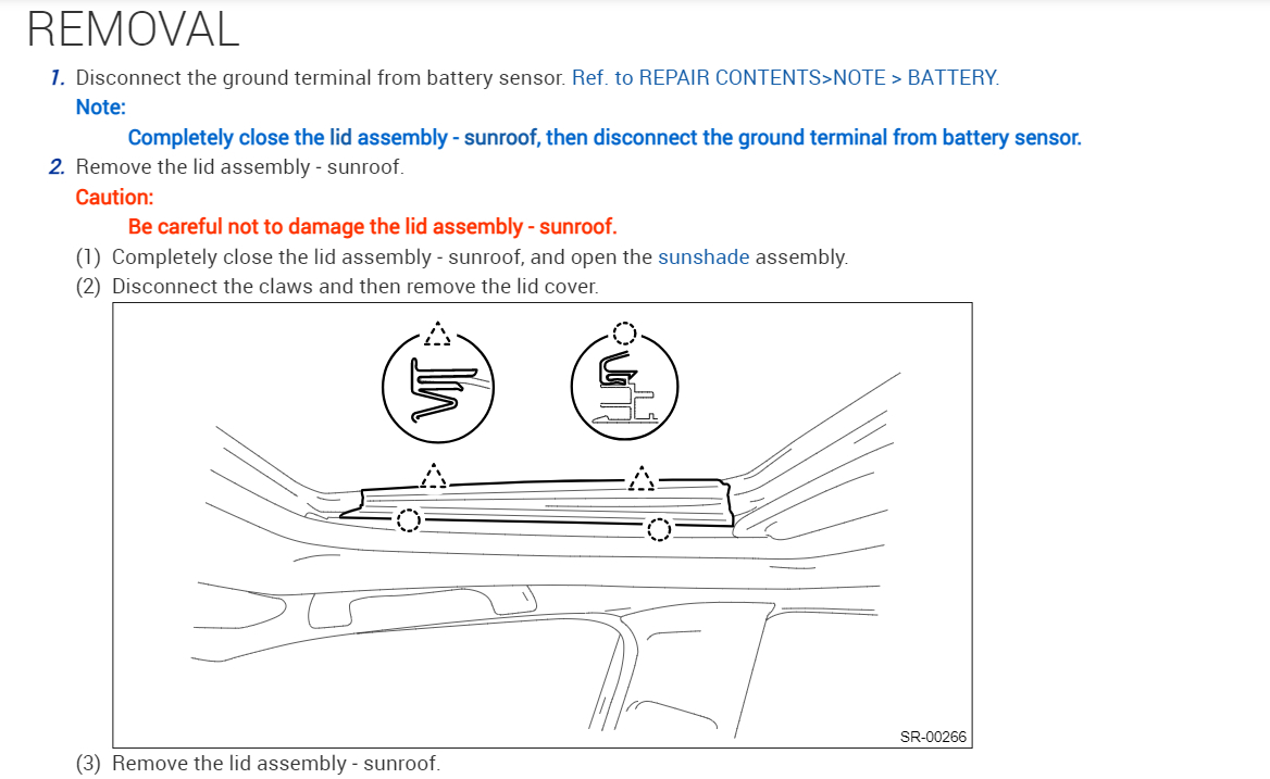

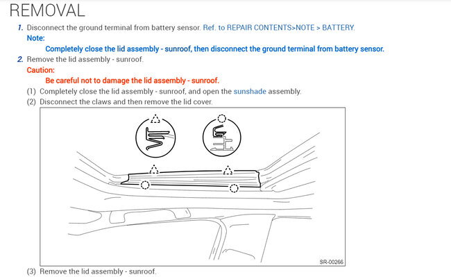

These are the first two steps in removing the entire sunroof assembly, but this might be the adjustment they are referring to. These Torx bit bolts. I don't see any other way for adjusting the window. The rest is removing the ceiling which you don't want to do. It's a huge job.
