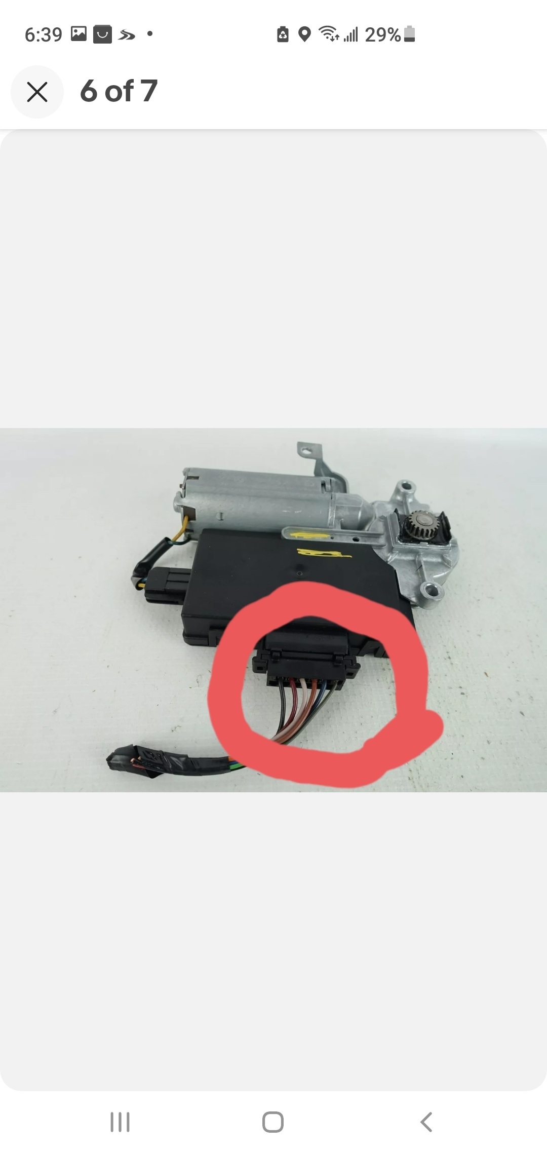

I was able to remove the sunroof motor that had three screws. The highlighted area in the pic is the power harness. I am trying to disconnect it but don't know how.
Jan 26, 2022 at 4:37 PM
It's hard for me to tell by looking at that angle. Is it possible to get a straight-on view?

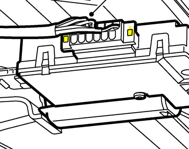

I attached what I believe is the same connector below. It has been a while since I removed one, but I believe the two spots I highlighted are the key to removal. If I recall, I was always able to place two small flat screwdrivers in those openings and spread apart the plastic tab connector for it to come off. I'm just trying to confirm yours is the same.
See pic below.
