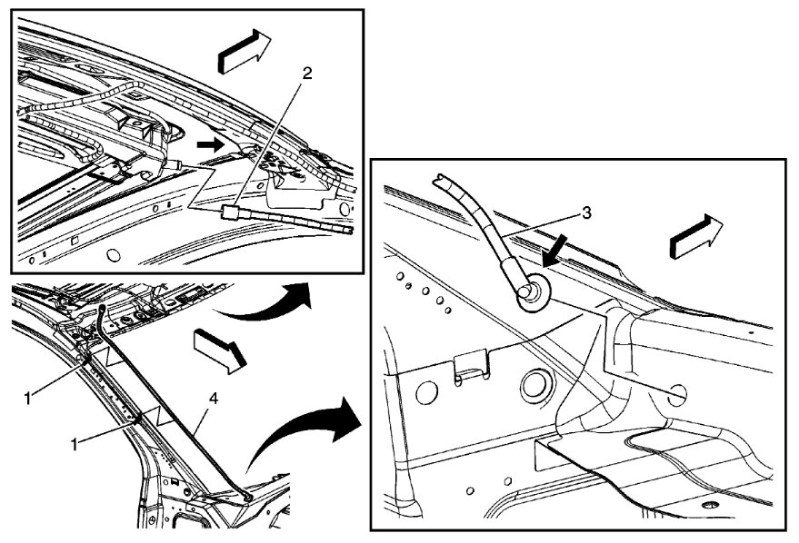

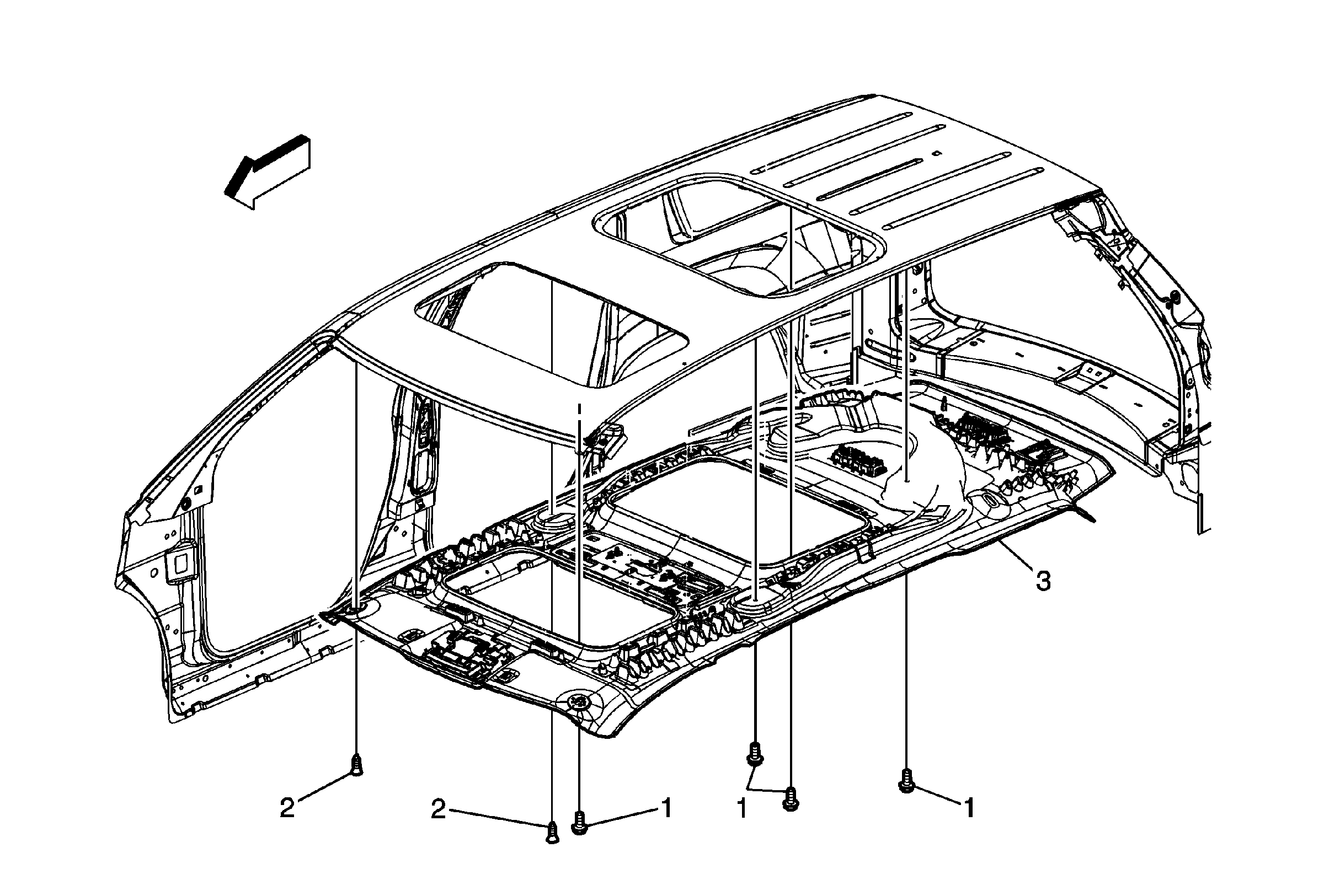

Hello, I'm Danny.

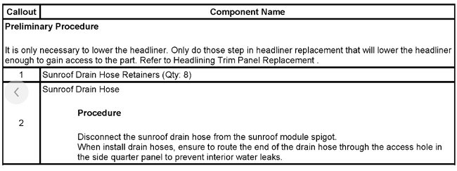

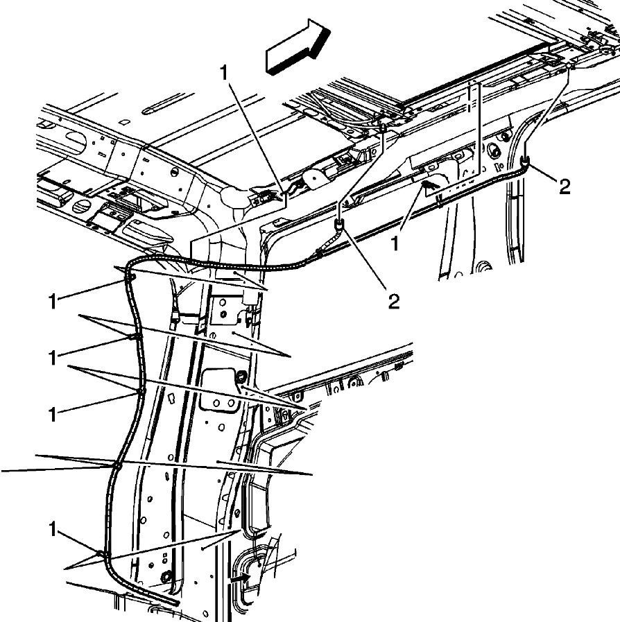

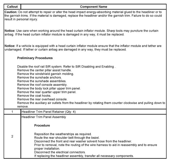

Here is what I've found for your Buick. I've attached the pictures below.Hope this helps and thanks for using 2CarPros.

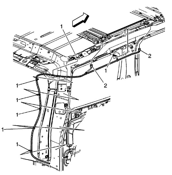

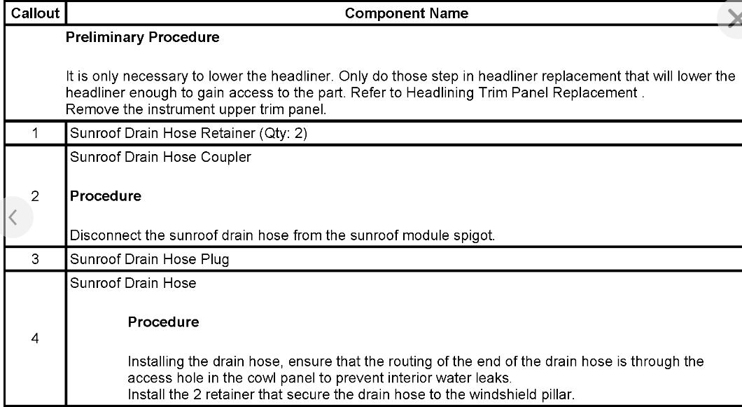

Hello again.

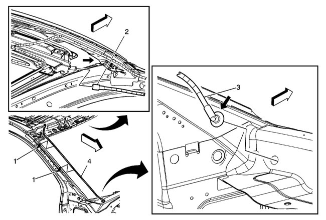

As you can see by the pictures I've attached there are front and rear drain. Hope this helps and thanks again for using 2CarPros.

Welcome back. For these they don't show a lot of information. However they are not that difficult, the trim around the edges gets removed enough that you can lower the headliner just enough to reach the drain hoses. As it is leaking at both points I suspect the hoses have come off both drains, There are three drain connections, one goes down the A-pillar and a second one Ys together for the rear drain that goes down the C-pillar. I would suspect they either got plugged and the water is draining out the sunroof itself and down the pillars or the hoses came off when someone attempted to clean them out, both are very common.
The pictures tell more than the information does.

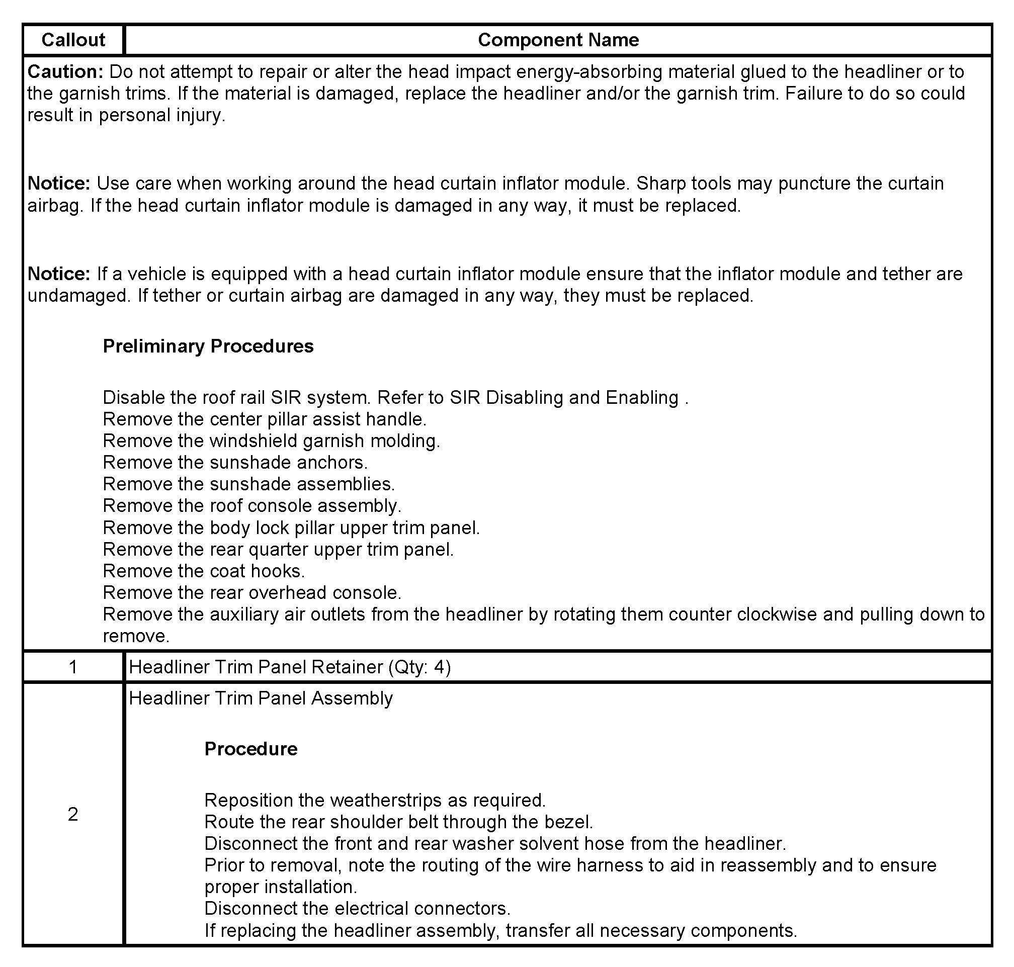

Correct, As it states in the first image, you need to remove the trim around the edges. That means the pillar trim. However you don't need to remove all of it at once, you should be able to remove only the rear trim and to the front door. Then lower the headliner enough to get to the drains.
