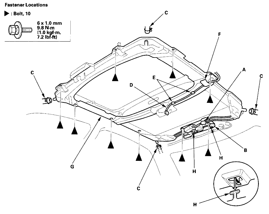

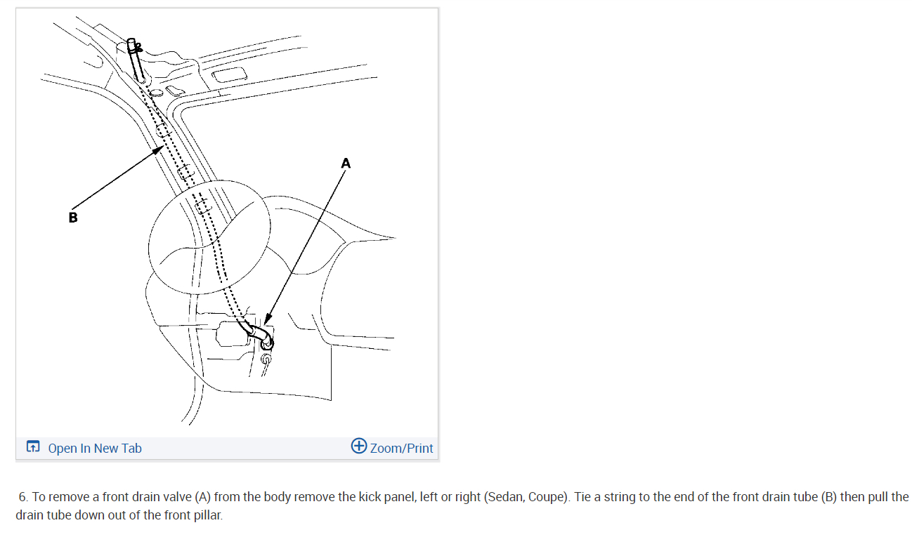

on passenger side the sunroof leaks water if you pour water at the front drain on passenger side of the sunroof drain it will dump out near blower motor. i fixed a leak on the driver side above the brake petal years ago is there a mid-connection on the passenger side and how do i get to it.

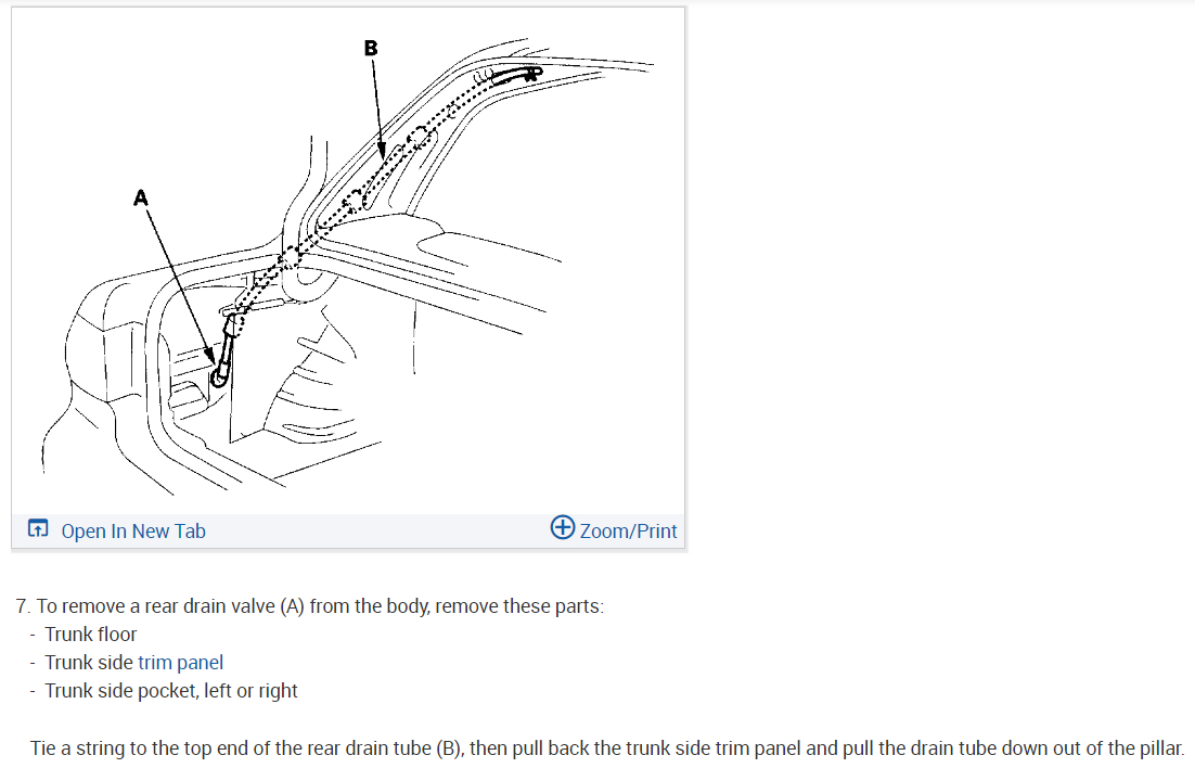

Yep, the sunroof has drain tubes that drain the water outside the car it sounds like one of these tubes is clogged or disconnected, here is the location of the drains so you can check it out. You might need to remove the headliner to access the tubes, here are the diagrams of the drains to help you understand what is going on. Check out the images (below). Please let us know what happens.
