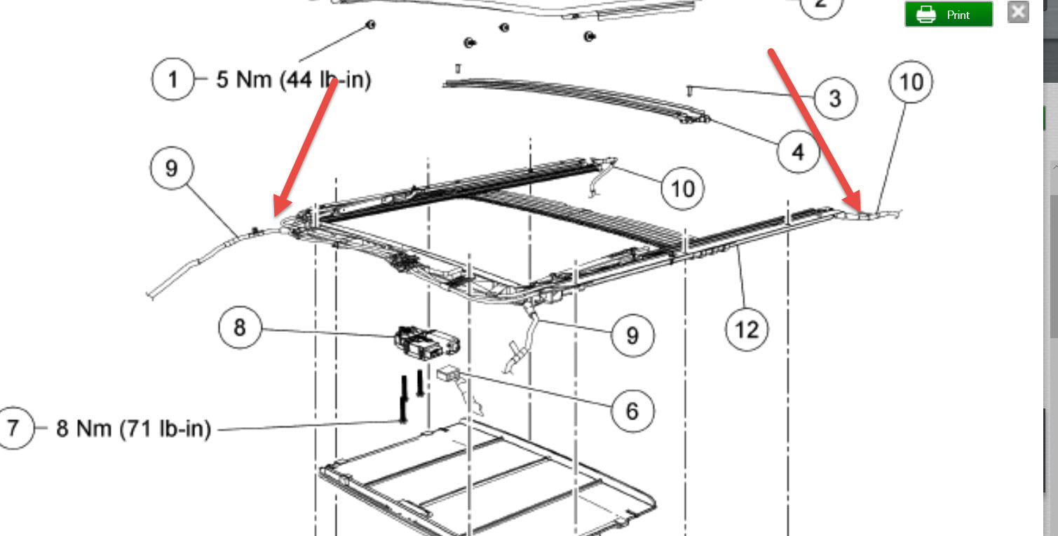

I know thes are clogged, but I can't locate the exit point in th fender or engine compartment.
Fronts and rear..

arrows point to drain holes one in front one in back.

I understand this image shows the exits from the drain. Where do the connecting tubes drain out through in the vehicle on to the pavement ? Thanks so much !

the onle may drain to under front of windshield or out to between fender and body the other will drain probably down c pillar or someplace like that maybe the b pillar. try blowing air through them to clean them out

Thanks. I quizzed the parts guy at the Ford dealer, he said that the drains end in a space that is between sheet metal and cannot be accessed. recommended that I either blow them out with air (but be careful not to burst the tube) or, re-plumb the drain with my own tubing. I cannot understand why this should happen. The drains seem much smaller than they need to be, almost like they are designed to clog . . . more dealer $$$. Enjoy your day.
