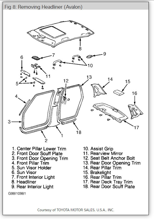

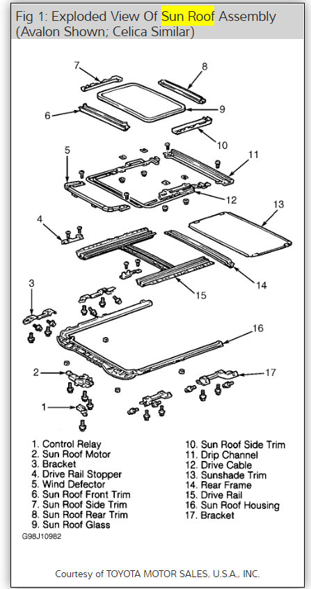

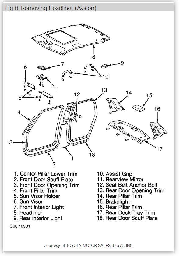

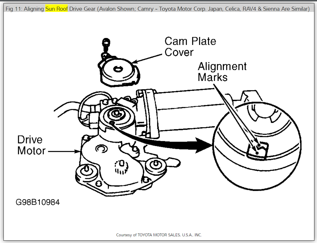

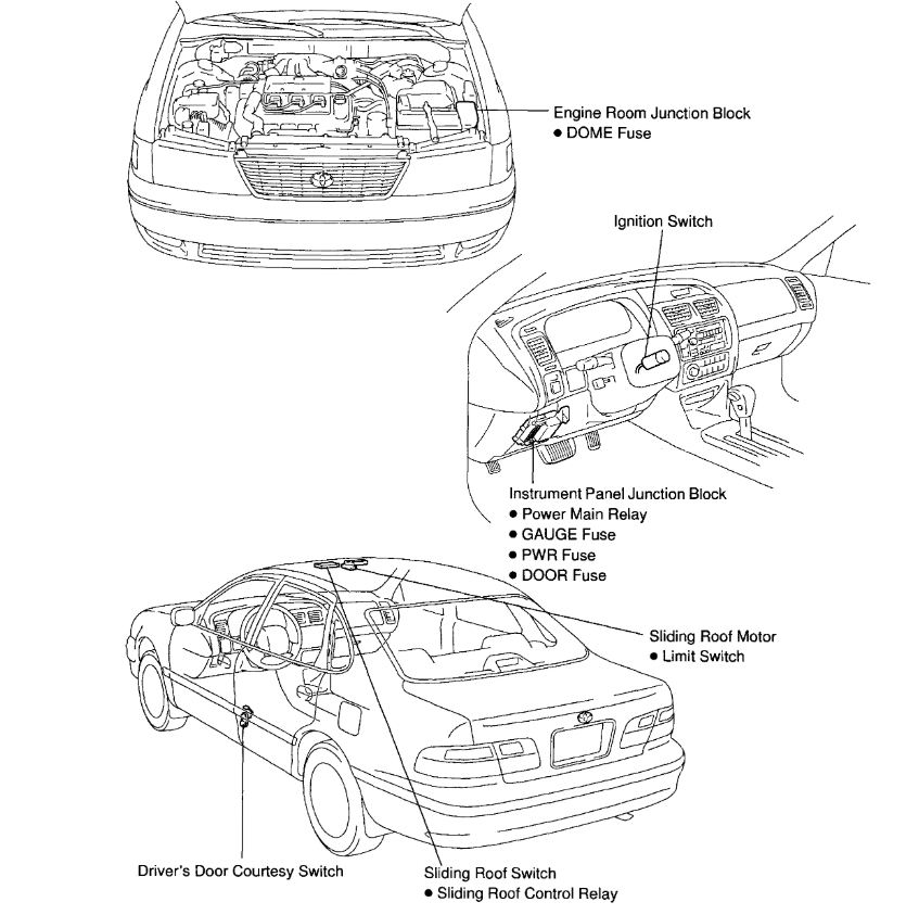

There is no easy way to do this. There is no hand crank so if the motor is out is best to replace it. Here are diagrams to help you get the job done and instruction as well.
