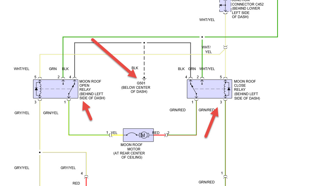

Sunroof stopped working.

check ground marked in picture then check to see if gray/yellow wire is sending power to relay. could be switch or relays or a bad motor.

forgot picture.
Image (Click to enlarge)
