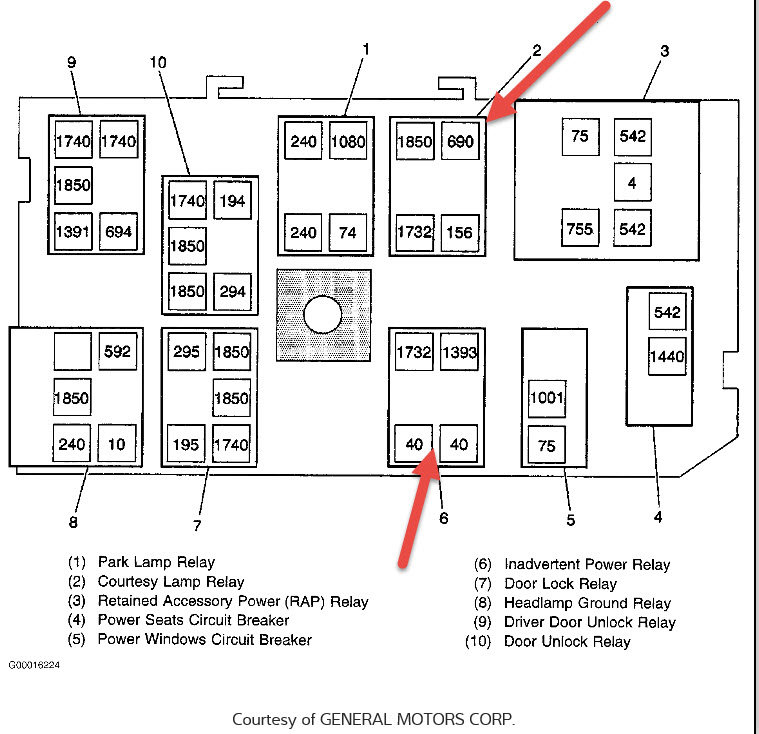

Have replaced all four bulbs in both visors, still no light. My Haynes manual covered every interior bulb, but this one. Any troubleshooting ideas?

it may be the relays in picture behind fuse box inside truck and not sure if these are replaceable or not, but check these if not it will need to be scanned for codes by a mechanic as it may be body module.

Thanks so much for the help. That will be my starting option, and i will go from there if the relay is not the culprit. thanks again.

Found the common ground (black) for both visors was the problem.All 4 visor bulbs are now functioning properly.. Thanks!
