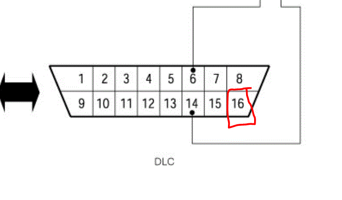

Try to start no crank then after I disconnected battery lead the car cranks but not starting. I am try to connect scan tool but all time I try it gives me no communication . And now sometimes crank but no starting and sometimes no crank just the dashboard on. Check engine light off all time not came on when dashboard on. Thanks for your time .engine 2000cc Doch.

Next, I need you to check pin 16 in the data link connector (scanner connector) for 12v power. It should have power at all times. See picture 1.

About obd2 I can to enter for body control ABS, airbag, but my scan tool not communication with engine and transmission ECU. they in the same control box in this car for sure I have 12 v dc in pin 16. I am check for voltage in spark plug no power and no power in fuel injector plugs. I feel that my engine and transmission control unit failure. what you think sir? Thanks so much for your help.

It's possible, but unlikely that both have failed at the same time. Have you confirmed both a chassis ground on pic 4 and a signal ground on pin 5? Have you checked fuses?
