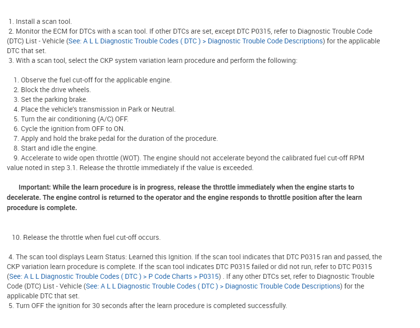

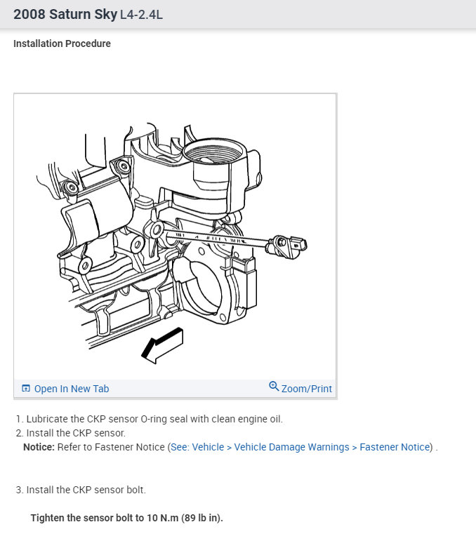

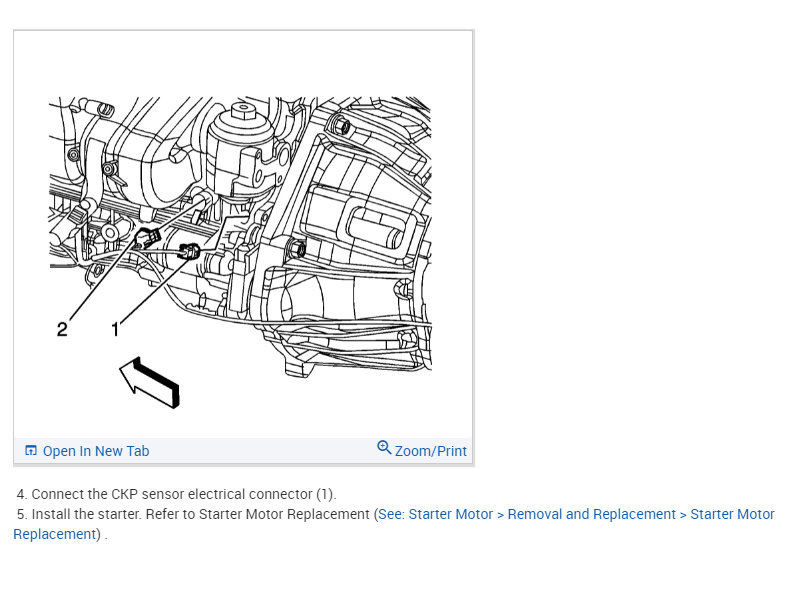

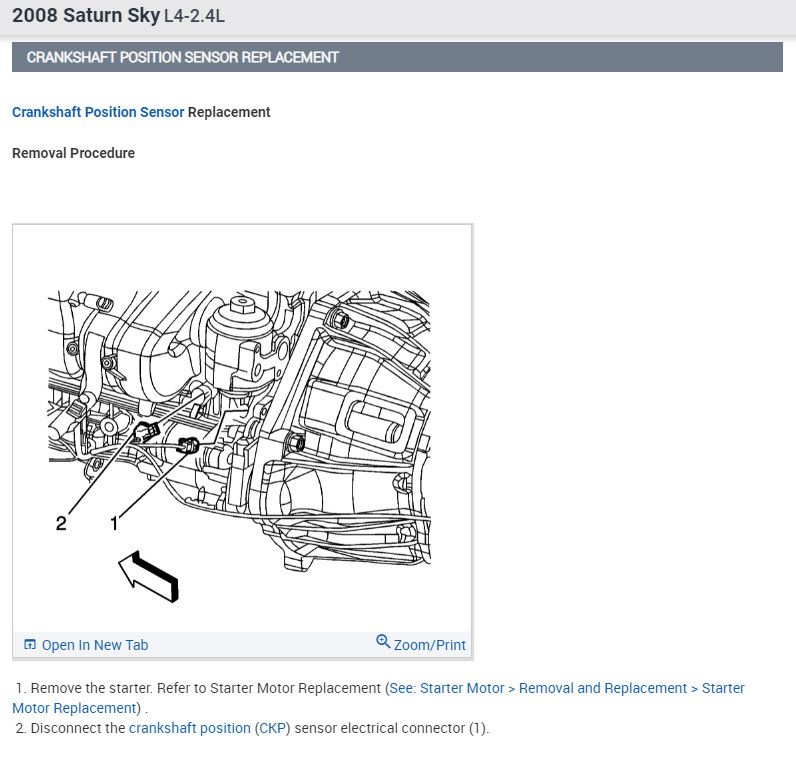

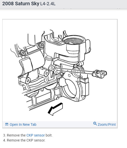

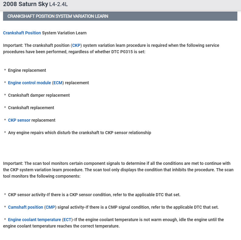

I have attached diagrams showing the crank sensor replacement procedure. Keep in mind that this sensor does need to be programmed after replacement.
