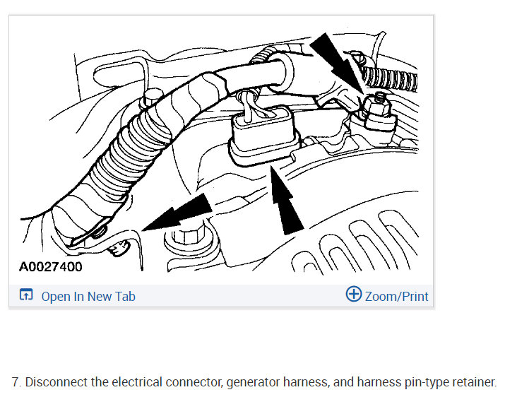

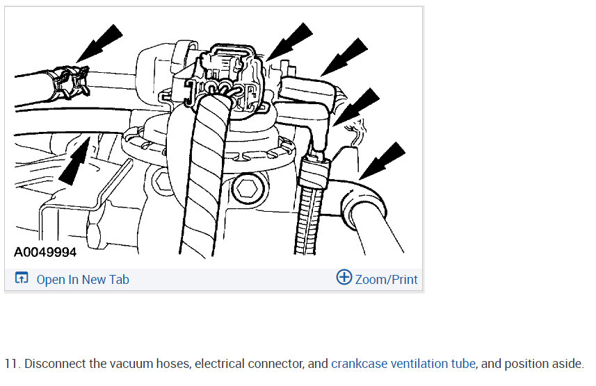

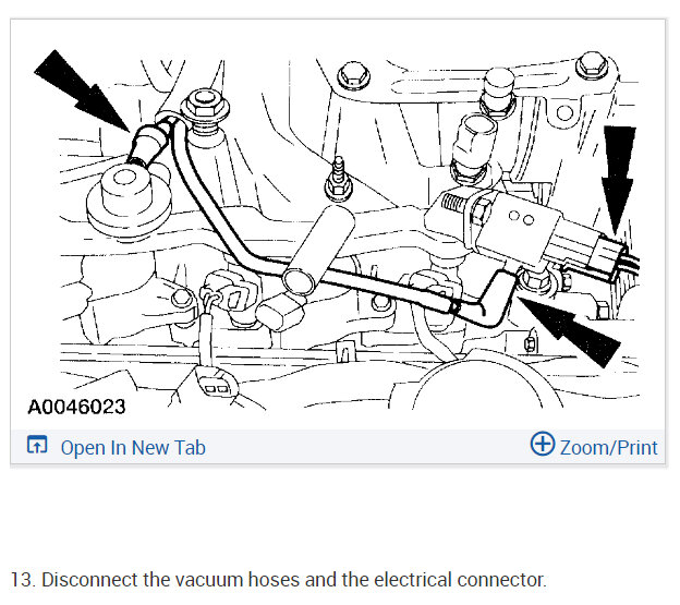

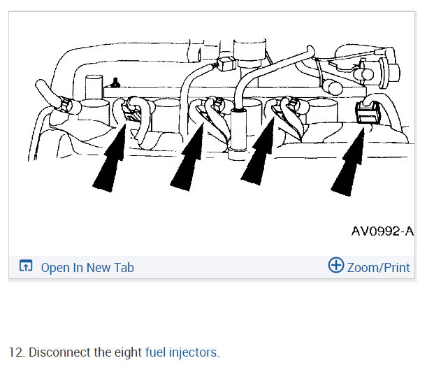

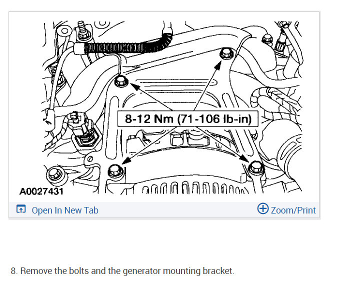

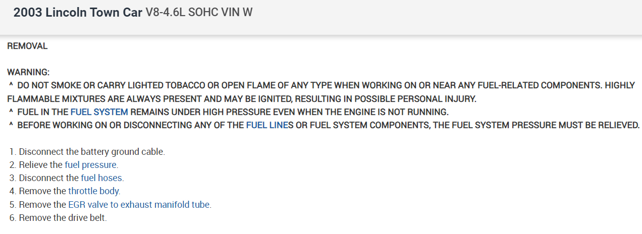

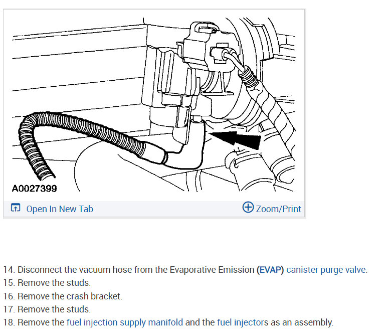

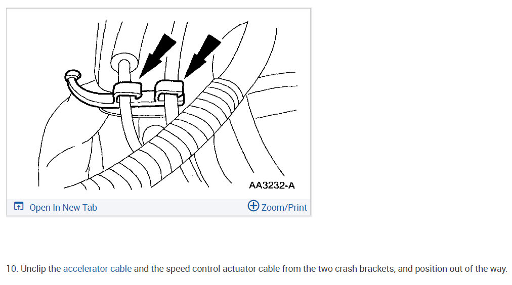

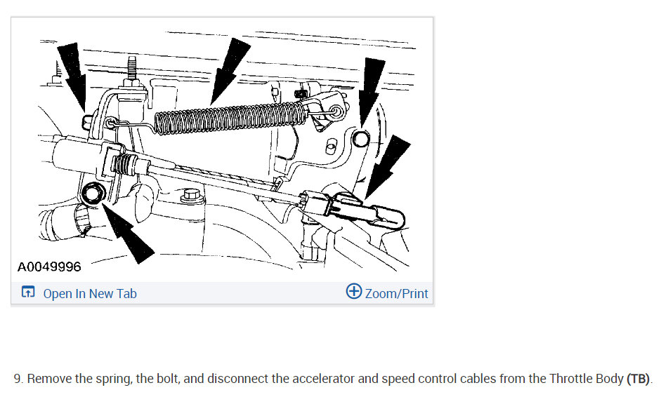

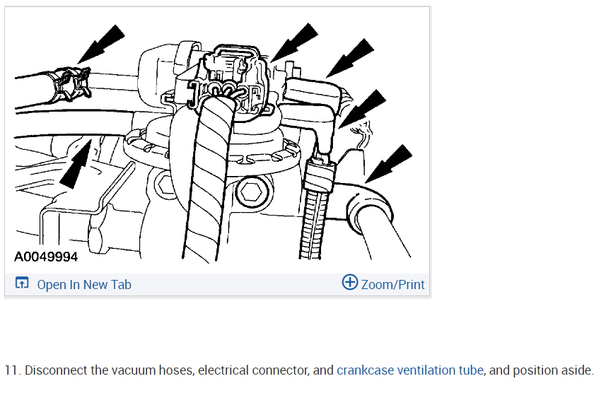

9 times out of 10 it will be one the fuel injectors. I would use a flashlight to inspect each fuel injector and if you find one leaking replace it with the new unit. Here is how the job is done in the images. Check out the images (below). Please upload pictures or videos in your response of any problems so we can see what to help you with. below.
