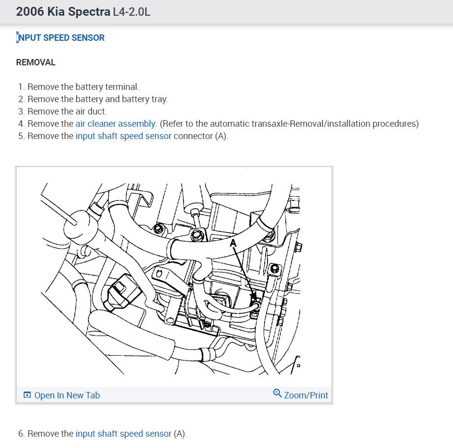

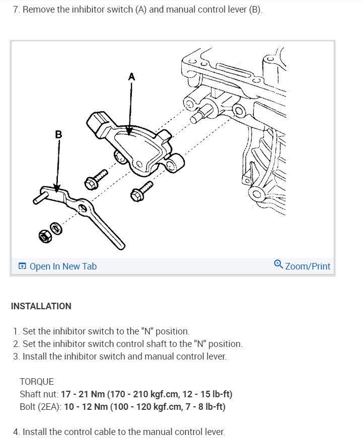

Hello. I have problem when I driving for a little bit I have some bump and gear stuck in third. I was at mechanic he change me solenoid(it was code about solenoid c). But when I drove two days i got again this problem. Also its shows me errors P0170 and p0171. Do you know what is the problem? I checked codes and it sill shows me error about solenoid c.
