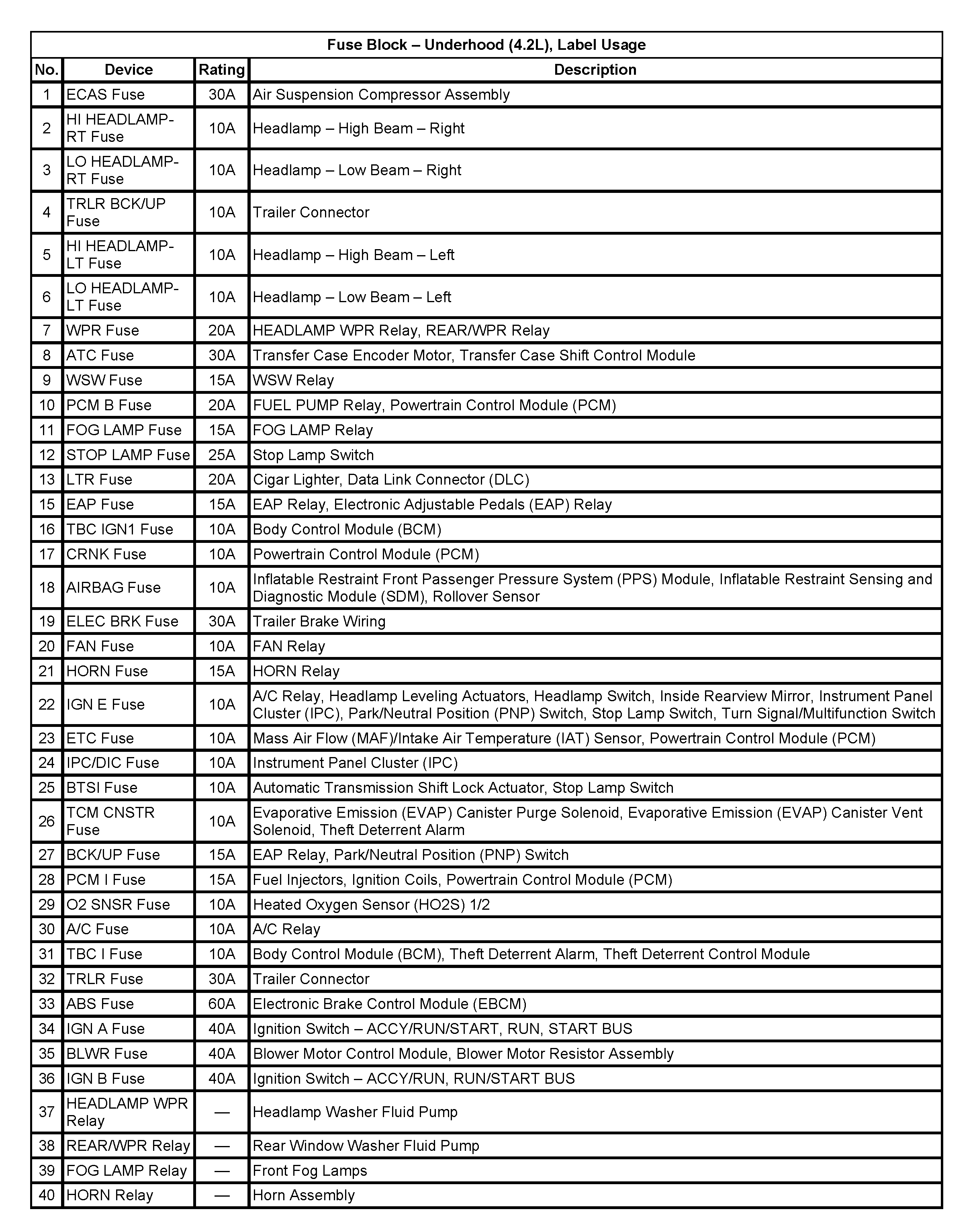

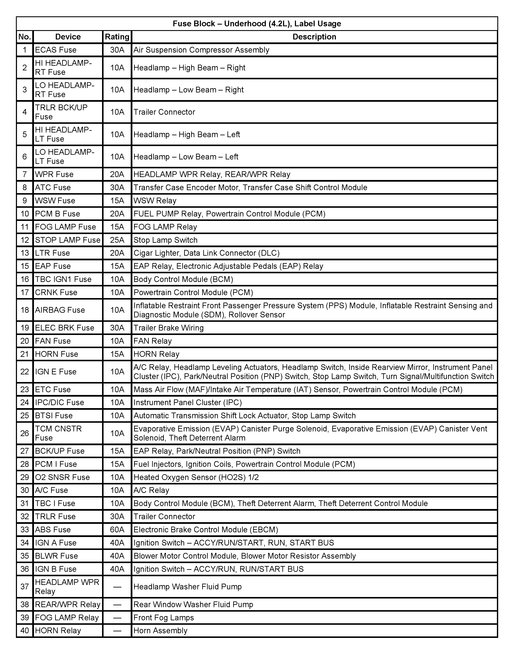

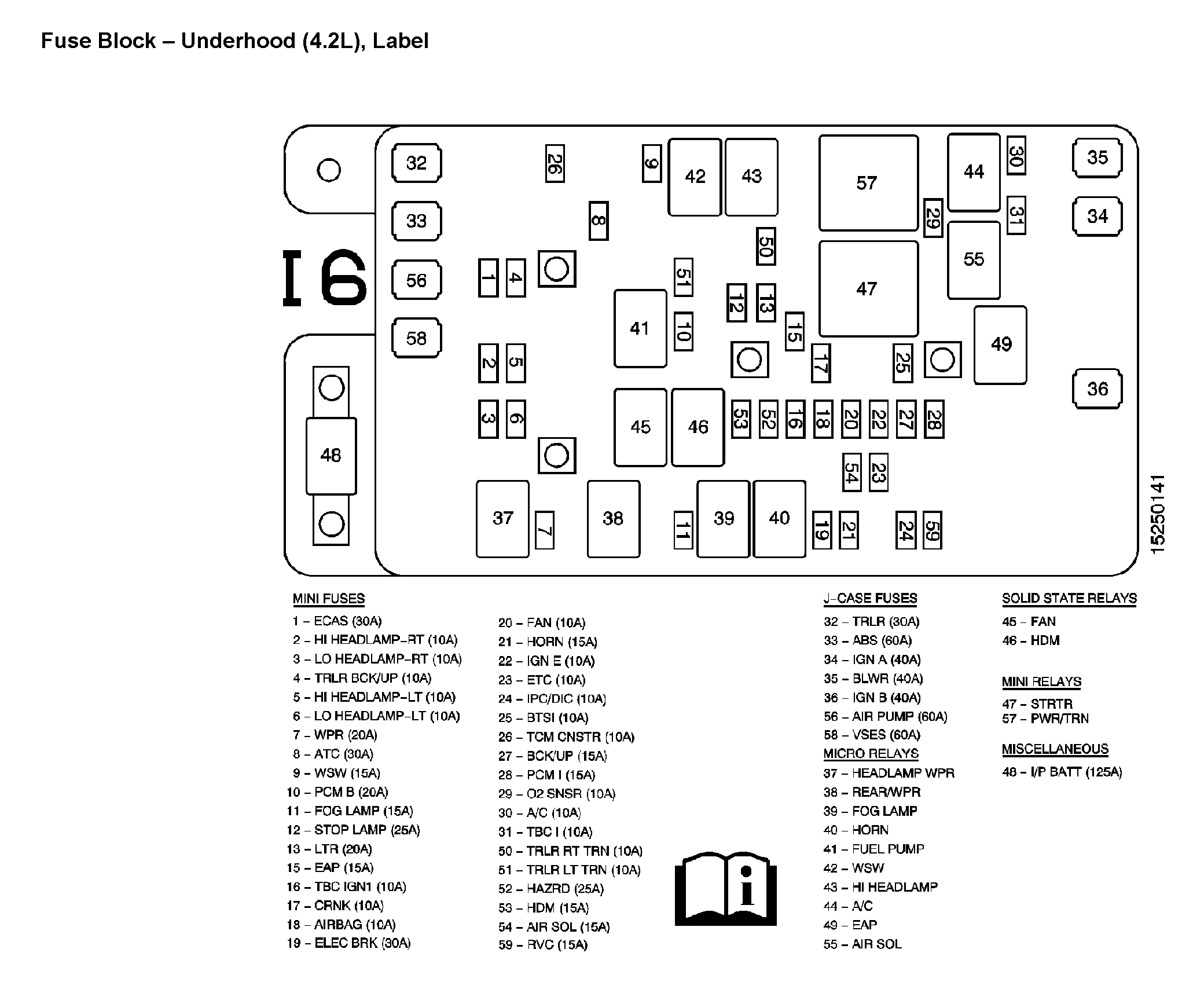

Next, I need you to check fuses under the hood in the power distribution box. Check fuses 22, 34 and 36. See attached pictures.
https://www.2carpros.com/articles/how-a-car-fuse-works
If when you turn the key, nothing happens, I suspect fuse 22. Fuse 22 powers the brake lights and the park/neutral switch. Regardless, check all the ones I mentioned and let me know what you find.
