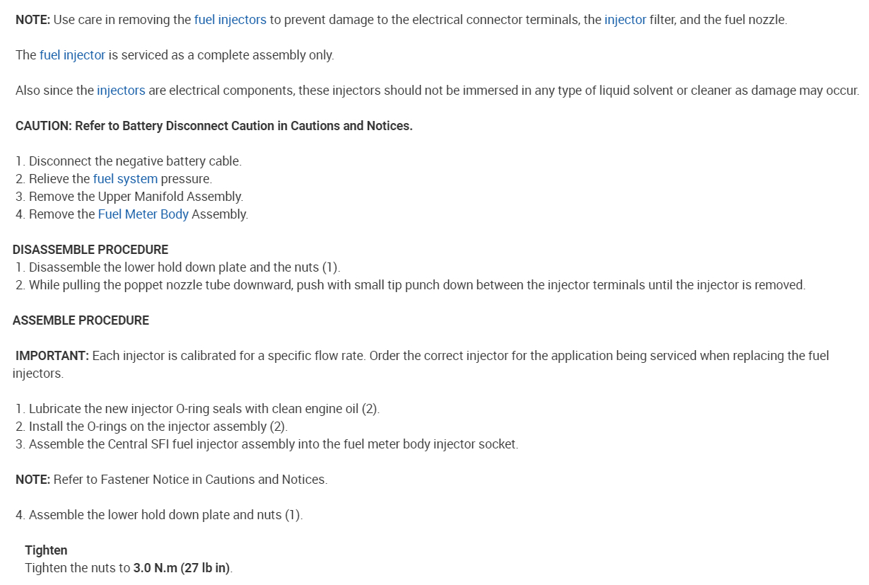

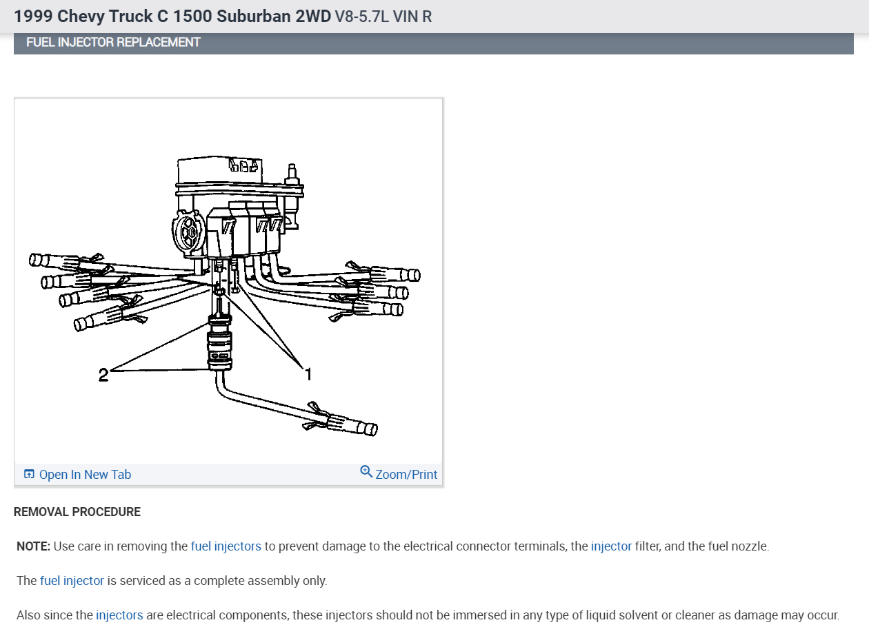

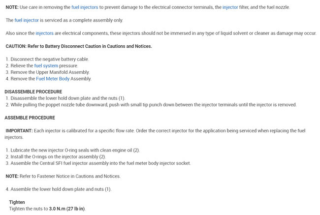

When you replaced the gaskets did you replace the injector spider? This would go bad all the time in the shop when we worked on anything intake related and the engine would not start, I would use an AC Delco unit only, does the engine have any codes? You can get a code scanner from Amazon for about $20.00.
Here is a guide/video to show you how:
