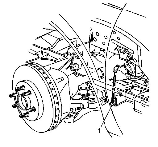

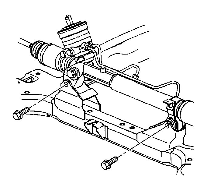

4. Remove the stabilizer shaft. Refer to Stabilizer Shaft Replacement.
picture 1
5. Remove the bolts retaining the steering gear to the engine frame.
6. Remove the ball joints from the steering knuckle. Refer to Lower Control Arm Replacement.

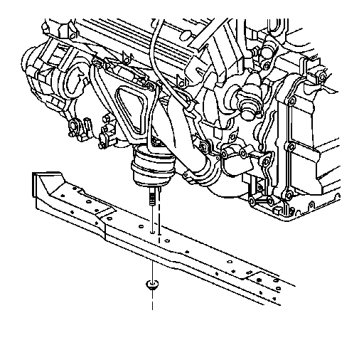

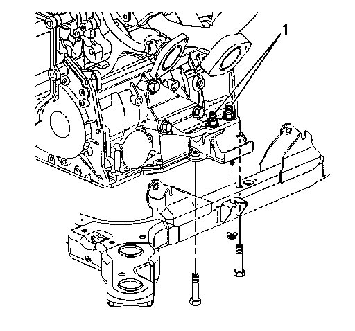

8. Remove the brake pressure modulator valve. Refer to Brake Pressure Modulator Valve Replacement.
picture 2
9. Disconnect the road sensing suspension links (1) from the lower control arm ball studs.

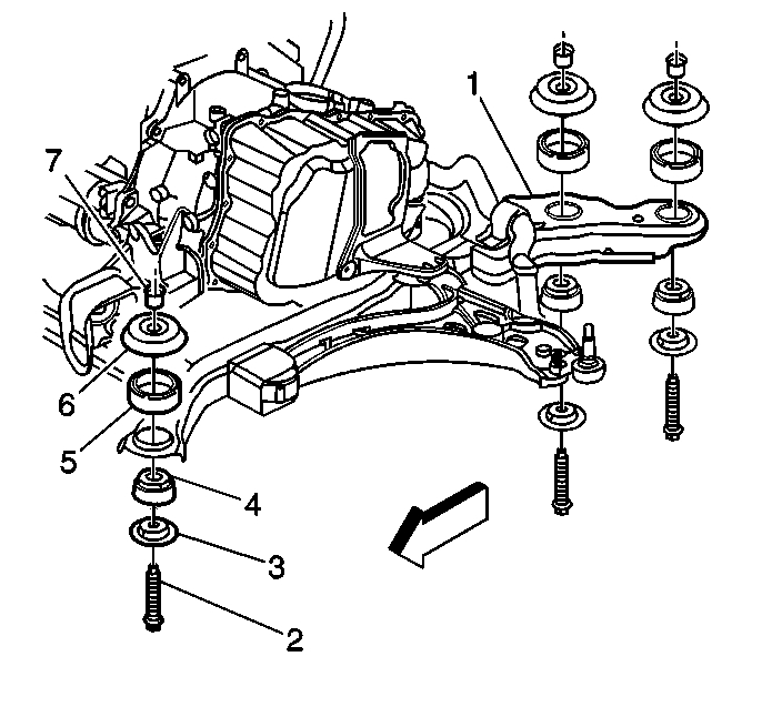

10. Remove the A.I.R. Pump. Refer to Secondary Air Injection Pump Replacement.

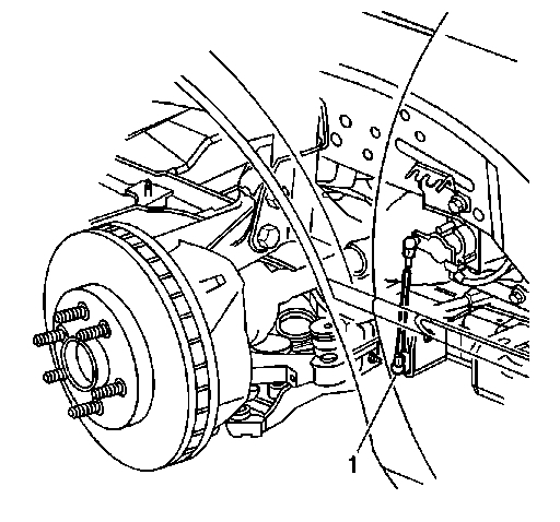

picture 3

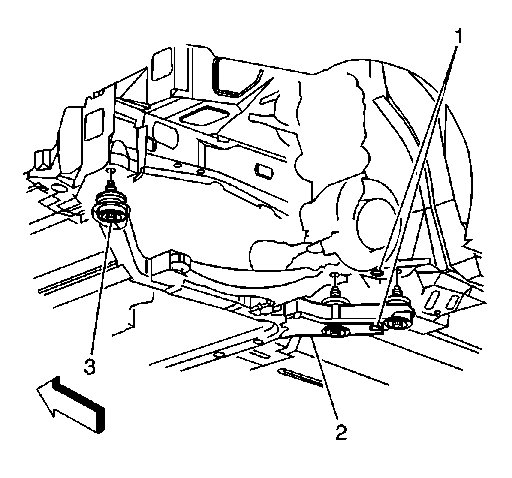

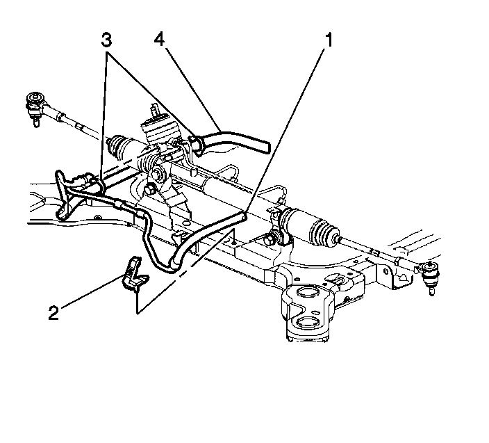

11. Remove the brackets (2) retaining the power steering line (1) at the frame.
12. Remove the retainer clips (3) retaining the power steering line (4) along the left side of the engine frame.
13. Using mechanics wire, retain the steering gear to the body.

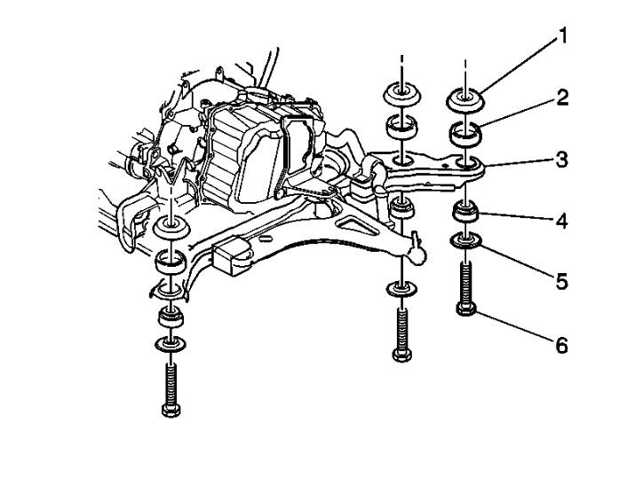

picture 4

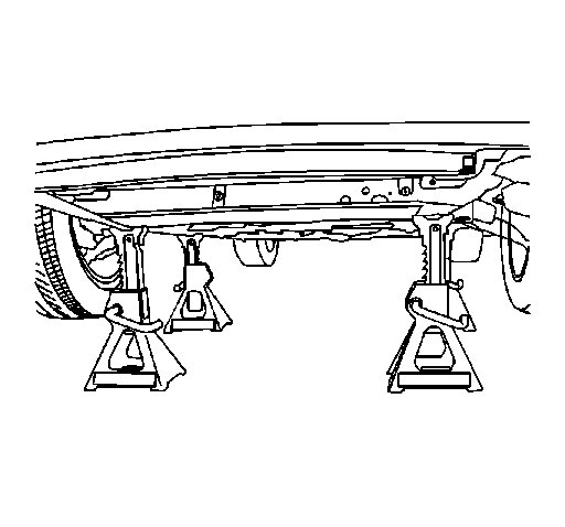

14. Lower vehicle until engine frame rests on suitable jack stands or J 39580.

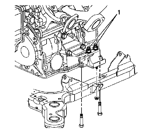

picture 5
15. Remove the fastener retaining the front engine mount to the engine frame.
