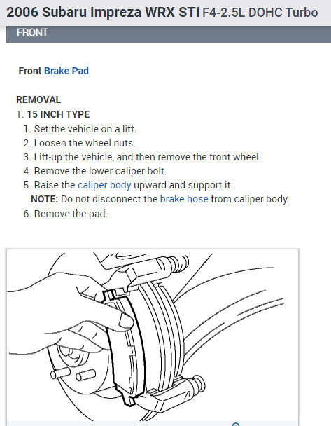

Front Brake Pad

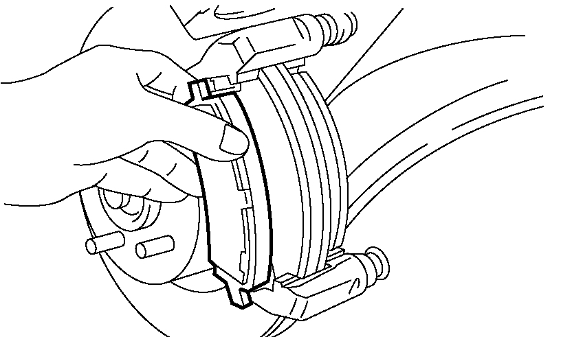

REMOVAL
1. 15 INCH TYPE
1. Set the vehicle on a lift.
2. Loosen the wheel nuts.
3. Lift-up the vehicle, and then remove the front wheel.
4. Remove the lower caliper bolt.
5. Raise the caliper body upward and support it.
NOTE: Do not disconnect the brake hose from caliper body.
6. Remove the pad.
pic 1

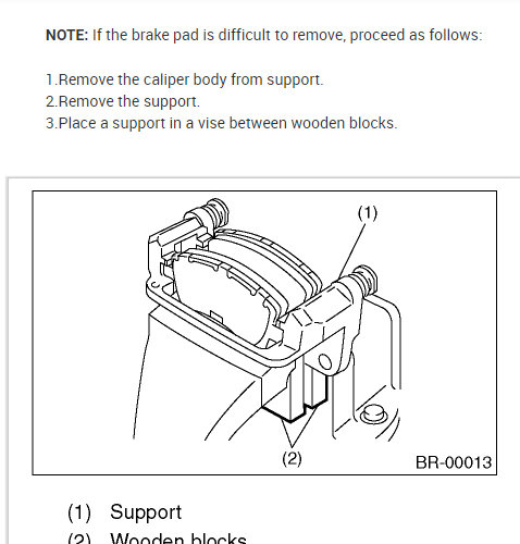

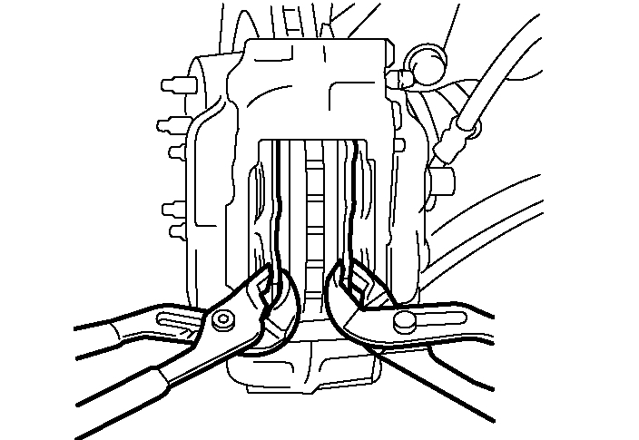

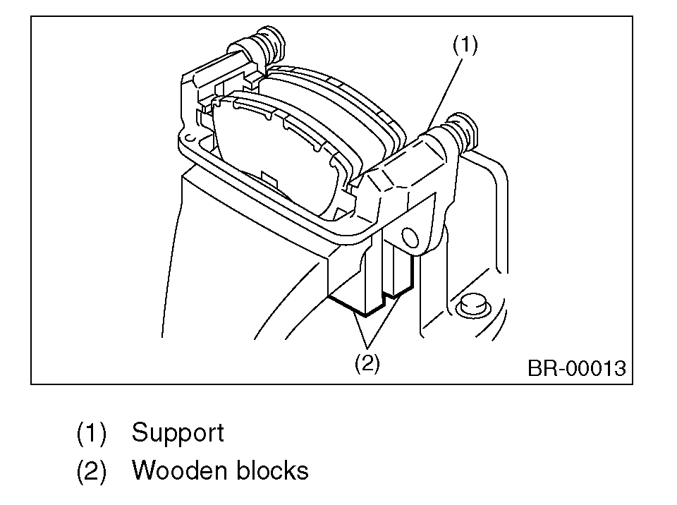

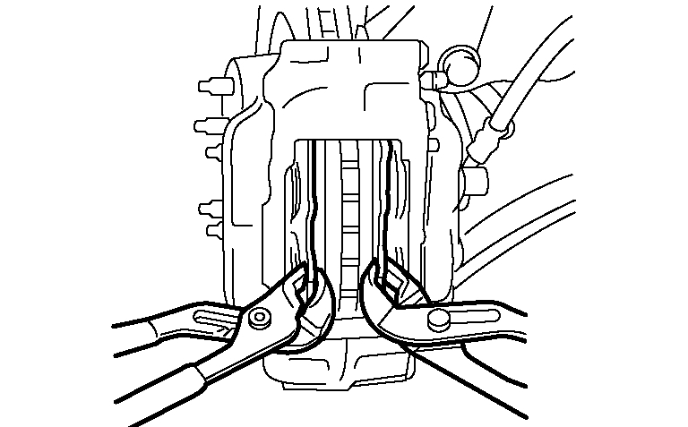

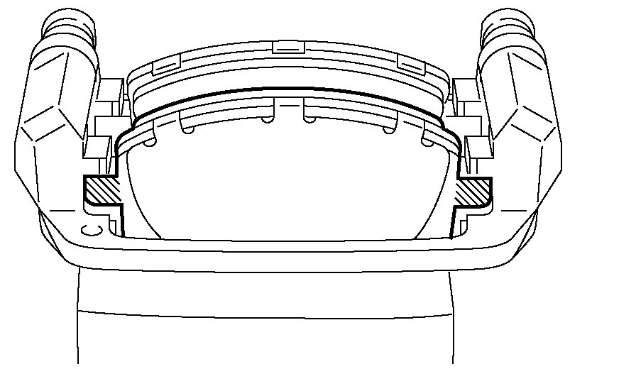

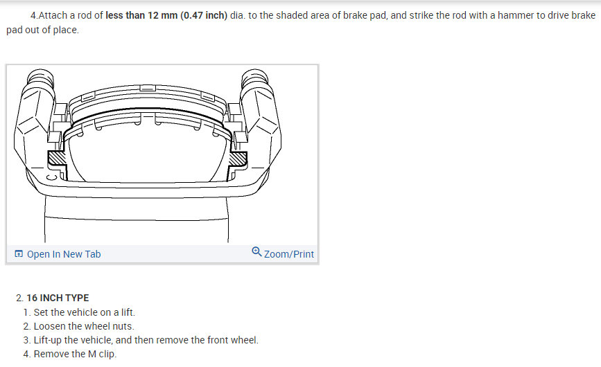

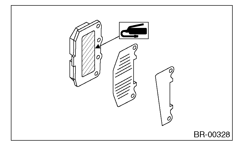

NOTE: If the brake pad is difficult to remove, proceed as follows:
1.Remove the caliper body from support.
2.Remove the support.
3.Place a support in a vise between wooden blocks.
pic 2
4.Attach a rod of less than 12 mm (0.47 inch) dia. to the shaded area of brake pad, and strike the rod with a hammer to drive brake pad out of place.
pic 3

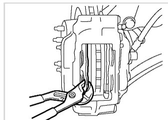

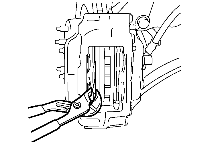

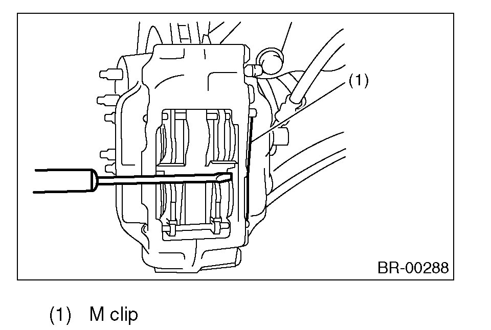

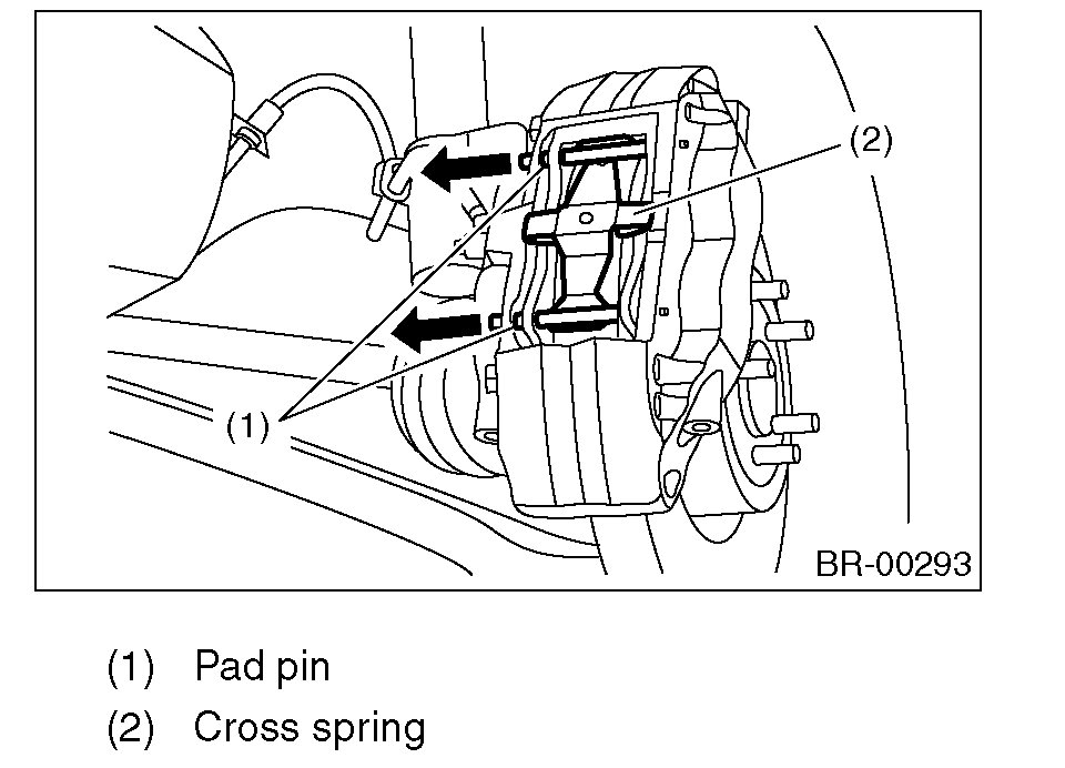

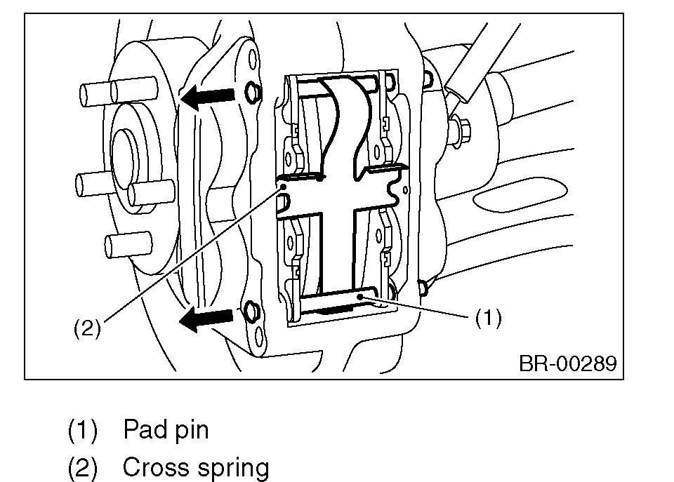

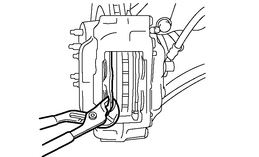

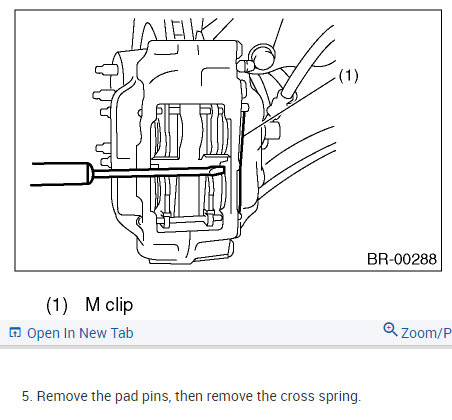

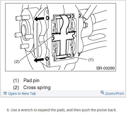

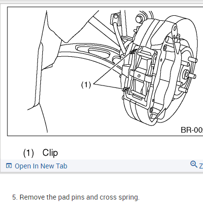

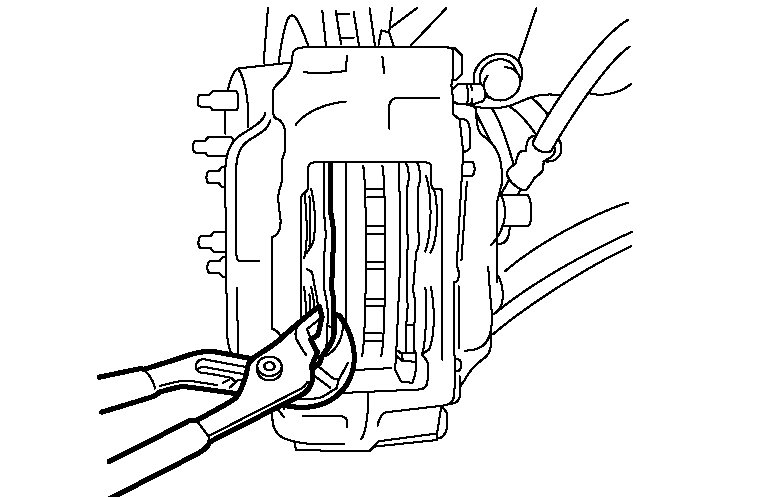

4. Remove the M clip.
pic 4

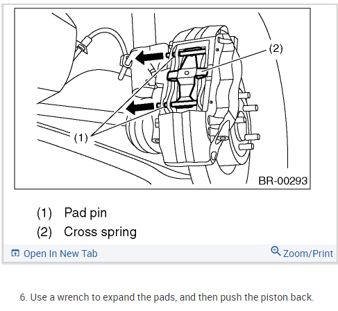

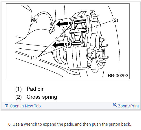

5. Remove the pad pins, then remove the cross spring.
pic 5

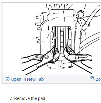

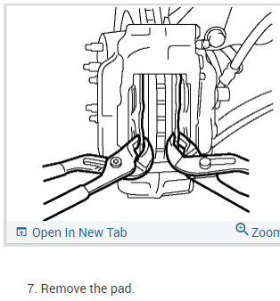

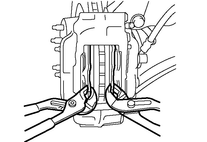

6. Use a wrench to expand the pads, and then push the piston back.
pic 6
7. Remove the pad.
pic 7

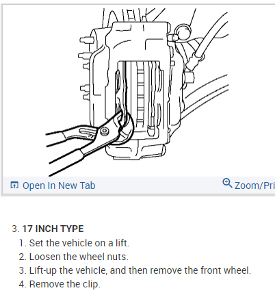

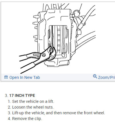

3. 17 INCH TYPE

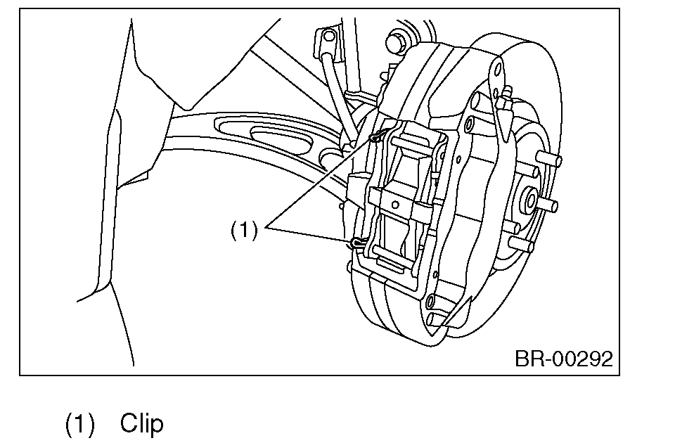

4. Remove the clip.

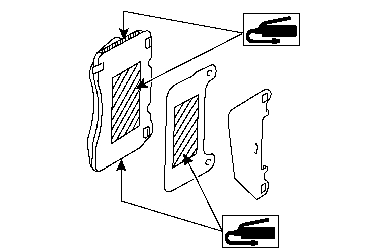

pic 8
5. Remove the pad pins and cross spring.
pic 9
pic 10
7. Remove the pad.
pic 11

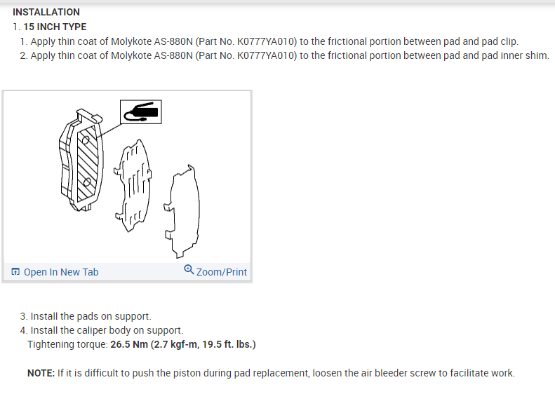

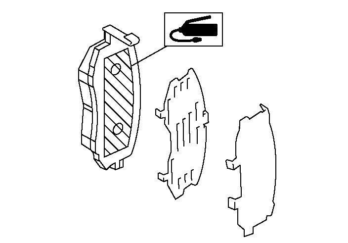

INSTALLATION
1. 15 INCH TYPE
1. Apply thin coat of Molykote AS-880N (Part No. K0777YA010) to the frictional portion between pad and pad clip.
2. Apply thin coat of Molykote AS-880N (Part No. K0777YA010) to the frictional portion between pad and pad inner shim.
pic 12
3. Install the pads on support.
4. Install the caliper body on support.
Tightening torque: 26.5 Nm (2.7 kgf-m, 19.5 ft. lbs.)
NOTE: If it is difficult to push the piston during pad replacement, loosen the air bleeder screw to facilitate work.

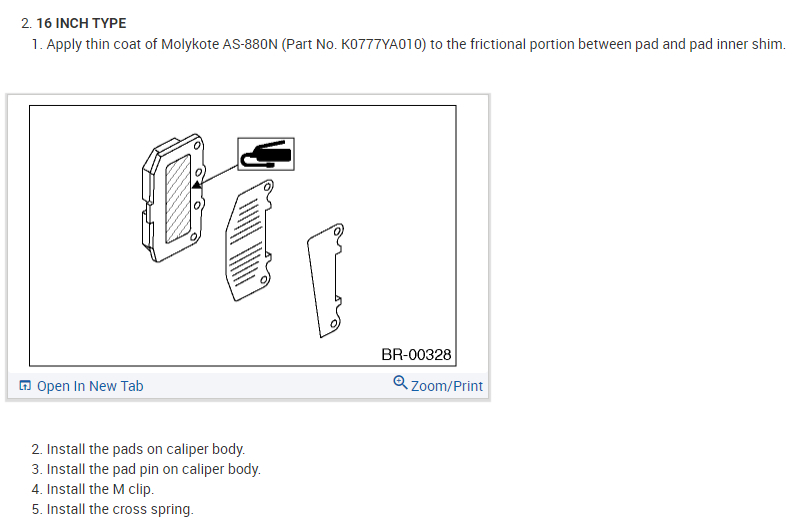

2. 16 INCH TYPE
1. Apply thin coat of Molykote AS-880N (Part No. K0777YA010) to the frictional portion between pad and pad inner shim.
pic 13
2. Install the pads on caliper body.
3. Install the pad pin on caliper body.
4. Install the M clip.
5. Install the cross spring.

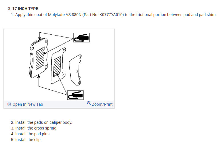

3. 17 INCH TYPE
1. Apply thin coat of Molykote AS-880N (Part No. K0777YA010) to the frictional portion between pad and pad shim.
pic 14
3. Install the cross spring.
4. Install the pad pins.
5. Install the clip.

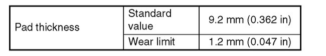

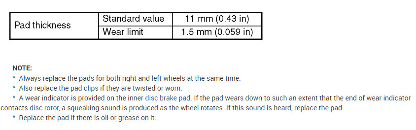

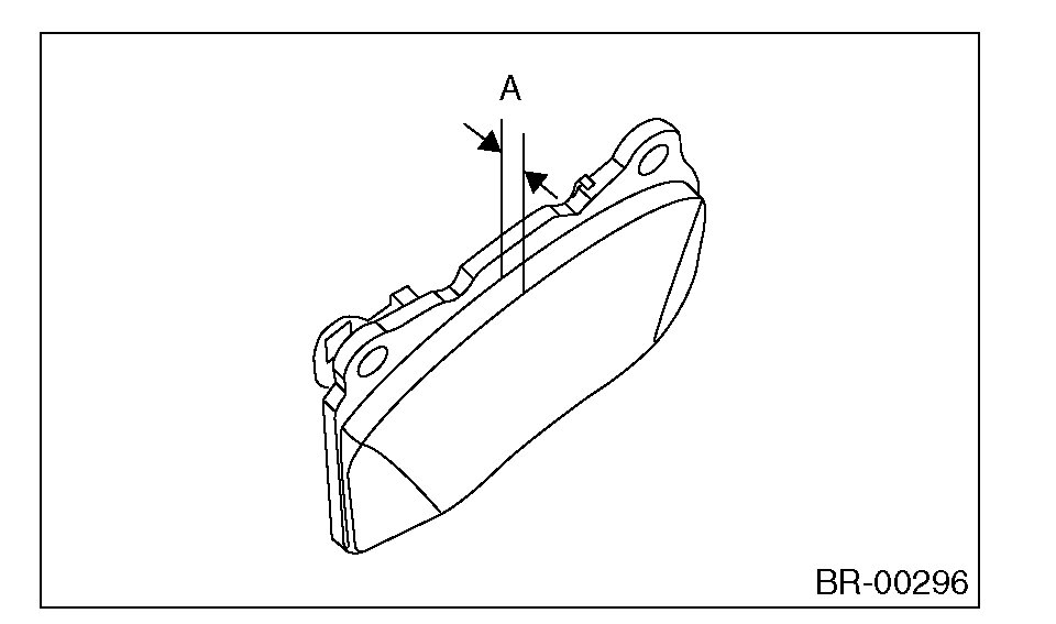

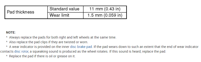

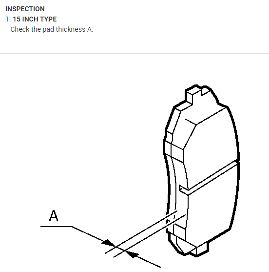

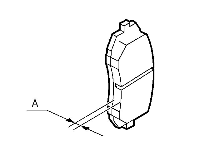

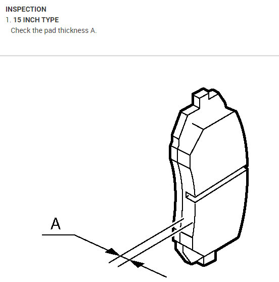

INSPECTION

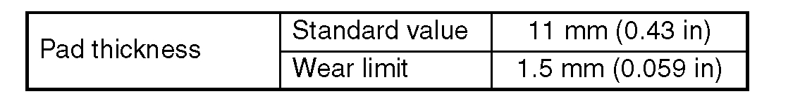

1. 15 INCH TYPE

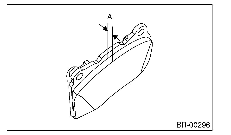

Check the pad thickness A.
pic 15
pic 16

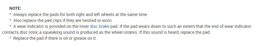

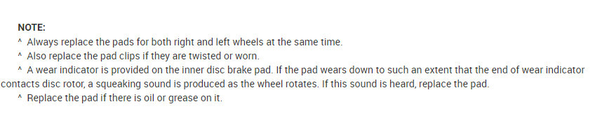

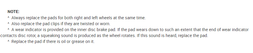

NOTE:
^ Always replace the pads for both right and left wheels at the same time.
^ Also replace the pad clips if they are twisted or worn.
^ A wear indicator is provided on the inner disc brake pad. If the pad wears down to such an extent that the end of wear indicator contacts disc rotor, a squeaking sound is produced as the wheel rotates. If this sound is heard, replace the pad.
^ Replace the pad if there is oil or grease on it.

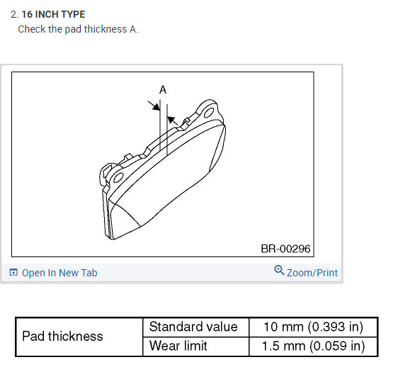

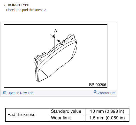

2. 16 INCH TYPE
pic 17
pic 18
NOTE:

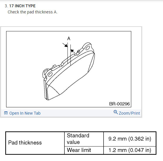

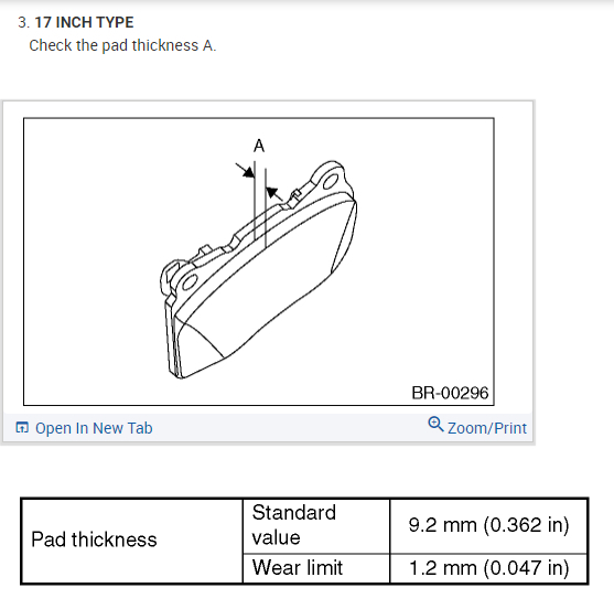

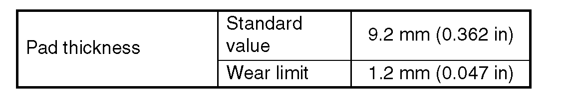

3. 17 INCH TYPE
pic 19
pic 20
NOTE:

Some cars will have a brake pad wear indicator that will trip the light when the pads are considered below specification. Also, If the brake pads are worn excessively the brake fluid in the brake master cylinder will be low and trip the light as well. Here is a tutorial for you to view on how to change front brake pads and rotors:
I've attached picture steps below on how to change the front brake pads and rotors on your Subaru WRX STI. Hope this helps and thanks for using 2CarPros.
