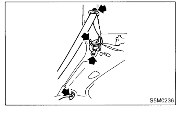

When this happens you need to replace the seat belt unit itself because even if you get it undone it will probably do it again.
Here are some diagrams of what you need to do to replace the belt.
Cheers
