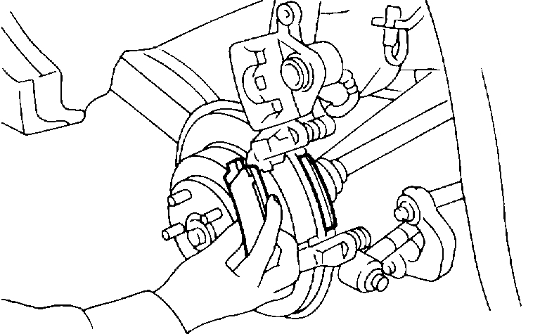

1. Loosen wheel nuts, jack-up vehicle, support it with safety stands, and remove wheel.
pic 1
2. Remove the bolt on the bottom.
3. Raise caliper body and suspend it securely.
NOTE: Do not disconnect the brake hose from the caliper body.
pic 2
4. Remove pad from support.
NOTE: If brake pad is difficult to remove, use the same procedure as for front disc brake pad.

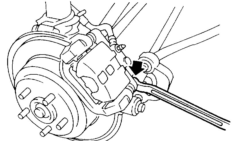

2. Loosen wheel nuts, jack-up vehicle, support it with safety stands, and remove wheel.
pic 3

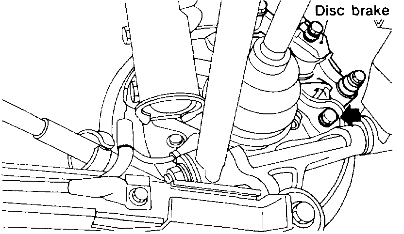

3. Remove the two mounting bolts and remove the disc brake assembly.
4. Suspend the disc brake assembly so that the hose is not stretched.
5. Pull down and release parking brake.
6. Remove the disc rotor.

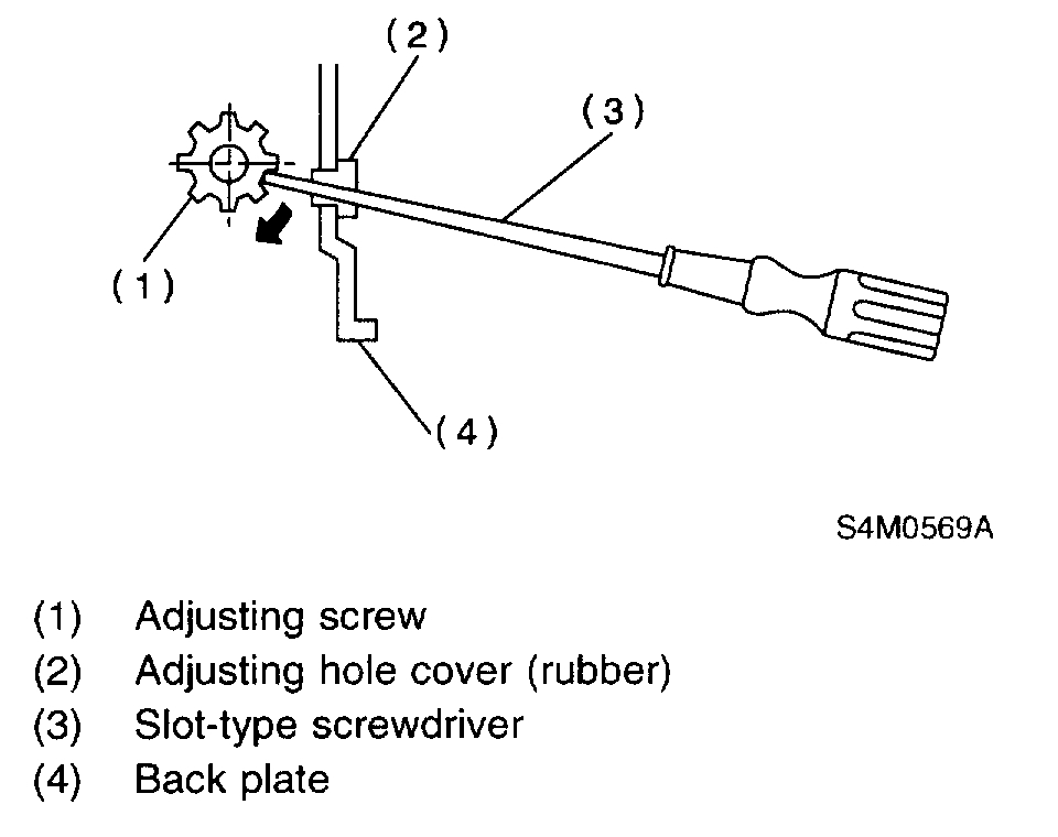

NOTE: If the disc rotor is difficult to remove try the following two methods in order.
pic 4
1. Turn adjusting screw using a slot-type screwdriver until brake shoe gets away enough from the disc rotor.

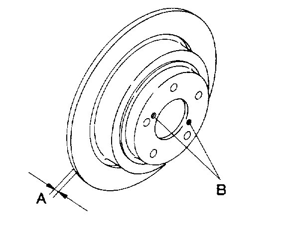

pic 5
2. If disc rotor seizes up within hub, drive disc rotor out by installing an 8-mm bolt in holes B on the rotor.
