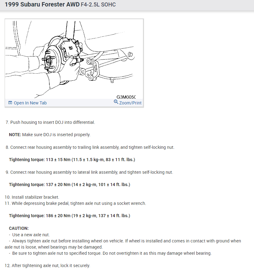

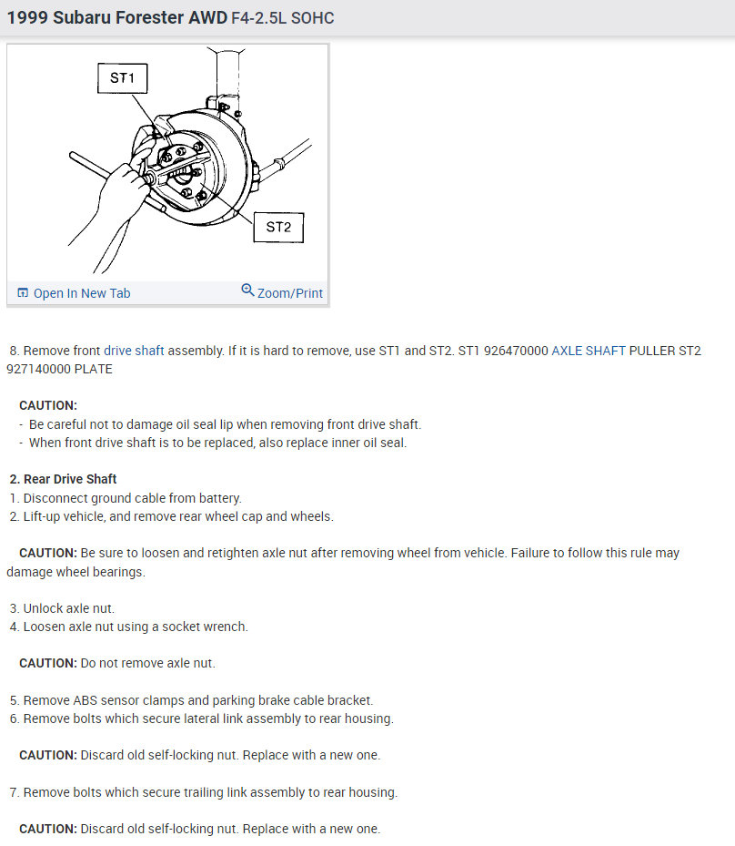

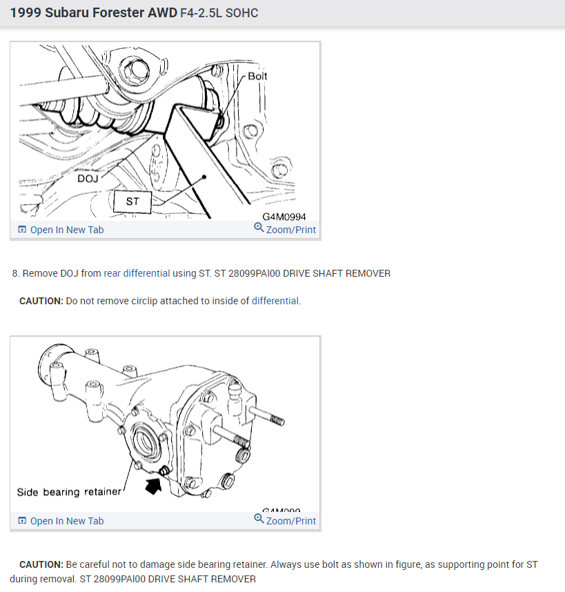

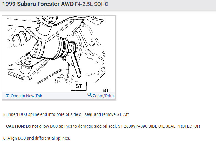

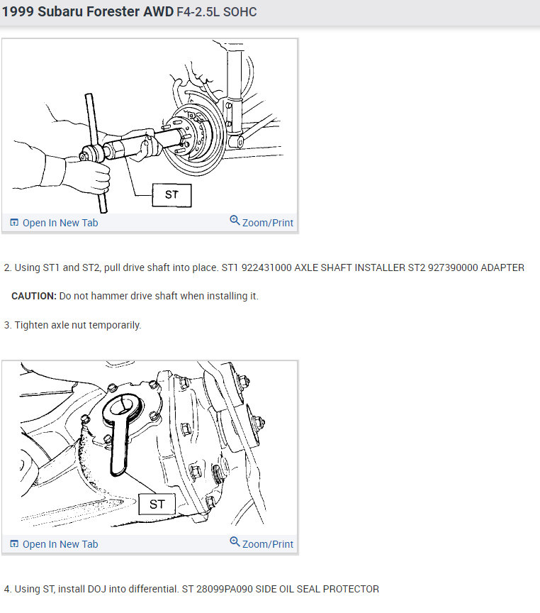

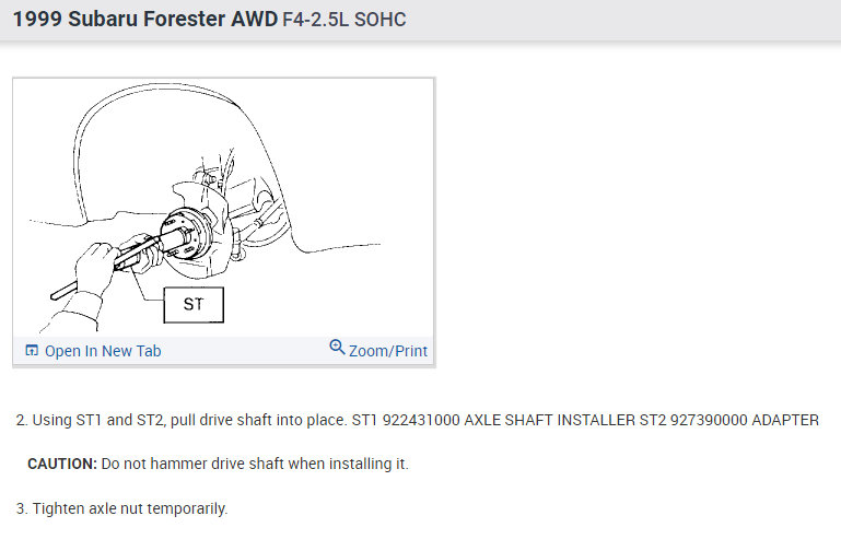

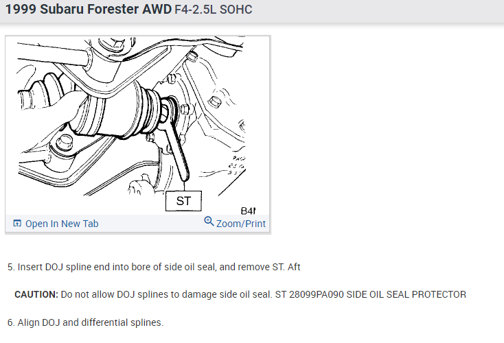

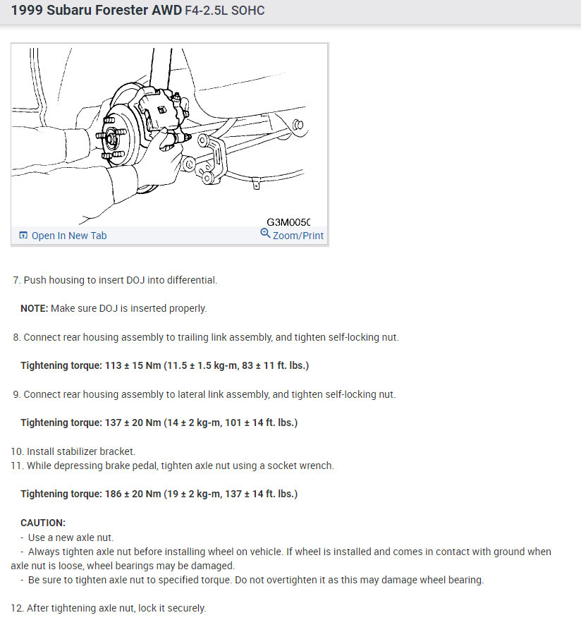

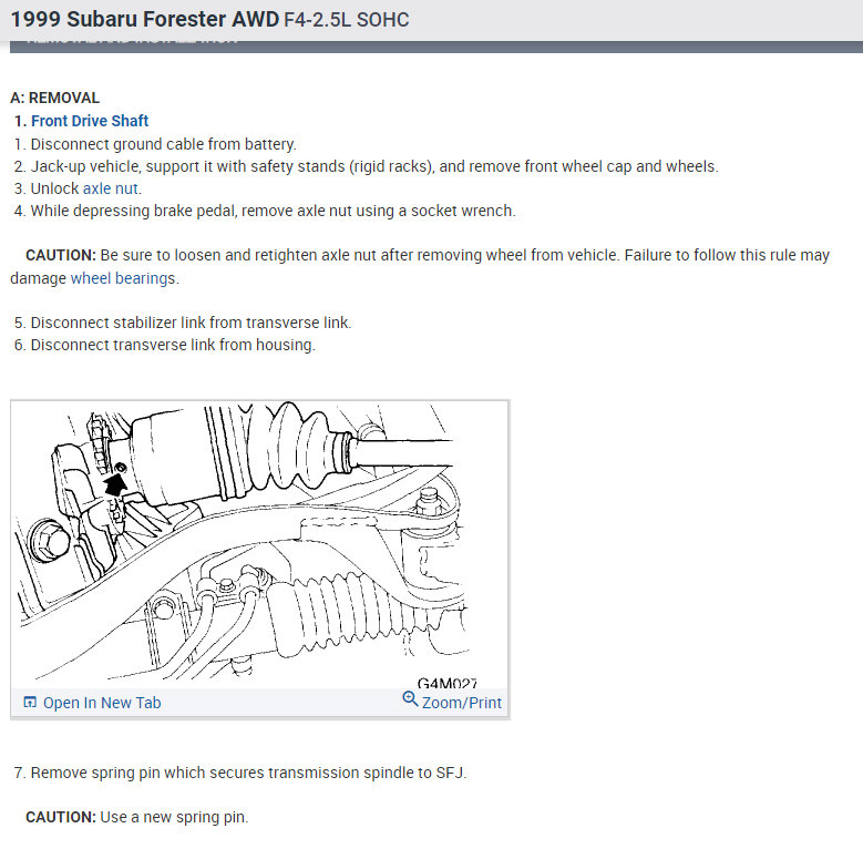

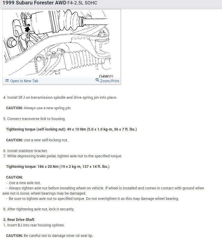

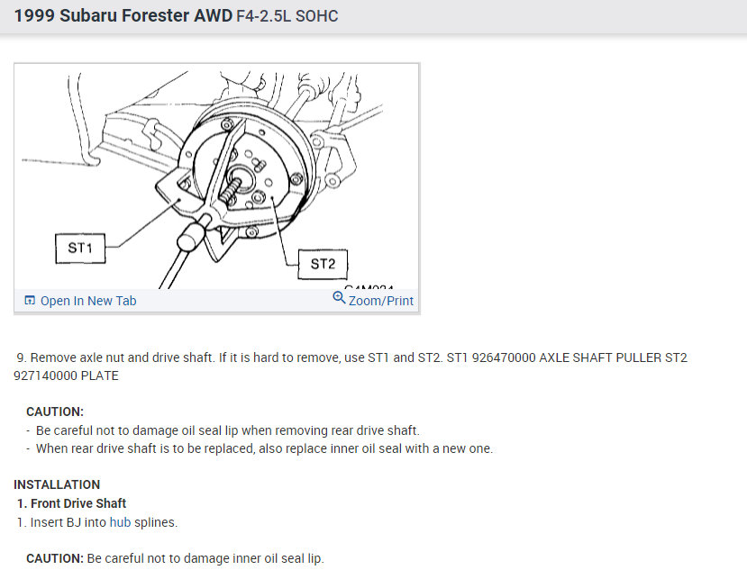

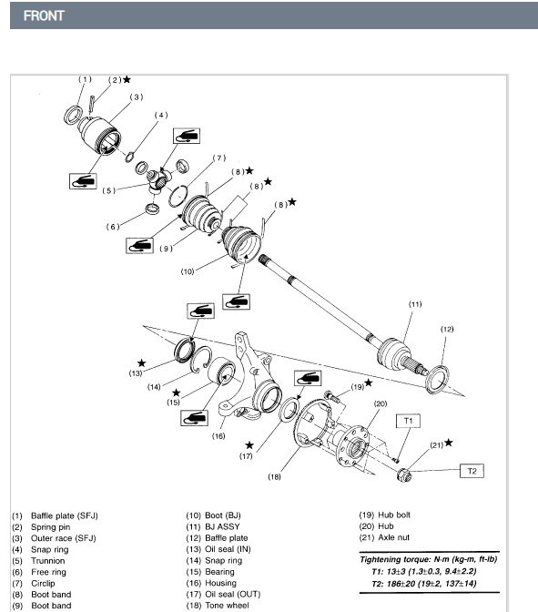

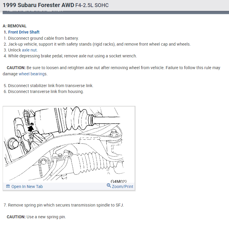

I have attached the replacement procedure of the CV axles for your vehicle.
