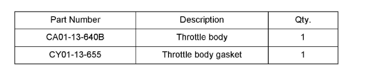

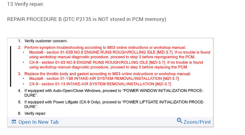

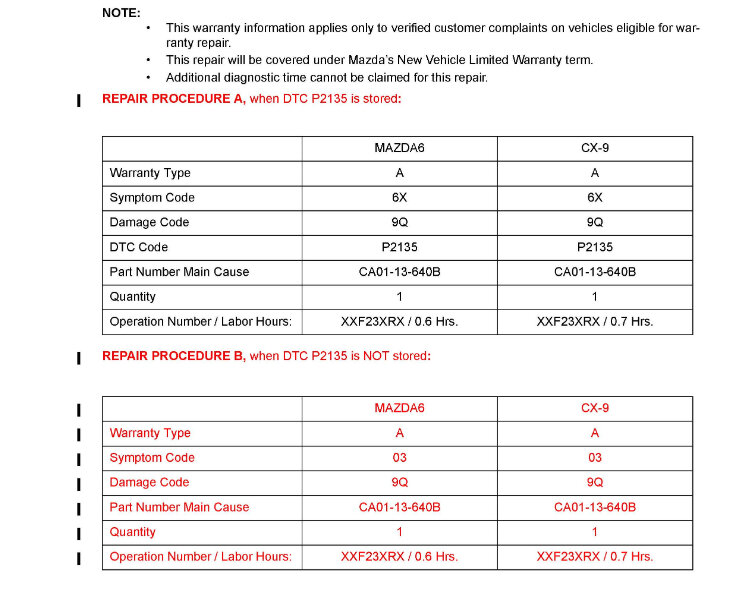

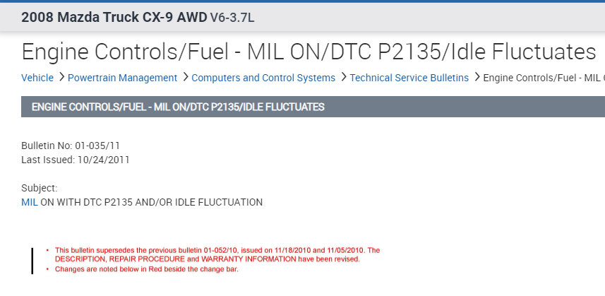

Car has no codes or check engine lights. The RPM goes up and down when stopped from 500-1000 and eventually engine stops. Now while driving on highway, it has a stutter. I cleaned the throttle body and MAS sensor. Nothing helped. Today the stutter got really bad
