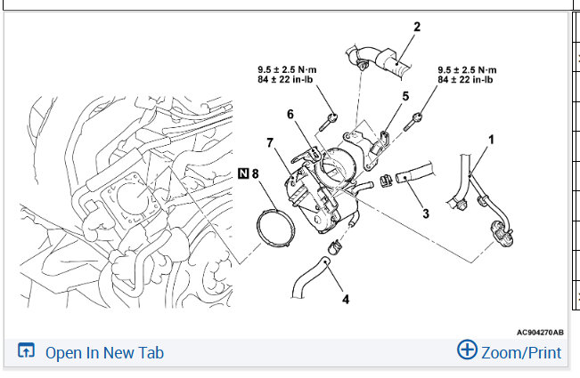

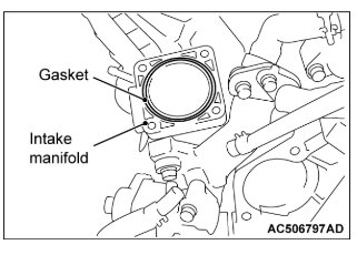

Yep, when the engine is under load it will misfire because this is when the ignition system is under stress. I would do a full tune up with spark plugs and ignition coils with are a common failure, also I would service the throttle bore, here are two guides to help walk you through the repair and instructions for your car in the images below.
https://www.2carpros.com/articles/how-to-tune-up-a-car-engine
and
2.0L 4-cylinder (4B11) NGK ILKR7E6 (Iridium) 0.039 - 0.043 in (1.0 - 1.1 mm)
2.4L 4-cylinder (4B12) NGK ILKR7B8 (Iridium) 0.039 - 0.043 in (1.0 - 1.1 mm)
Check out the images (below). Please upload pictures or videos in your response of any problems so we can see what to help you with.

Sounds good, I would have them do the throttle bore service as well.
