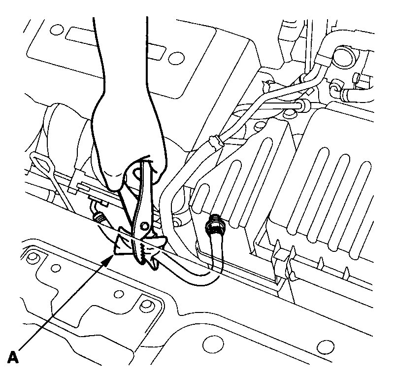

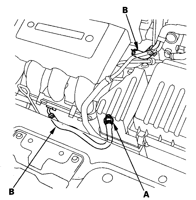

PCV Valve Inspection
1. Check the PCV valve (A), hoses (B), and connections for leaks or restrictions.
pic 1
2. At idle, make sure there is a clicking sound from the PCV valve when the hose between the PCV valve and intake manifold is lightly pinched (A) with your fingers or pliers.
If there is no clicking sound, check the PCV valve washer for cracks or damage. If the washer is OK, replace the PCV valve and recheck.

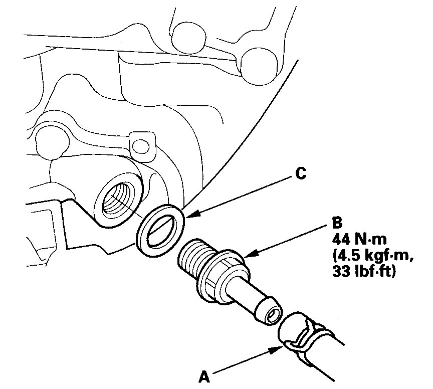

If you find there is a restriction and the hose is not kinked or plugged, here are the directions for replacing the PCV valve.
PCV Valve Replacement
1. Remove the intake manifold.
2. Disconnect the PCV hose (A).
pic 3
3. Remove the PCV valve (B).
4. Install the parts in the reverse order of removal with a new washer (C).
