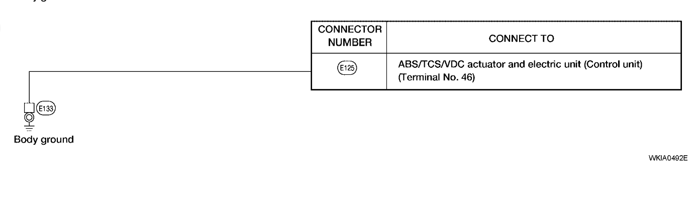

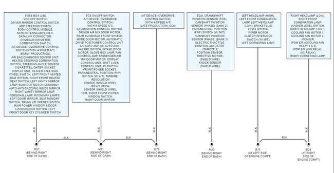

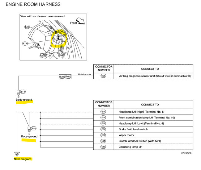

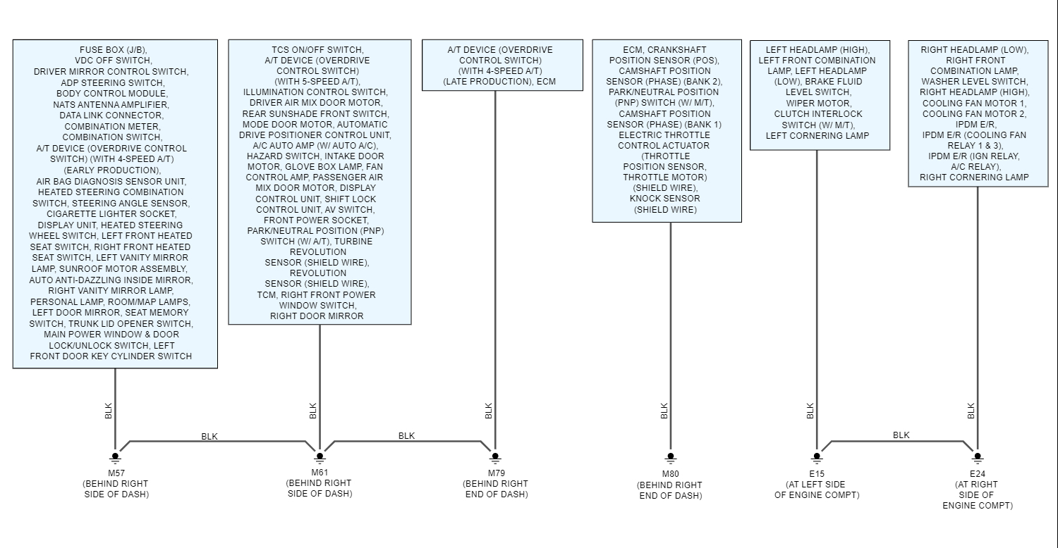

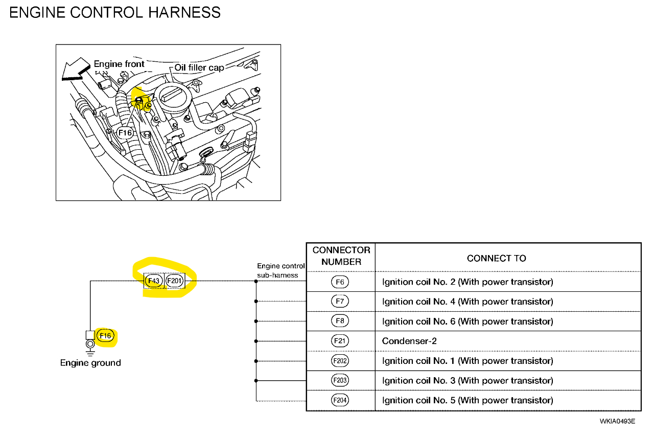

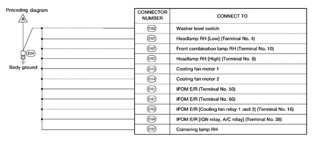

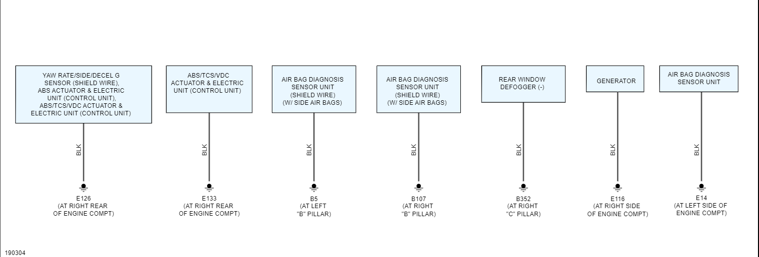

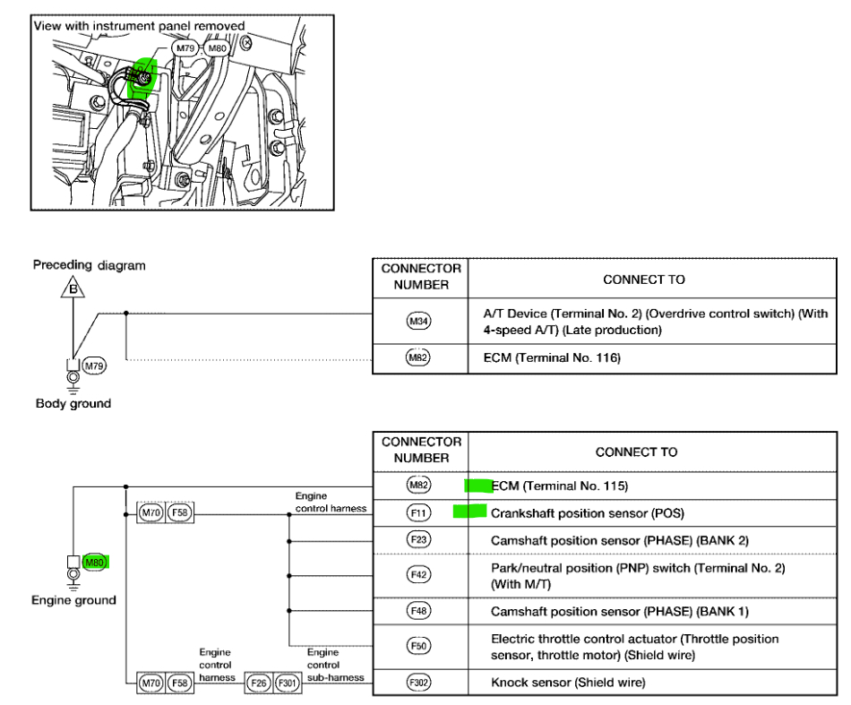

Here are all the Ground locations for the vehicle, it looks like there are 7 in the engine compartment. The engine computer grounds are on the passenger side at the end of the dashboard, most likely down by the foot area. There are 3 Ground connections there, but if you are missing a body ground like you described, then there might not be any connection between the engine computer and the battery negative.
All the ground wires are black solid color wires.

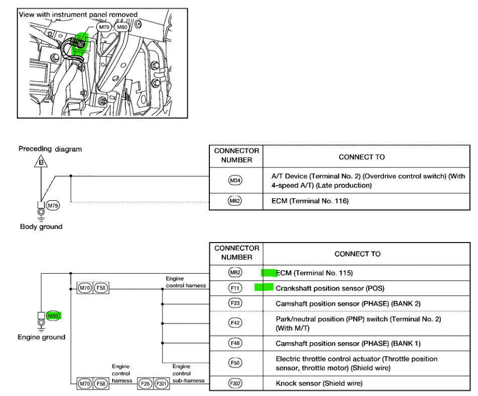

The Tachometer is not moving because there is no crankshaft position sensor signal. And the lack of a check engine light means the engine computer (ECM) is not powering up. Was the ground wire you found broken, was it rotted in half? If so there are probably more that are like that. You should go through and inspect all the Ground wires, If the location they bolt on to looks rusty or corroded, that's not a good ground connection. Do you have a 12v Test light or basic multimeter to check dc voltage? If the car just died like that, I think you're going to find other wiring issues. I would also check to see if you have an ignition spark, but I don't think you will. But you will need something to check for 12volt power at a few places, and I'll get the Ground locations to check as well.

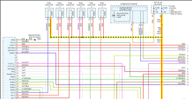

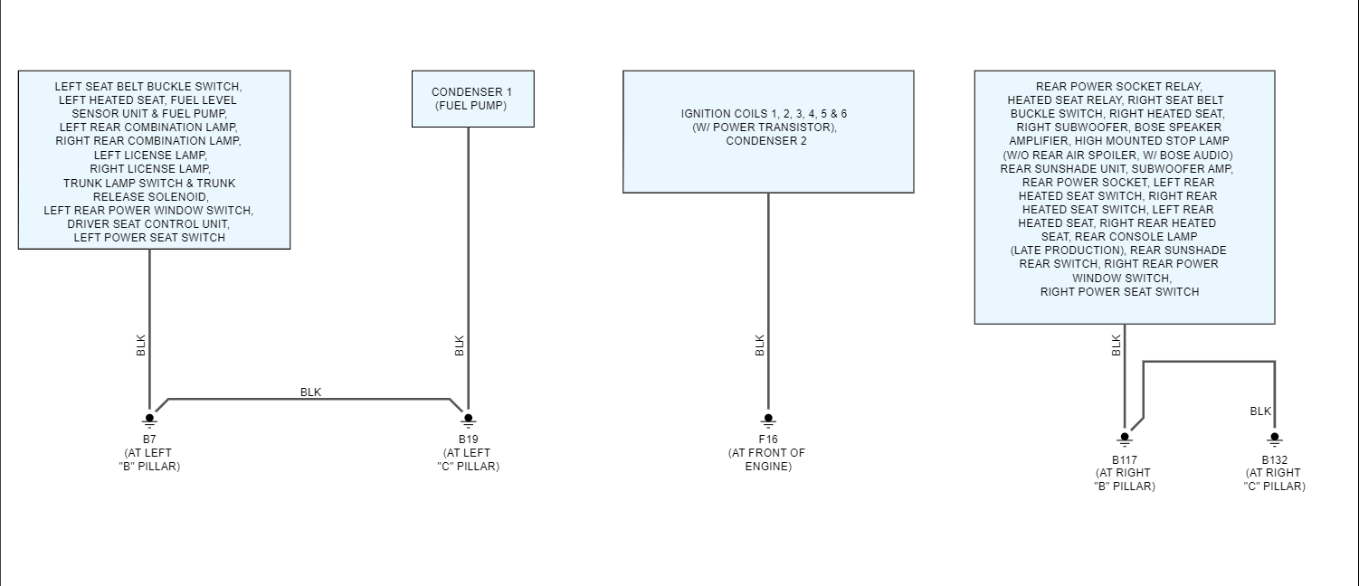

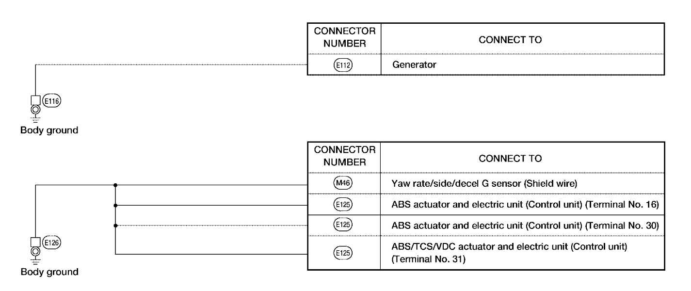

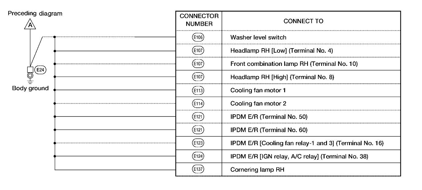

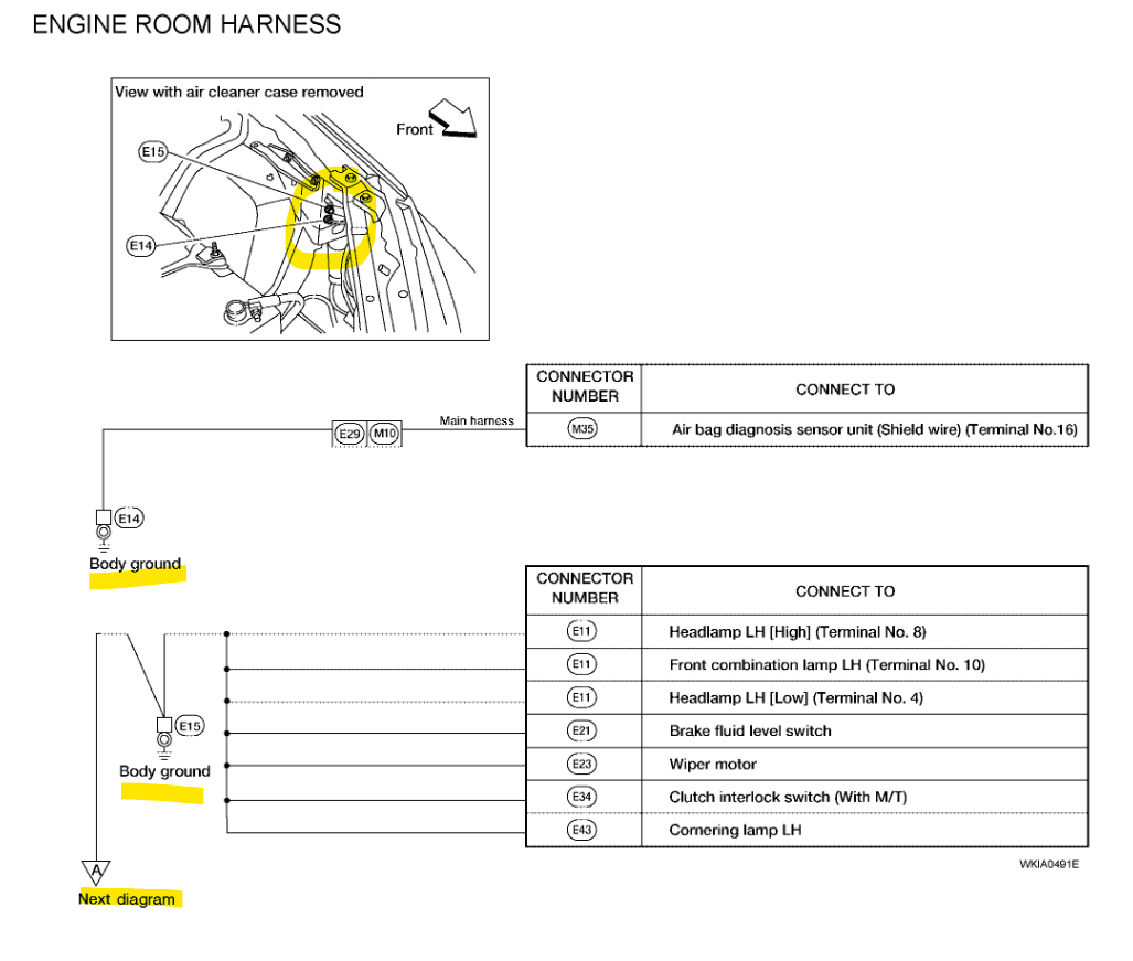

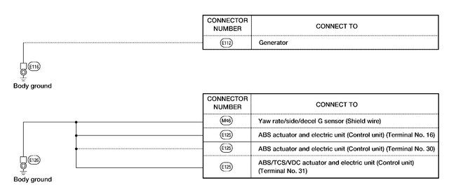

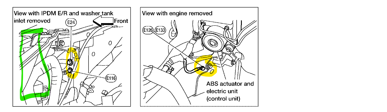

Here are all the Grounding locations in the engine compartment first, the third diagram with the green mark is just where the headlight would be, and the diagrams 4 5 and 6 go with the third. So, check those. And once those are checked and okay, we can check for some power at a few places and make sure the main power module didn't fail or something else happens when you lost that ground. Hopefully there isn't anything major.
What ground did you find broken? I have a list of them here, I'm just curious. I want to see what it goes to.

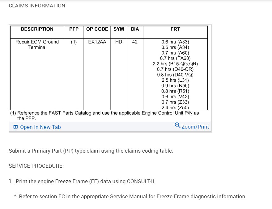

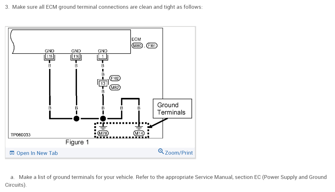

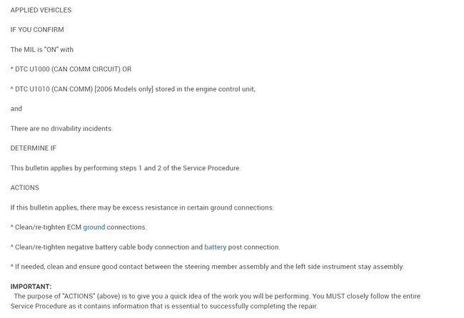

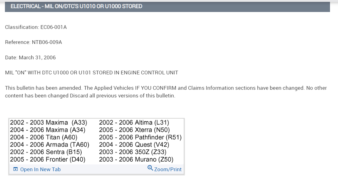

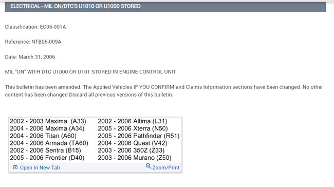

Diagram 7 is a Ground location for the computer that is behind the Instrument Cluster, so you may have to look up under the dash on the driver side to see those grounds. Donta remove the cluster though. And I did find a Technical Service Bulletin on the ECM grounds, and it needs to be repaired. The TSB is for U1000 and U101 codes which are communication codes, but you won't have any codes if the computer is not powering up for whatever reason here. Diagrams 8 to 11 are the TSB.

A fusible link? For a ground wire? This TSB is saying to clean and retighten all the grounds.
A test light will be good enough for now. With this bulletin, the grounds are the most concern. But we will need to check everything until we find the issue here. Check on the passenger side foot well for grounds, they might be behind the glovebox or the lower panel where your right foot would be. The engine computer is on that side too.

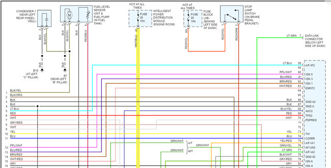

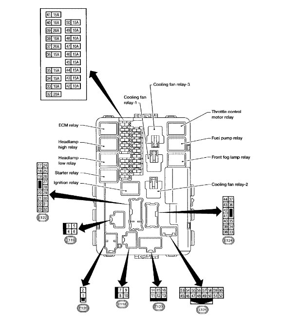

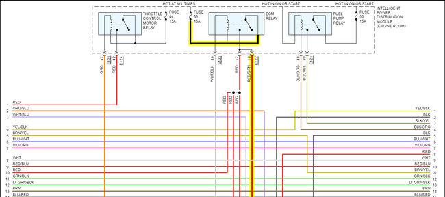

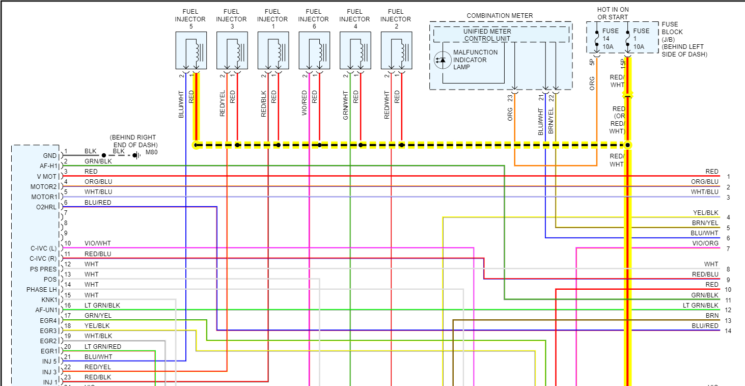

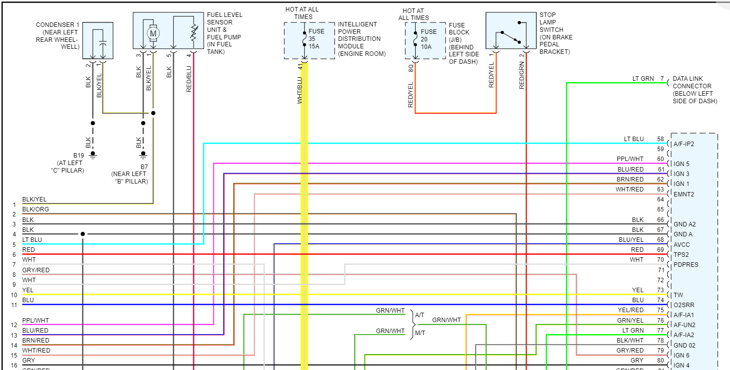

These are the ECM power locations, The Fuse panel on the driver's side dash, fuse number 1 10amp is powered up at Key On should be hot on both sides.

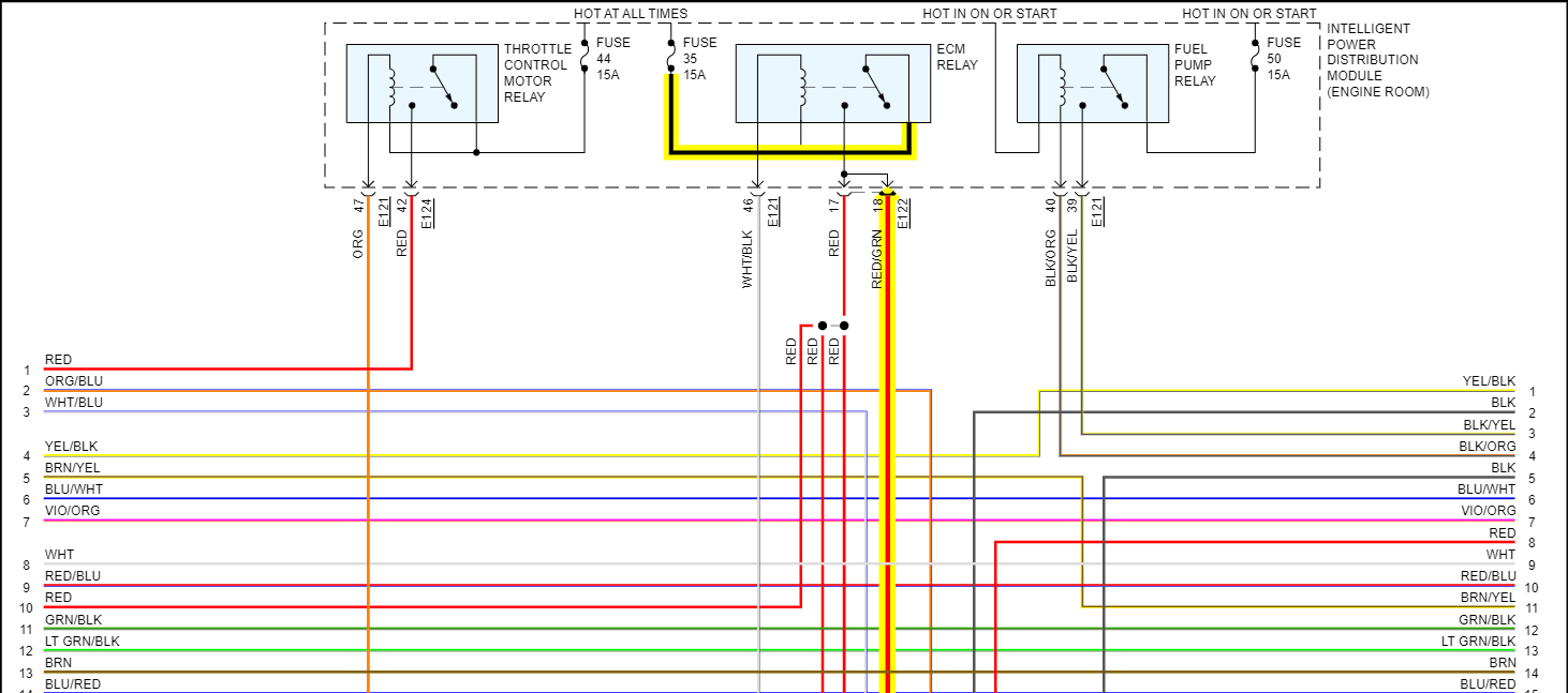

The second diagram is the ECM relay, if you pull the relay out, 2 out the of 4 pins should have power even with the key off. Fuse 35 in the Power Distribution module powers the ECM relay.
The 3rd diagram is the ECM memory fuse. It's fuse 35 also, hopefully these diagrams are correct,
