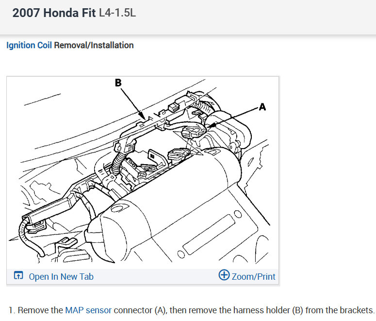

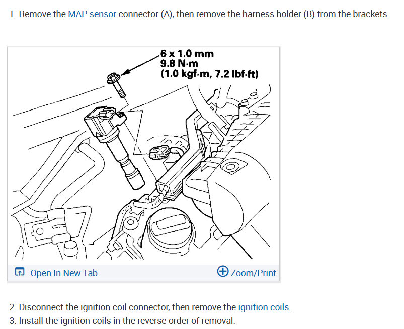

I would install new ignition coils as well, also a very common failure. Check out the images (below). Let us know how it goes.
